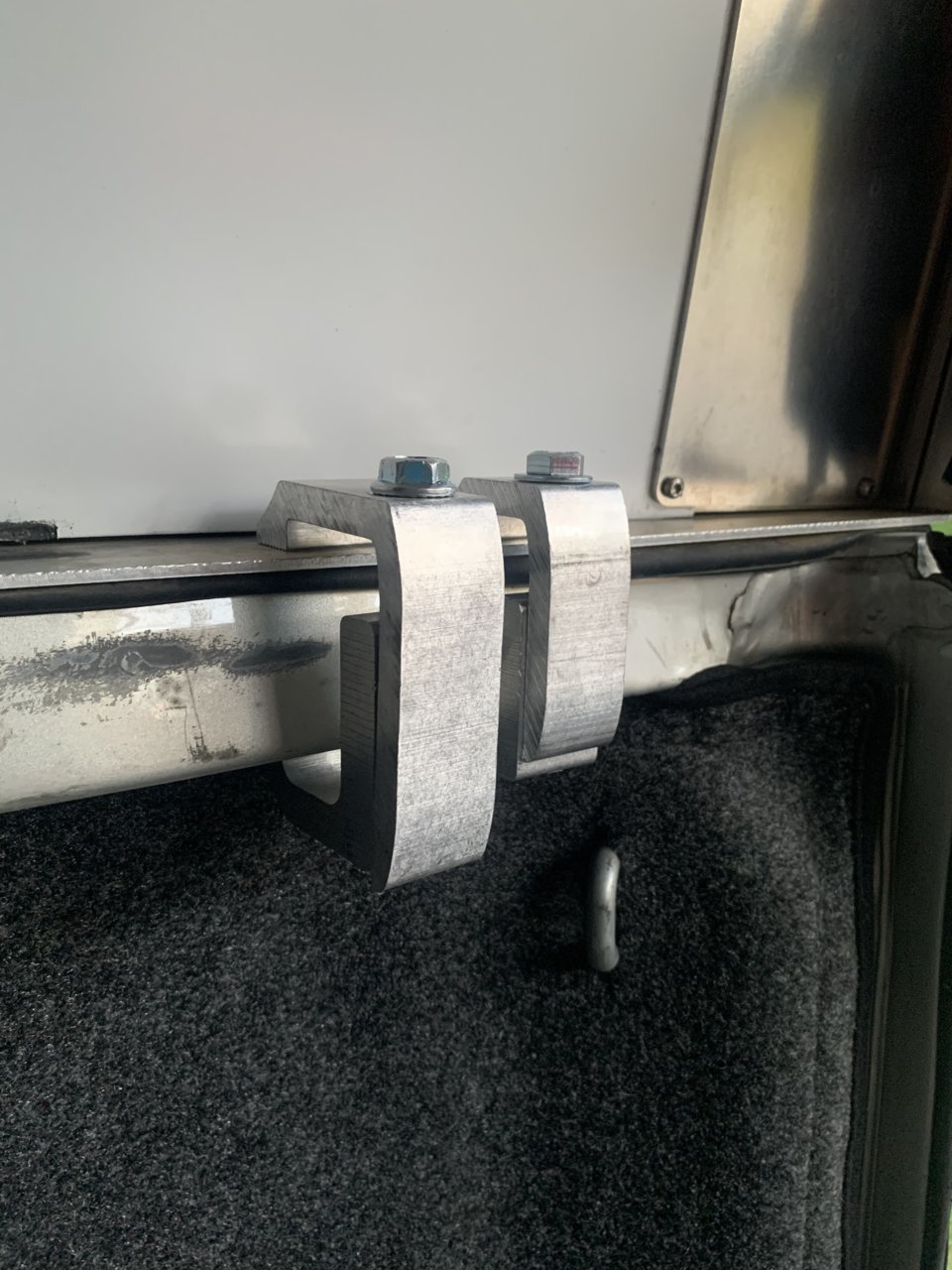

    No, and all the other non SP campers are like the Drifter as well to ensure transferability between the different bed shapes/sizes with the generations.
    Here's a photo of the Drifter on my 1st gen (which is now on my 2nd gen). The photo shows the flat, parallel to the ground aluminum lip that sits on top of the bed sides and is clamped down to the truck. Triple bulb seal between that is attached to the Drifter with adhesive.

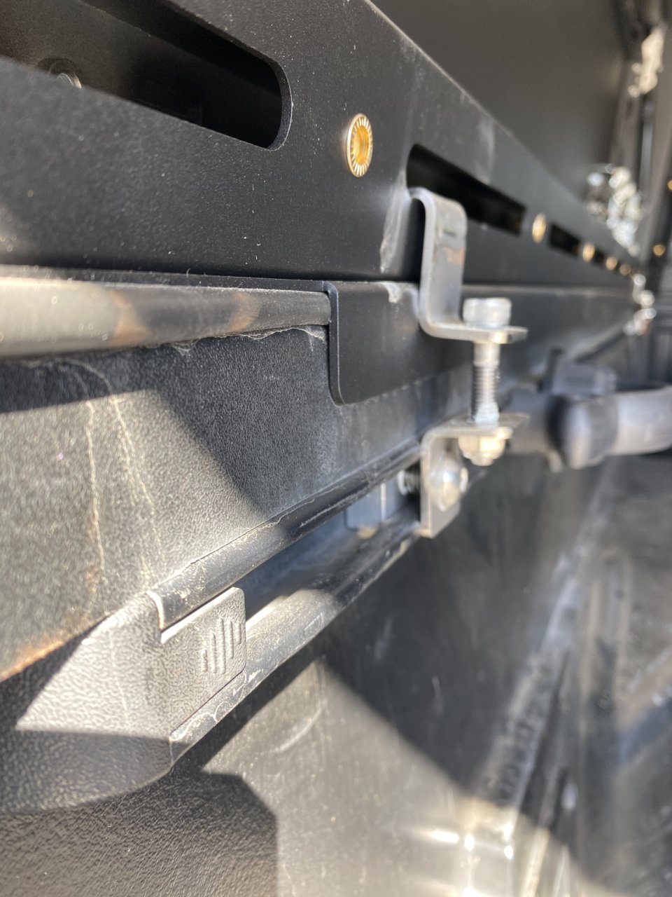

    The flange that extends down from the SP into the bed lines up almost to the face of the OEM bed track, at least on my 3rd Gen. Could be completely different on a 2nd Gen OEM rail, but I bet it’s closer to the same as mine. Does not seem that it can be put behind the rail, nor does that seem like it would be all that stronger than the c-clamps they give us anyway. Hope my photo shows what I’m talking about

    yup thats the issue, so i messaged Spencer he and i are talking seeing what my options are we might do a spacer out of aluminum for the camper for the X-1 to raise up the camper for that issue or he is looking a a couple ideas. Its interesting that all the other brands don't have that lip. But also how different the top parts of the 3gen vs 2gen are our rails are alot closer too the top of the bed rail almost flush minus the plastic bed rail caps. We will See if i can make it work @rjvincent1 ill let you know since we are in the same boat
