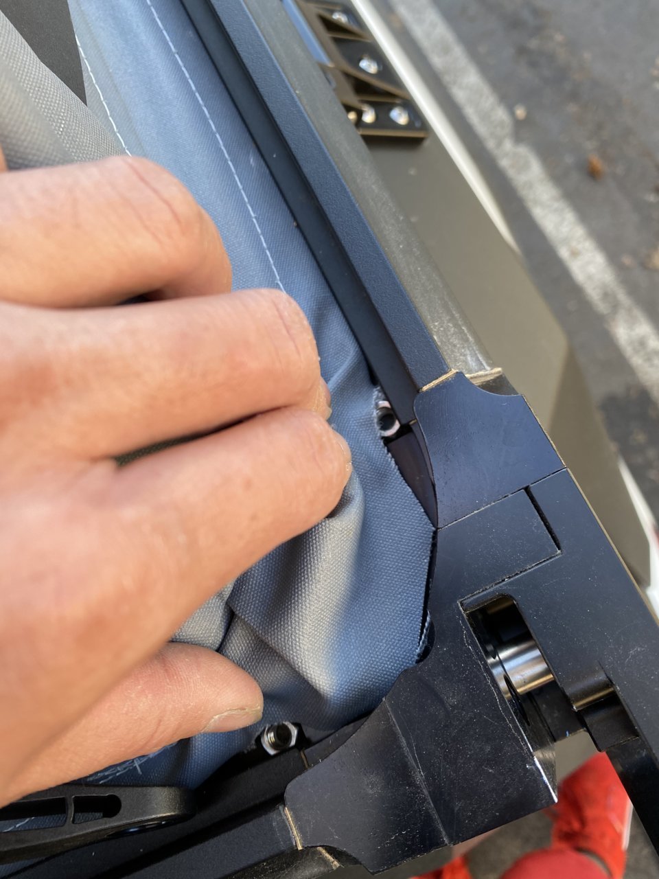

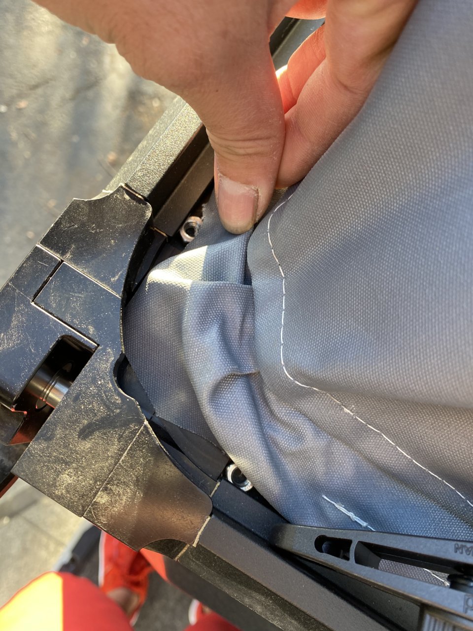

    Hmmm I wonder what is the corner bottom pieces of the tent that you’re missing looks like? I have a couple nuts on the rear corners of my tent when I have it opened up. I’m not sure if there is something that goes there or if it just looks like that lol!
    Edit: here’s pix of what I’m talking about.

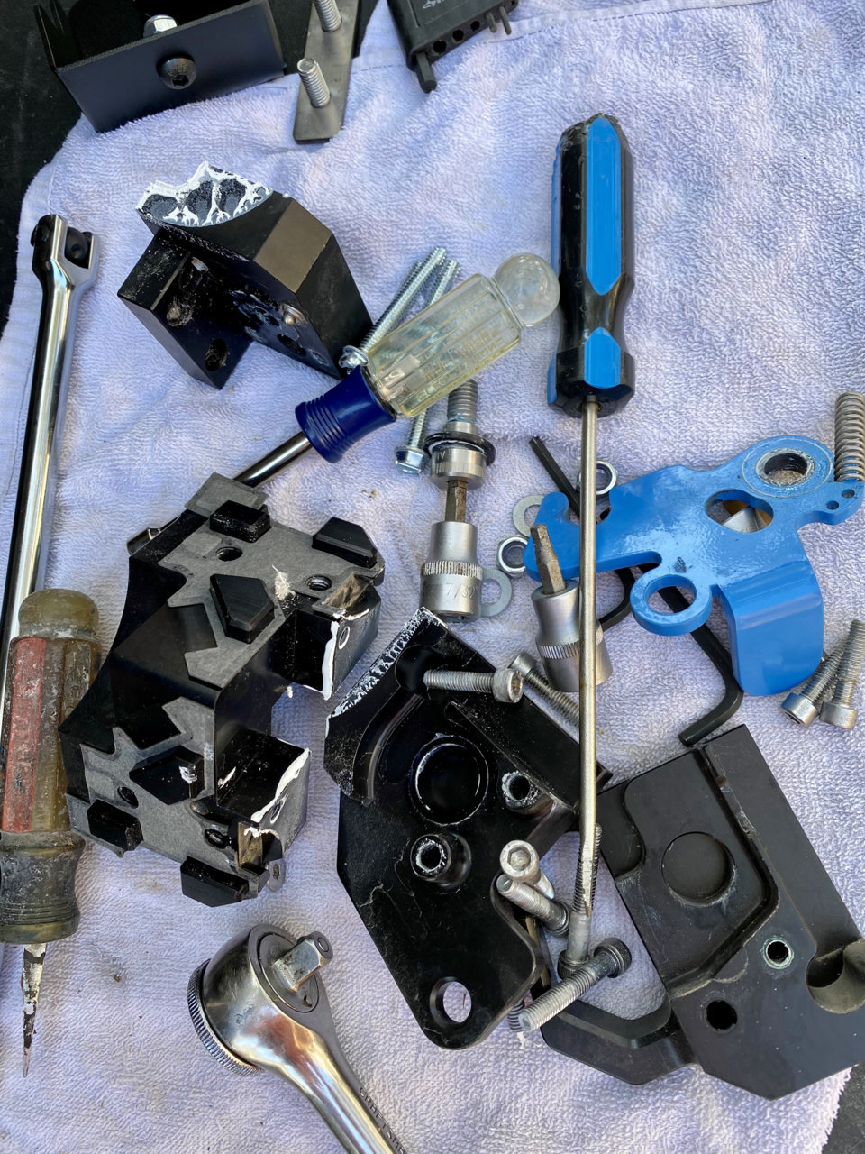

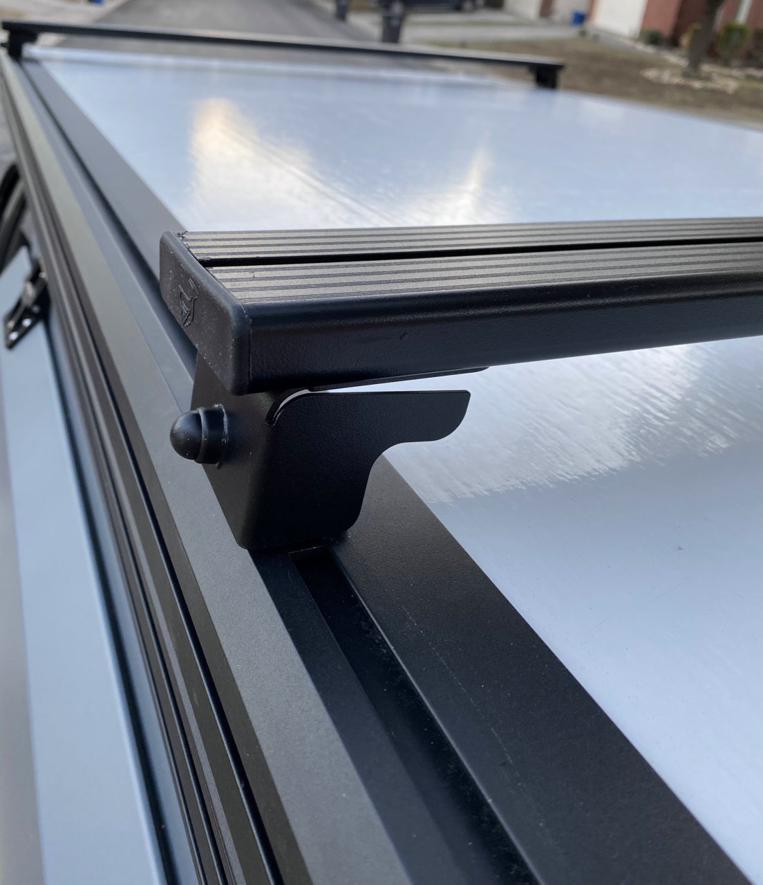

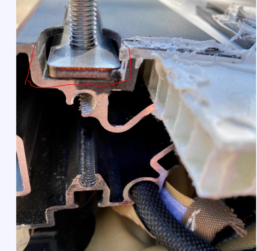

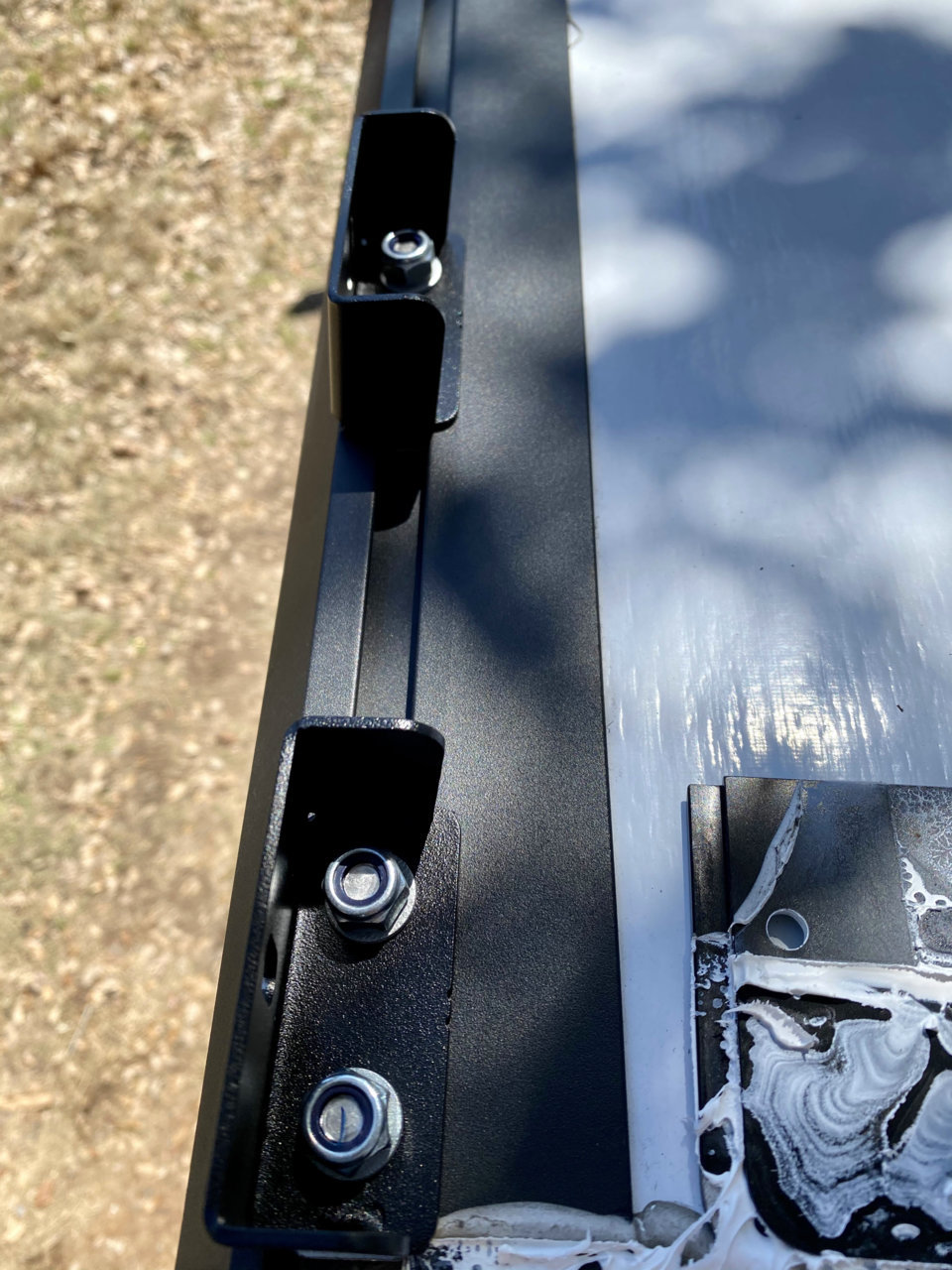

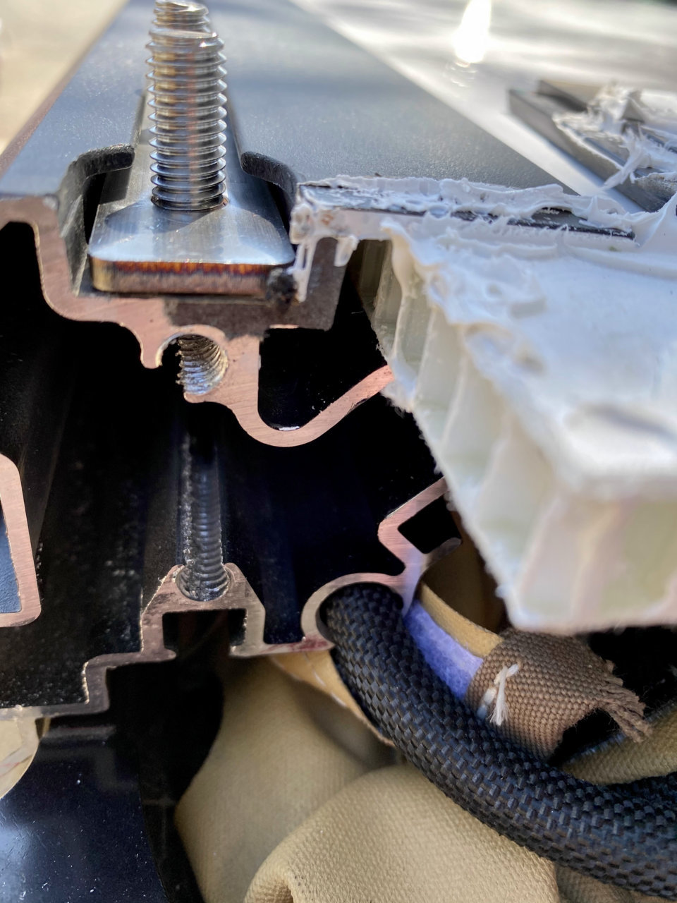

    This is the corner of the X1. I disassembled to attach the Front Runner rails. It was very interesting and I sealed everything again with no left over parts.

    Yeah that's where the missing pieces would go. Assume anyone who doesn't havea piece there will be getting them?
    Spencer said they originally didn't use gaskets at all. Some units mated and sealed perfectly while a few did not, so they started using a gasket. Then I think they switched to another type which I have. He said most of them are east to replace but a couple would be tricky due to how the panels attach.

    Rack is solid?
    Looks "Interesting"

    Was there not a way to install the mounts without disassembling the Corner of the SP?

    My guess is the foot that goes in the t slot is too long for the cut out in the rail. Cant drop it in the slot.

    Cut the foot in half.

    Hahaha yes something of that sort would work.

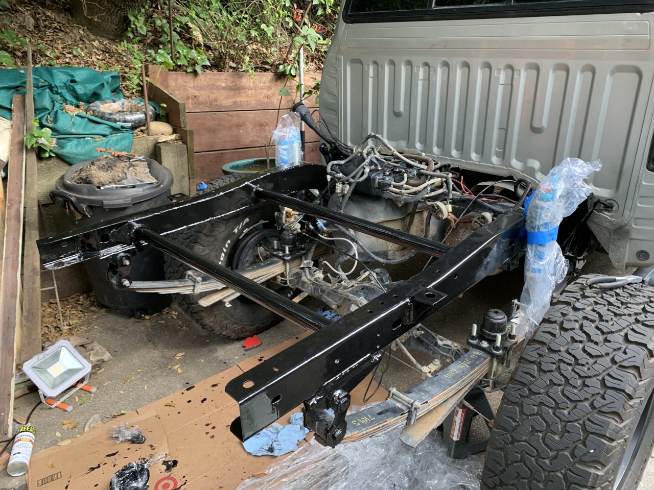

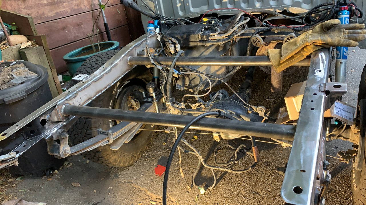

    “Put it in your fucking build page bro”.
    Don’t think I have one and I did this for her (SP). It’s done. BTW POR 15 finish is hard as glass. So far I’m impressed but we’ll see if it lasts.

    That is correct. The second side was easier to install since I knew how to disassemble and reassemble.
