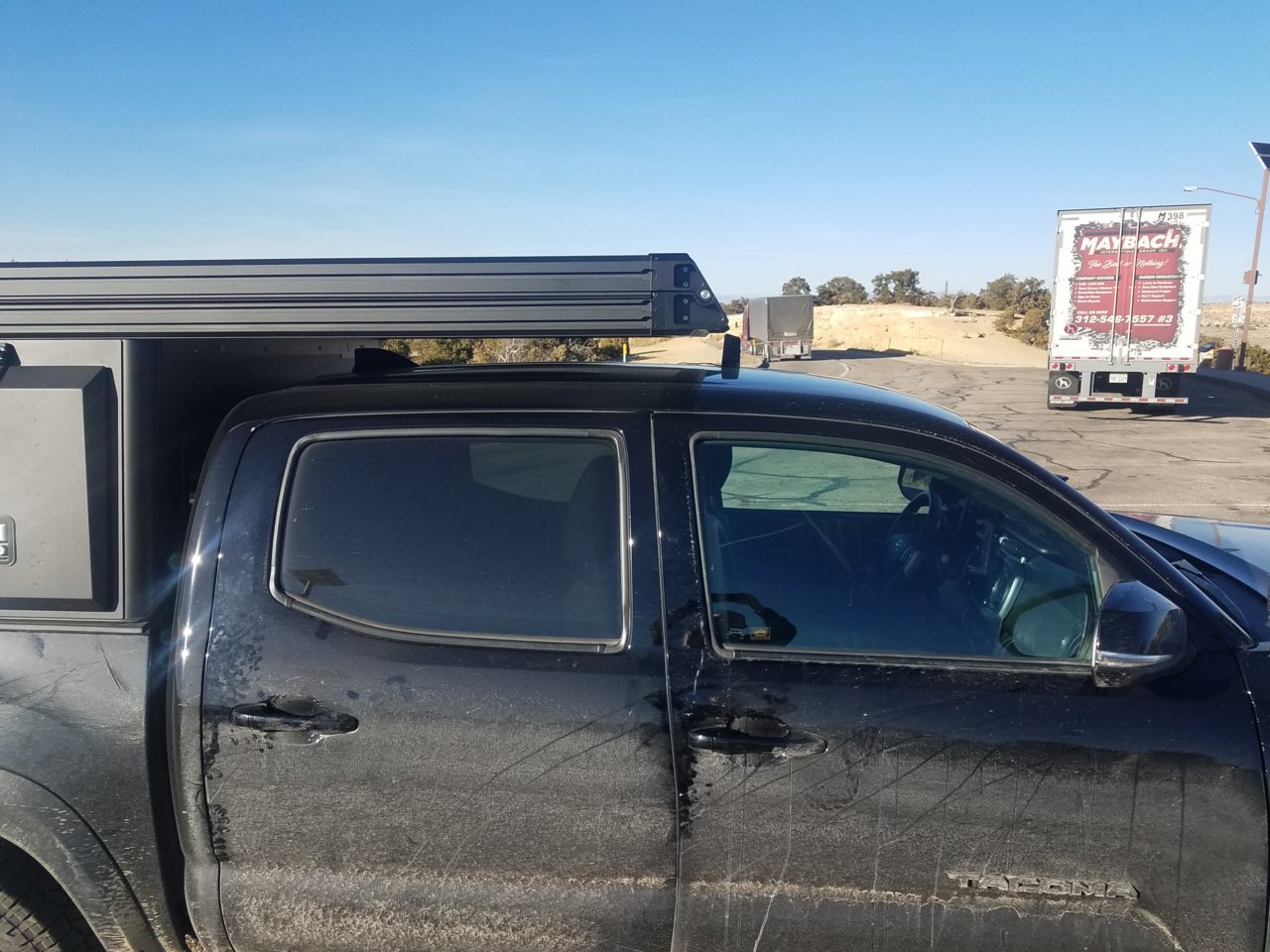

    Hey, man. Sorry so late to respond - still traveling. Let me know if this is the shot you're looking for.

    can’t put much there. That’s good gap

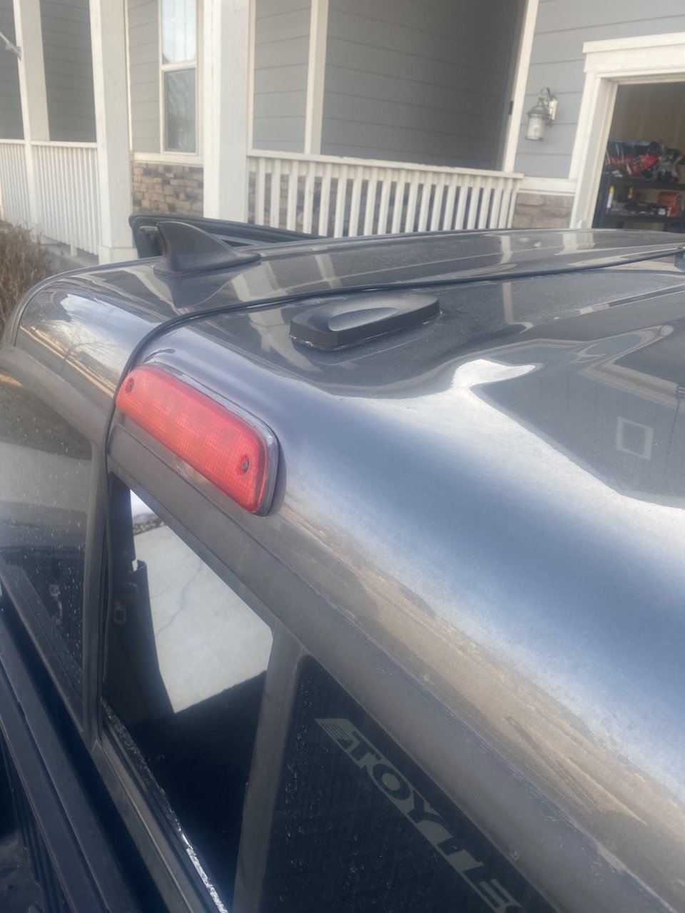

    Well got some warm weather finally in colorado swapped out my shark fin for an low profile bullet from TRP @Anderson 0698EF36-0C17-44A0-9C04-2EF414A9A303.jpg

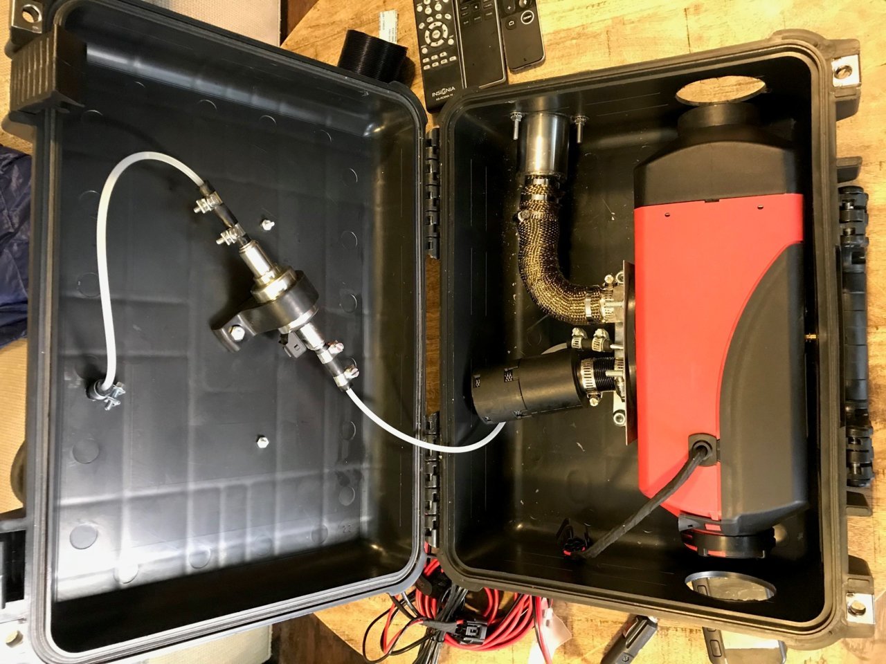

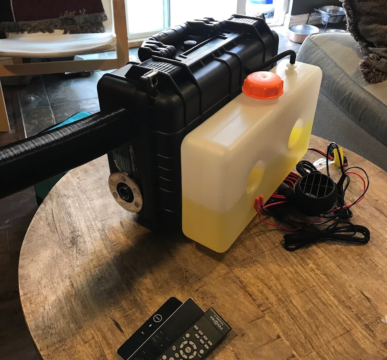

    Finally got around to "finishing" the diesel heater, there are a few small things i need to tie up with it but it runs and works so well. probably have about 4 hours running time on it so far. heater.jpg heater1.jpg

    Yes sir, perfect! With your 5' bed and mine being 5.5 on my Crewmax Tundra I'm thinking the front lip will be just behind the B-pillar and sunroof, which is exactly what I was hoping for.
    Safe travels dude!

    Lookin good man!

    Looks great and compact! Can I ask how long it took to put it all together and approximate cost? Did you follow the video from Revere overland on YouTube? Lastly does yours make that clicking sound that I have seen in other videos? That seems to be almost a killer for me personally!

    They’ll all make that noise. It’s a result of the positive displacement fuel pumps they all use. I have an Espar D2 that does the same, and so does my buddy’s Webasto.

    Looks great! Any heat issues with that exhaust port getting the plastic box that it's touching too hot? It looks like it's at least a bit air gapped between the metal that touches the plastic box and the part that actually touches exhaust fumes, at least. Do you plan on running this outside the canopy, or do you have a separate exhausting plan?

    nope no heating issues, i used a through hull exhaust port. I guess these are typically used in marine applications but it works great here, i also full sealed the exhaust and wrapped it in exhaust wrap. the box itself gets a little warm but no, no melting at all or anything like that. all in all total build price was probably around $230ish

    i mainly followed this guy on his build. however i did not add a fan and all that mumbo jumbo. i really dont find all the extra things he did necessary. with proper venting it runs just fine. and only draws .4amps while in low setting. it will push just over 10amps on start up and cool down because of the glow plug.this guy now offers all his 3D printed parts in the youtube link as well
    https://www.youtube.com/watch?v=HTywDTi6NTo
