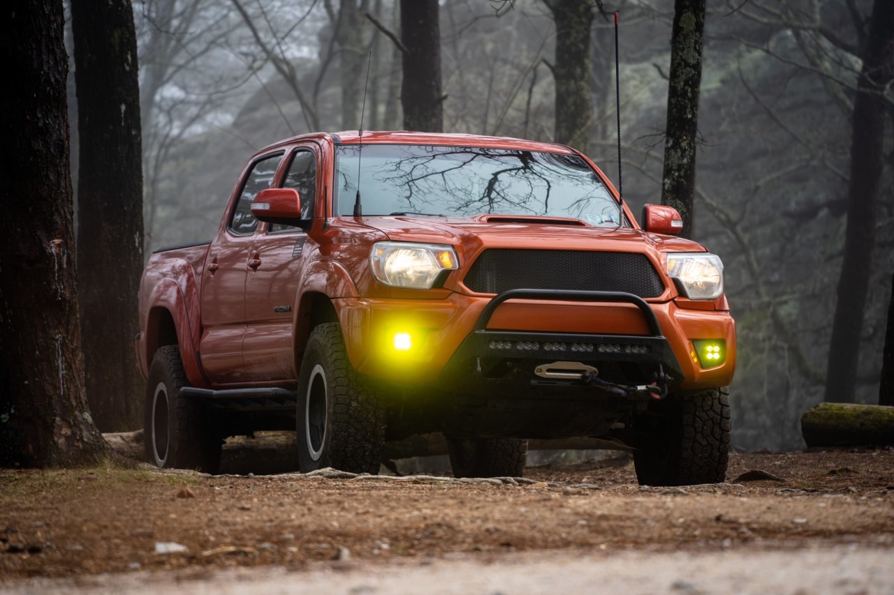

    Just dropping in to introduce myself. I was an early adopter of the GFC, but sold it late last year to buy a SP. we are leaving out in one week to go on a crazy 8000+ mile adventure from Tennessee to Oregon to get our new camper. Guaranteed to be plenty of pictures from our cross country adventure soon.
    I can’t wait to get back to Wedge style camper. After two years and well over two months of actual sleeping time in the GFC, switching back to a ground tent has not been the best. Granted our Gazelle tent is great, it’s just hard to be a 30 second set up time.
