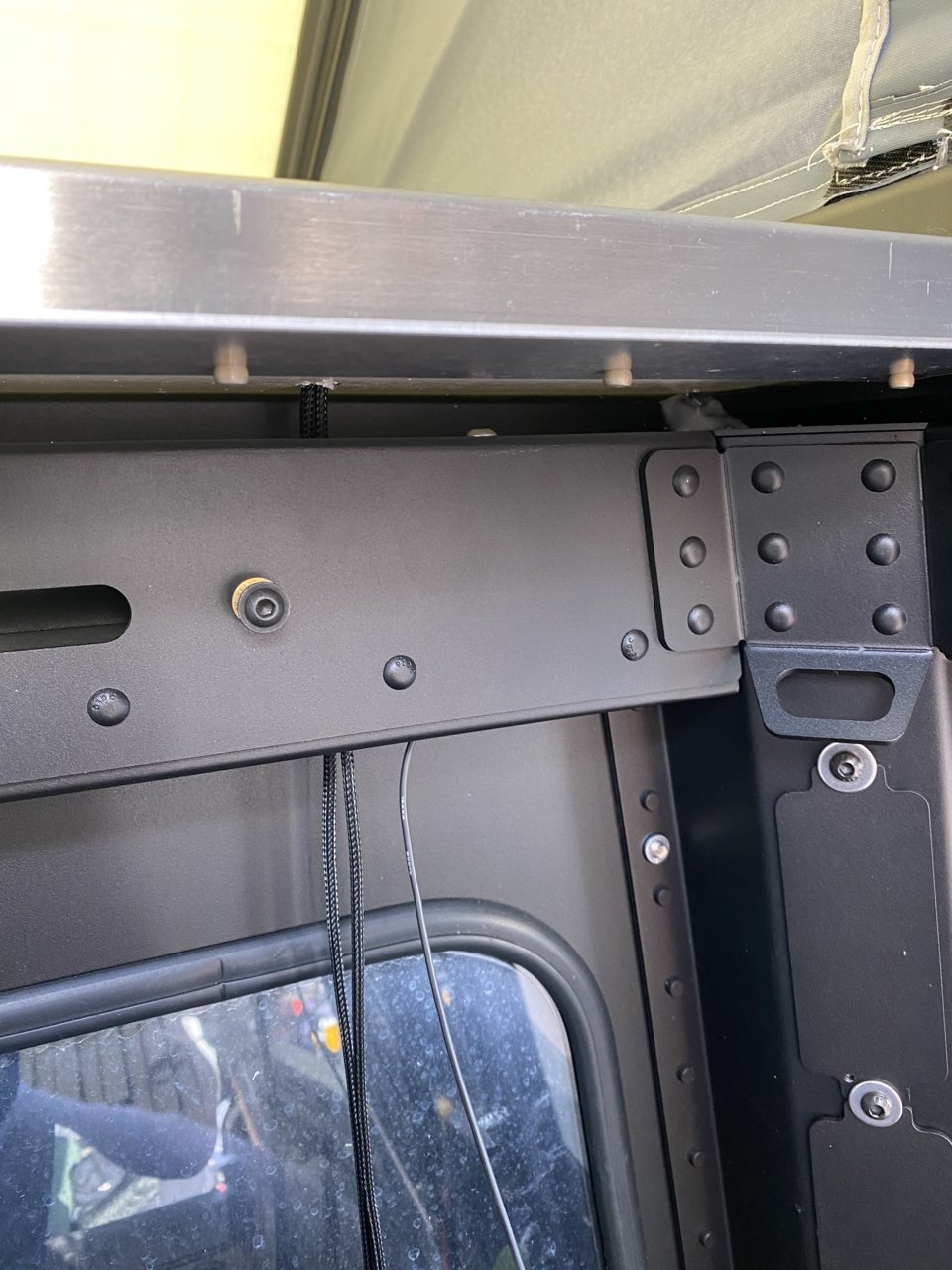

    Finally got around to putting my Baja Designs dome lights “upstairs”. I went with these because they already have an integrated button switch, plus they’re perfectly sized. Expensive though. Red on driver side, white on passenger.17D306A1-96E7-4FA8-AC71-B2DE8B184C1C.jpg 281BA765-88F5-4631-A2B6-0AC31443C08E.jpg
    I hid the wire in the track behind some “Light Duty Weather-Resistant Santoprene Foam Cord, 1/2" Diameter” from the all mighty McMaster-Carr.
    (https://www.mcmaster.com/6322K14)
    Snugs up tight in there and can be removed easily to add or take away wires.
    There was enough space around two sides of my ‘permanent floor’ to slip the sheathed wires in and jam more of the foam round in to secure it8A960FBE-E62C-4455-92D9-932E071E4DEC.jpg
    Had to cut and mash the passenger side though, but it stays under the mattress anyway so it’ll never be seen.
    Next was find a way to drop wiring below to my panel, yet still be able to slide the ‘moveable floor’ panel on the permanent floor without shearing off the wires. I opted to cut into the floor using a 1/2” hole down to the fuselage, and a router and knife to make a channel for the wiring:
    B07AA17E-1CB1-4BDA-9FBF-946BB6BE53AE.jpg 17B2540E-C960-46BB-BEA4-A2E3FD125086.jpg 6EE10AEE-8121-4475-9841-BC2F6E3561BC.jpg 64F55C00-F03C-4230-9319-AFA5164EB00C.jpg C082908B-E45E-4309-B37B-F47181D017AD.jpg A63DF89D-E7FE-440D-B926-5D325D0FEBAC.jpg
    Looking back, the material wasn’t great with the router so a blade and straight edge would’ve done just fine.
    I understand the strength of the material is now “compromised”, but it’s still solid and I put my knee on the channel with no crunching. I think it’ll be fine underneath the mattress, and especially so when I add a piece of u-channel in there over top of the wiring. Not closing it up yet as I will be running power to a Maxxair fan soon.
    I absolutely love how the X-1 allows for wiring to be hidden. I’ve run all my wiring through the fuselage and into my hidden panelE35A8F55-A92B-47F1-AC33-64C1657DC9E8.jpg
    Quick night check, one dome light in each color is plenty of lightF42BE355-F1CA-40B3-BD85-25323C3CD0FB.jpg 2579A06F-2AA1-4097-ACA6-0323B44A2FFD.jpg

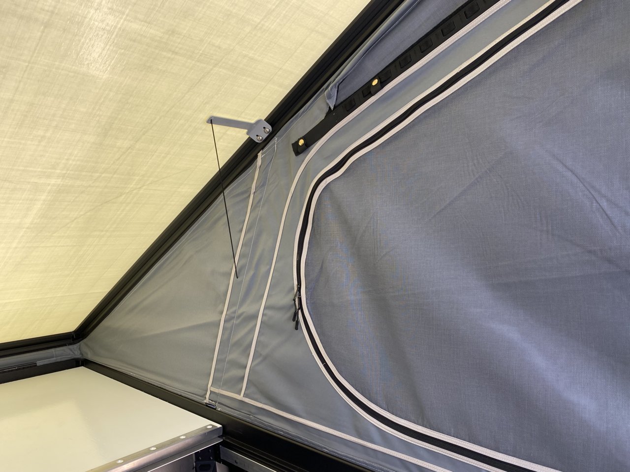

    Is it me or does that stitch work look a little sloppy?
  8. Mar 26, 2021 at 10:02 PM
    #2788
    JasonLee
    JasonLee Hello? I'm a truck.
    May 9, 2014
    #129454
    12,146
    Jason
    Q322+3C Denver, Colorado
    15 TRD OffRoad
    TRD Supercharger and more.
    It looks fine to me. There are a lot of overlapping layers there, which makes it naturally look messy. Also, you’re seeing the ends of the thread sticking out in a few spots.

    Very slick. So what are the T-shaped brackets and cord for? I realize that's SP's work but never noticed it. Is that some provision to help the top canvas fold in?
    Also, is it these BD lights? Those little suckers ARE expensive!
    https://www.bajadesigns.com/products/LED-Dome-Light-w-Switch-Red.asp
    mac_2_nite[QUOTED] likes this.

    The cords pull the tent in/taught to help with closing it up.
    86Scotty[QUOTED] and mac_2_nite like this.
