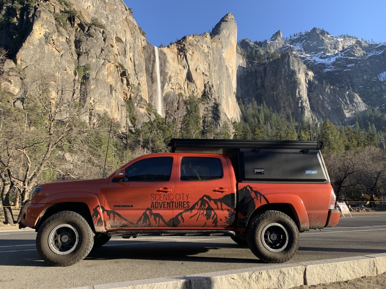

    Lots more photos coming soon! Currently 4K miles into our trip, and still have to make it from Cali back to Tennessee.
    So far we have seen the salt flats, Haystack rock, crater lake, drove most of the Pacific Coast Highway, went through San Francisco across the Golden Gate bridge and grabbed some sourdough, went into Yosemite to see El Capitan, and hitting the Grand Canyon today. Not a bad trip so far.
    Oh ya, and this camper? We’ll, it’s the highest quality, most throughly thought out, BA camper ever made. Sorry GFC, you have nothing on this. So glad I sold my GFC and got onboard the SP train.

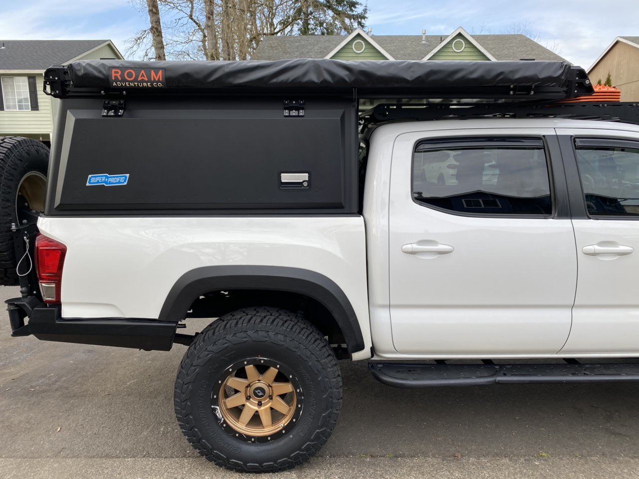

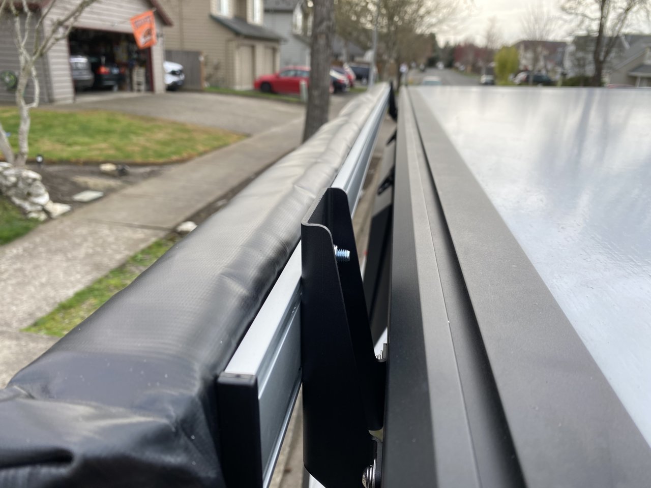

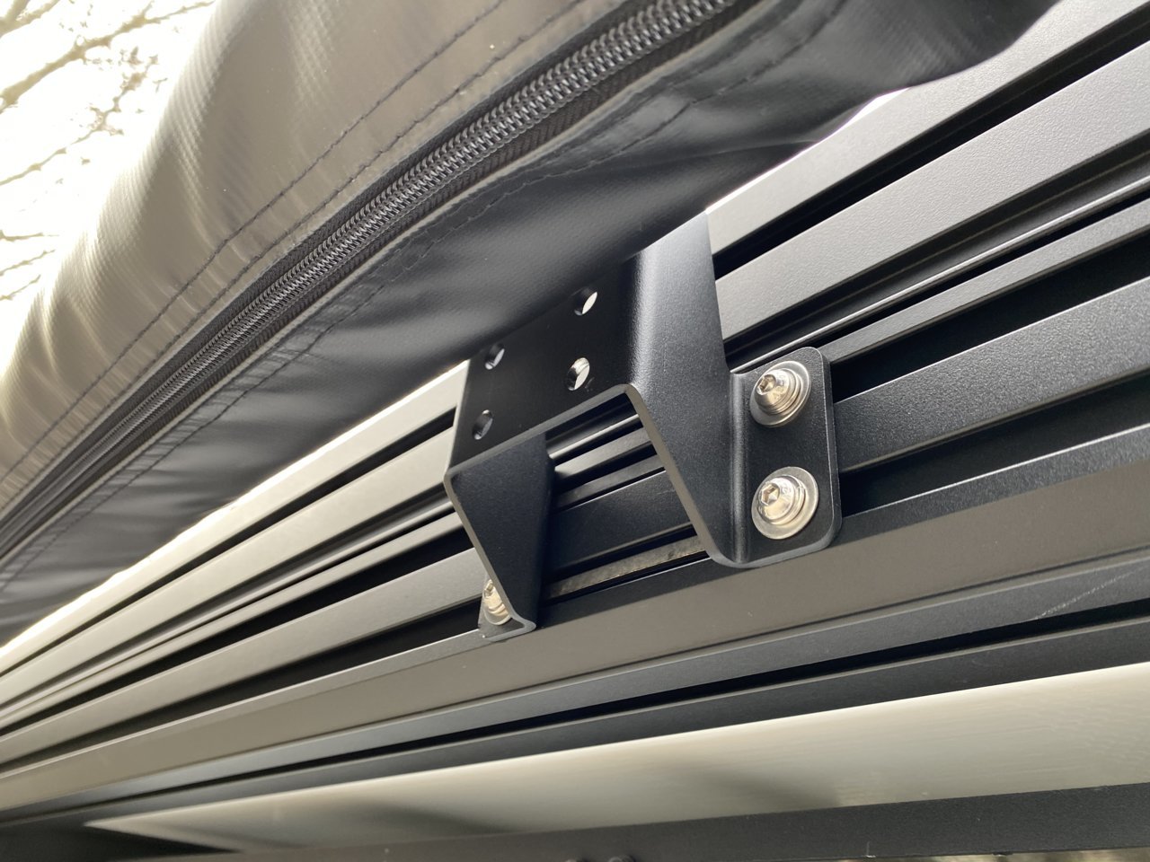

    I finally installed my 8’ Roam awning. I used the the slits on top because I didn’t like how the bracket poked up above the awning since I’m not running a 270. I also added lock washers to their washer/bolt just to be cautious in case they back out from vibration.

    Looks great! I went with 8ft ARB awning. Paid for brackets this morning, hopefully I'll have them next week.

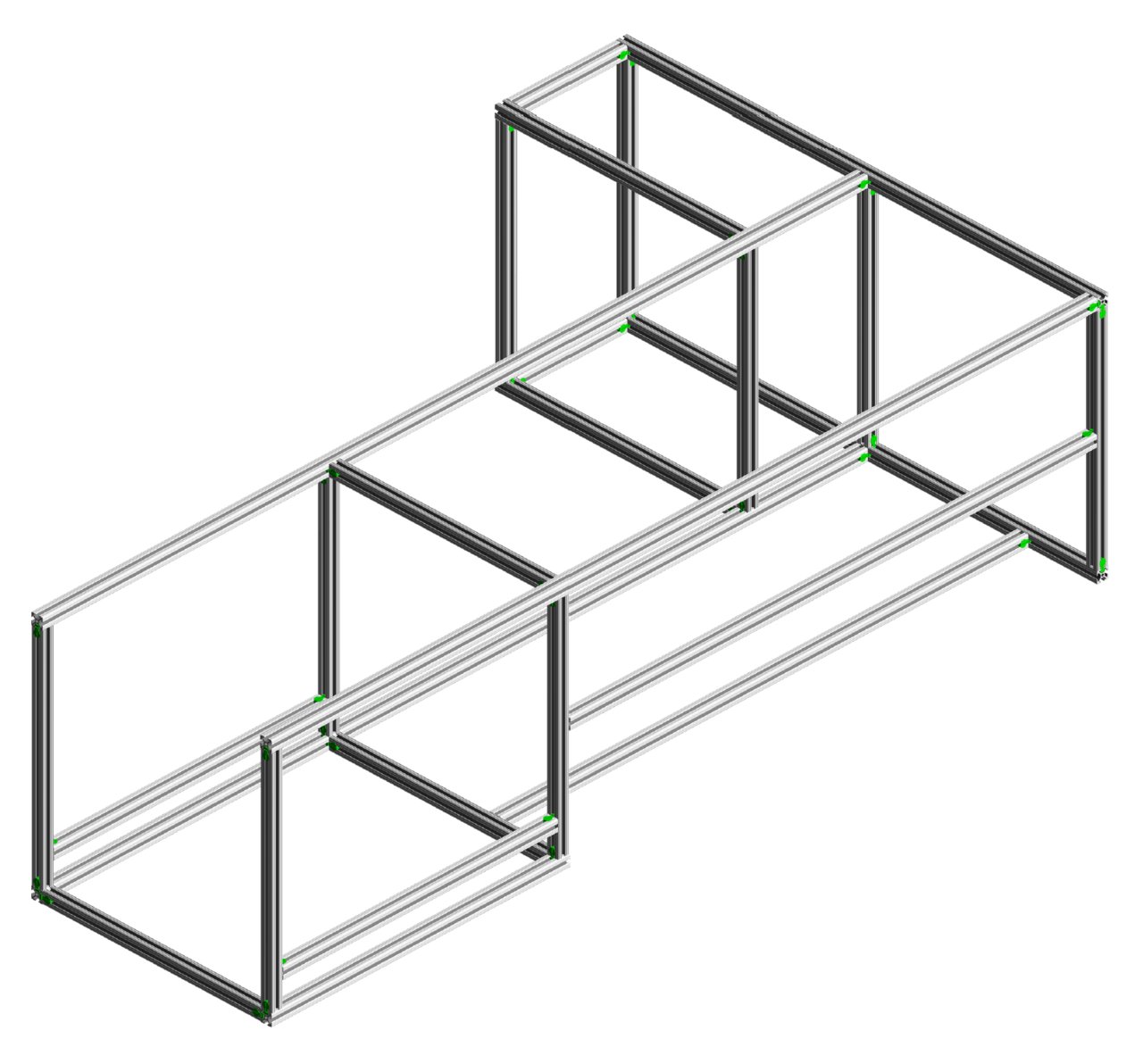

    Well here's the quick view.
    Goals for my setup are mountain bike/camping trips. Need to be able to carry a moto on a hitch rack with MTB inside, and have a sleeping platform in the bed for stealth camping purposes.
    The cabinet will take up passenger side and also along the cab partway across. Fridge will have a platform by the tailgate. I was going to put a slide there but will try it first fixed. I think it will be easy enough to access without a slide. I'm going to mount it so it will be flush with the lid I put on the main section of cabinet. That whole length will become a sleeping platform when I need to stealth camp.
    Bike will lean against the driver side wall with back wheel against the cabinet.
    Lots of compromises with this setup but it if meets the goals above I'm good with that. I'll modify as needed.
    I spent a ton of time going through the Vagabond thread for ideas, but ultimately you have to consider what your needs/priorities are and what design will meet those first.
