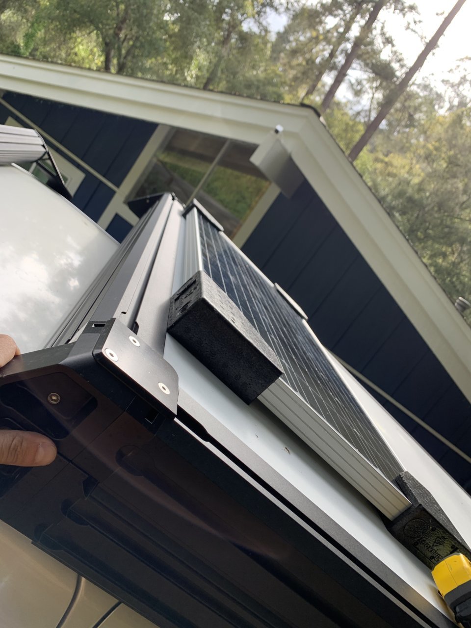

    For anyone curious.
    Got 1 renogy 100 watt panel.
    This is what Fitment looks like. Will need brackets of course.

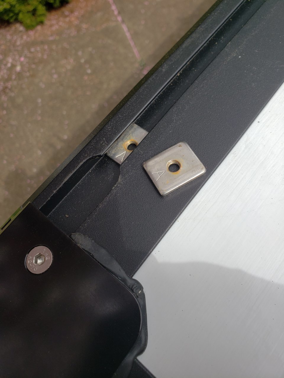

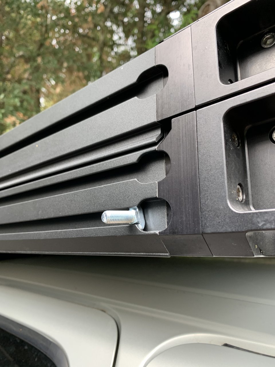

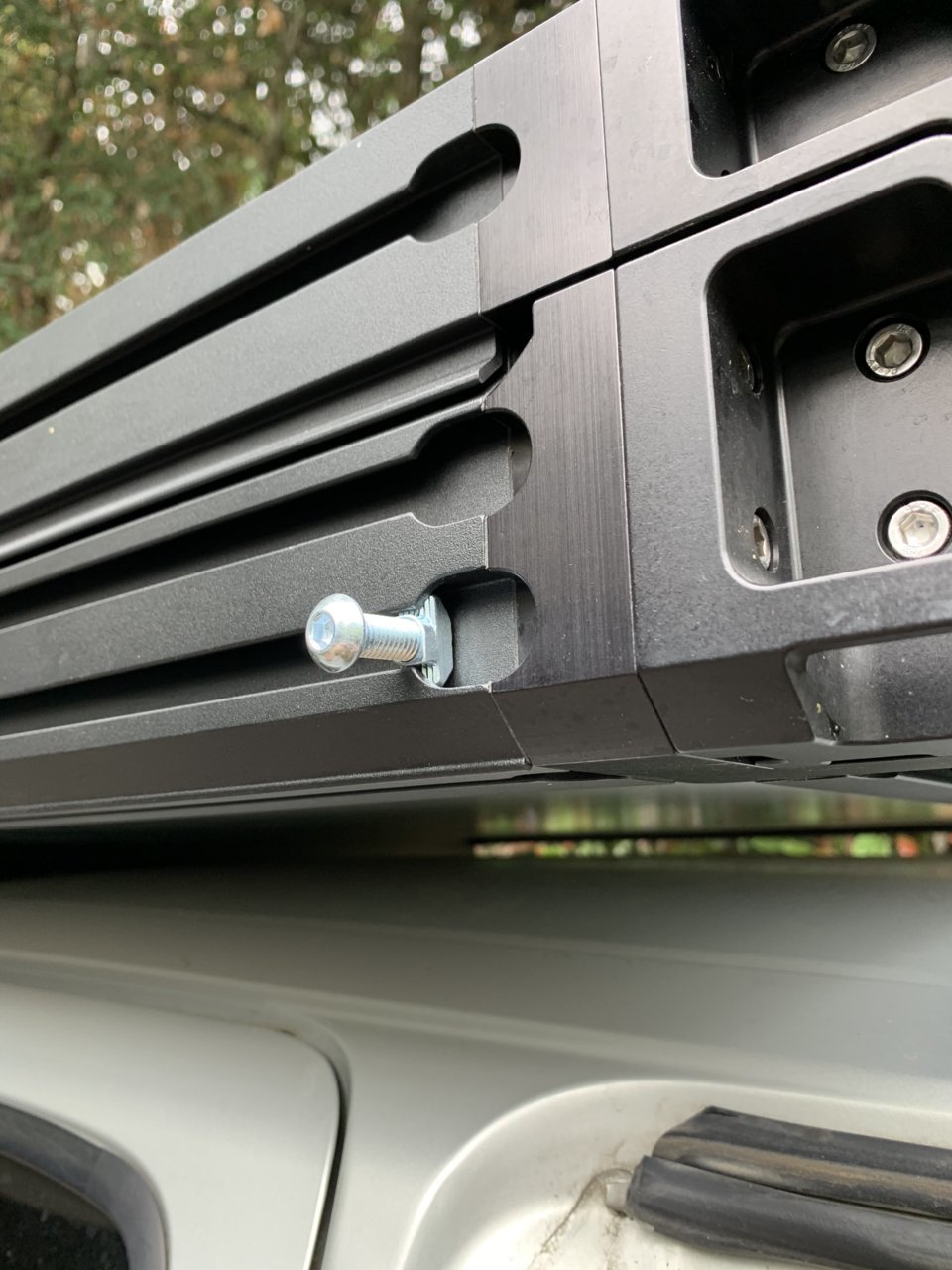

    I did, but as far as adding a chase light (usually on the corners) I couldn’t find a safe way to get through the extrusion and then also down into the wire chase. The extrusion is closed off from the wire chase area.
    The posts like that are fine, I’m talking about the t-nuts that are just threaded. The face that protrudes from the slot in the extrusion is a maybe a mm or two too proud and required filing.

    The bottom image is the nut. I see. Where the thread is it sticks out from the slot. Makes. Sense
