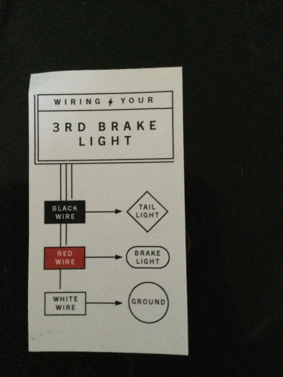

    Anyone have a pic of the 3rd brake light wiring diagram?
    I seem to have misplaced mine

    Hmm I know white is ground.
    If no one beats me to it I’ll try to see if I have mine

    Thanks guys. Of course i assumed black was ground... Good times.

    Yah you would think right? I almost wired it up that way but good thing I checked first.
