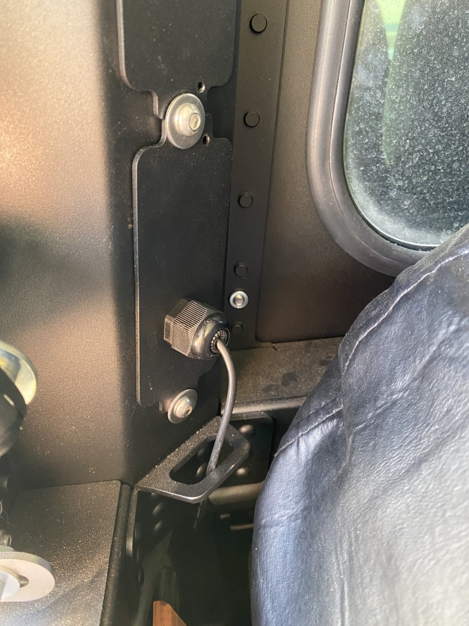

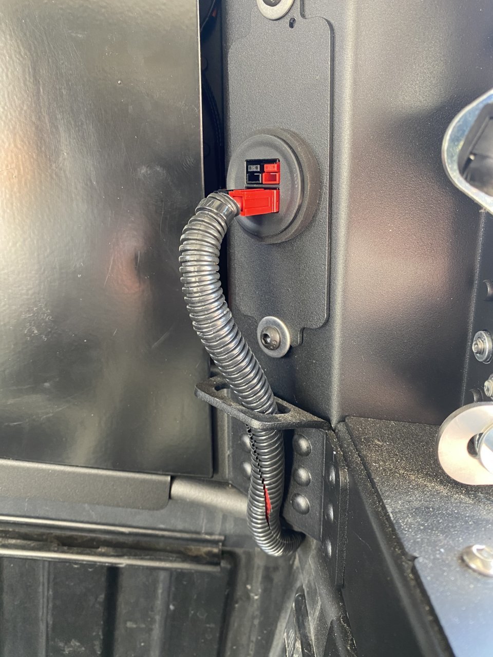

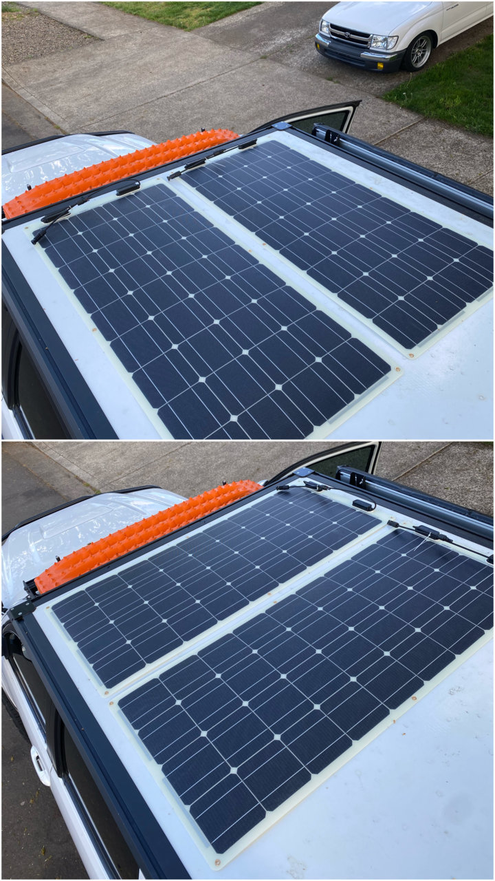

    Same panels I have. How do you plan to attach the cables to the camper's slots and route them inside? I'm not thrilled with Renogy's cable leads - the differing lengths and going off opposite ends. Not very convenient unless you connect in series. Had to order a 1.5 ft extension to connect them parallel. I'll be making yet another home depot trip in the morning to look at cable mount or clamp options to hold the MC4 adaptors. I may drill out the hole on the MCR adaptors so I can mount them direct using T-nut bolt.
    I've been flip flopping on configuration decision. Originally I was going to mount using the configuration in your top pic as that exposes less profile per panel to the wind. But after seeing what a mess the cable leads will be I don't want that exposed to the wind either.
    Researching mounting options I read that overheating can reduce lifespan of flexible panels so you want to have both insulation and airflow below the panels. Airflow also helps eliminate moisture. I'm planning to use this guy's mounting method which addresses both issues, and also makes removal easier if needed. I've got it built already for the upper configuration. https://www.youtube.com/watch?v=uJIEXhnF8MU&ab_channel=RVwithTitoDIY
    It looked like I could easily configure panels in either direction using his method but the middle eyelets on the two panels don't line up. If using the bottom config I could still attach the ends of each panel to T-slot but not the middle eyelets to a central T-slot. Probably not a big deal as I can just run extra lattice end cap along the long edges. That lattice end cap and the T-slot will be stuck down with VHB tape. I think I'm leaning toward the bottom configuration now, to make wind exposure to cables less of an issue.

    I plan to just use industrial strength velcro that way I can just remove them when they're not in use so they don't deteriorate. I am going to use them mainly to charge my Goal Zero Yeti 1000. I bought "Y" cables from Amazon and they reach enough to where I can connect them parallel when they are side by side like the bottom configuration.
    Here is the “Y” connector
    BougeRV Solar Connectors Y Branch Parallel Adapter Cable Wire Plug Tool Kit for Solar Panel https://www.amazon.com/dp/B0753X68PS/ref=cm_sw_r_cp_api_glt_fabc_6QW6R27AZ3635X11ZB25?_encoding=UTF8

    It looks like he converted a flexible panel to a non flexible panel with a rigid frame. At that point, why not just start with a rigid panel, and mount that to a track?

    Yeah I'm not sure why the Youtube guy went with flex panels. Moar content? In prior iterations he had the panels taped down with Eternabond tape, which seemed like a total PITA to deal with. He has the room to go with rigid panels.
    I can't use rigid panels myself, too thick for the miniscule clearance I have with garage door.

    I’m switching to flexible mainly to keep the height down. Have rigid now.
    I plan to install with heavy Velcro as well. folks I know installed that way have had no issues, wind, rain etc

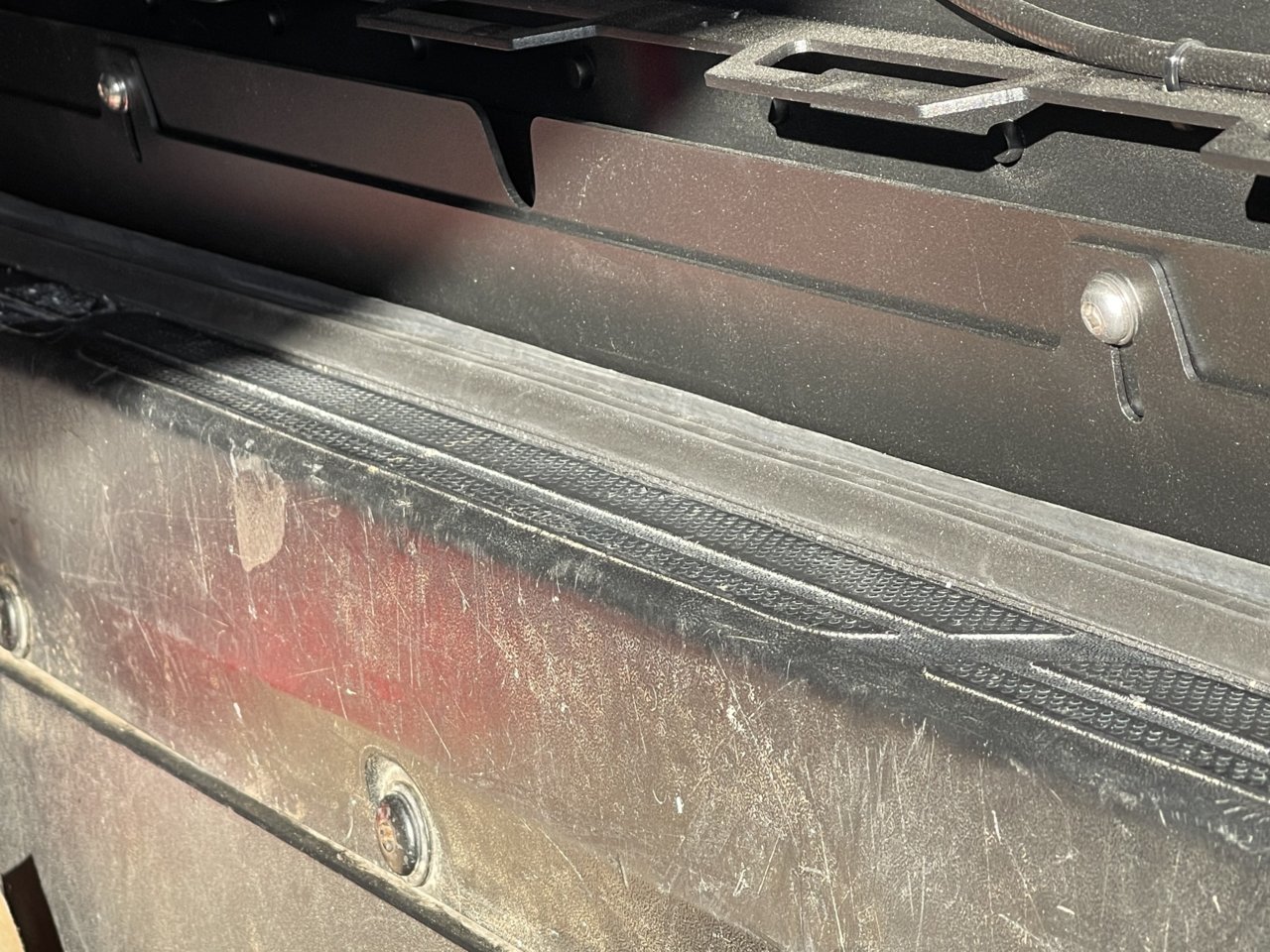

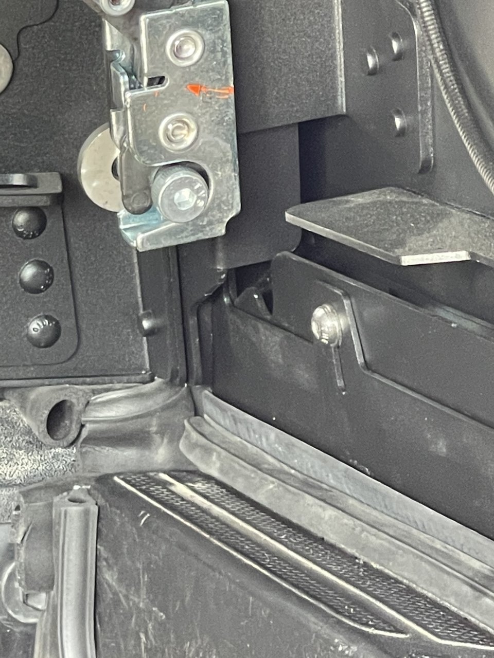

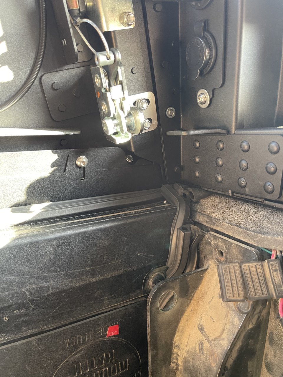

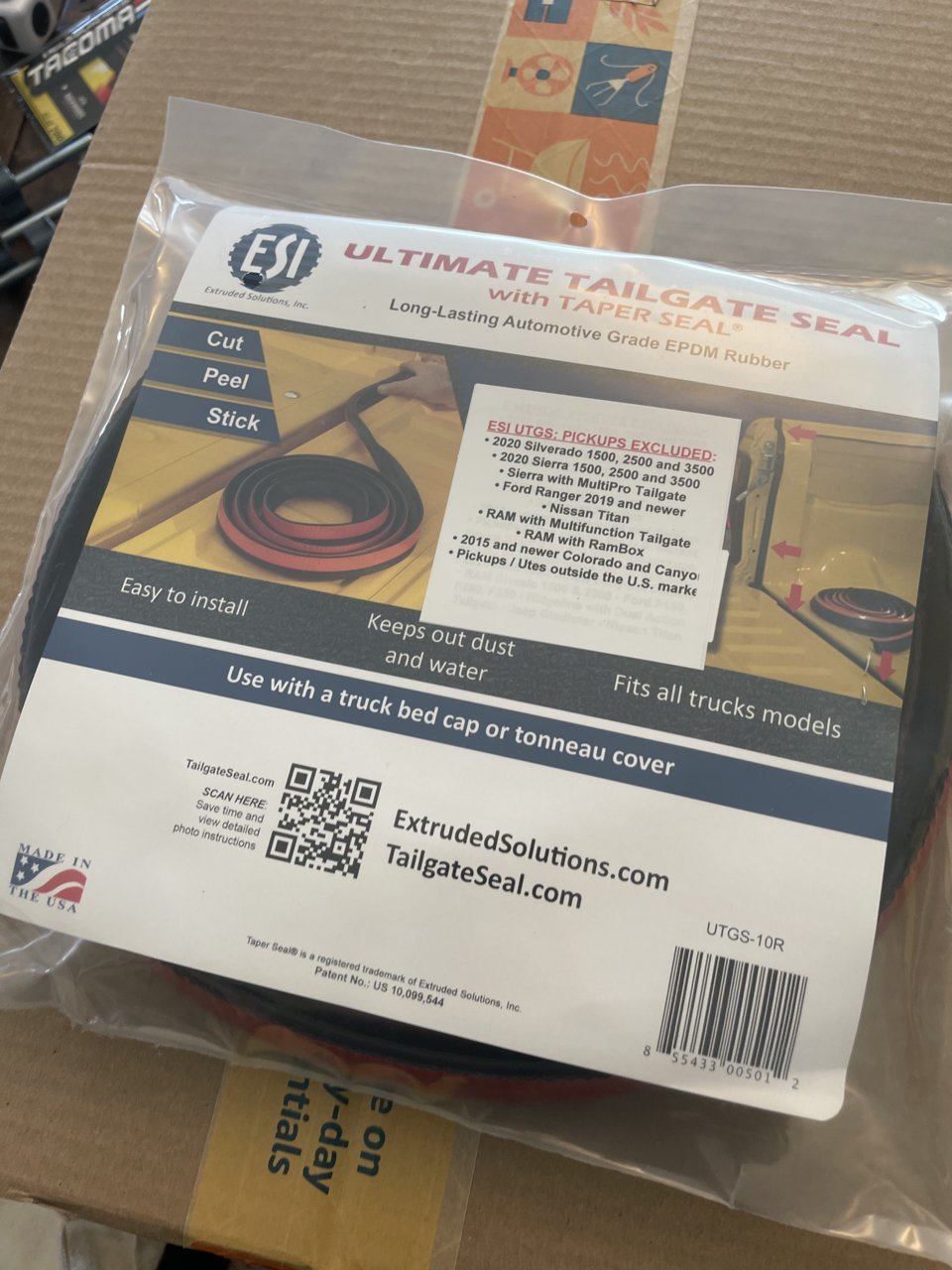

    Some of the dust issues you will have is it any camper. The tailgate and cubbies are big trouble spots. Grab a tailgate seal. I already had one around my tailgate bottom and sides.
    I had some left over and eventually bought another which I put on Top of the tailgate. The crudely used extra to plug the corner until I find a thicker one piece.
    I’ll take some better photos tomorrow if interested.
    top of tailgate
    corners
