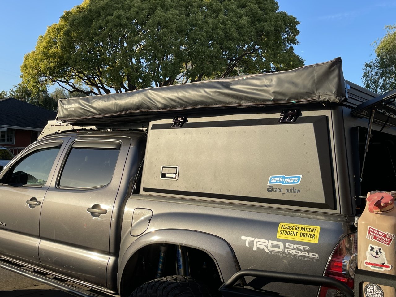

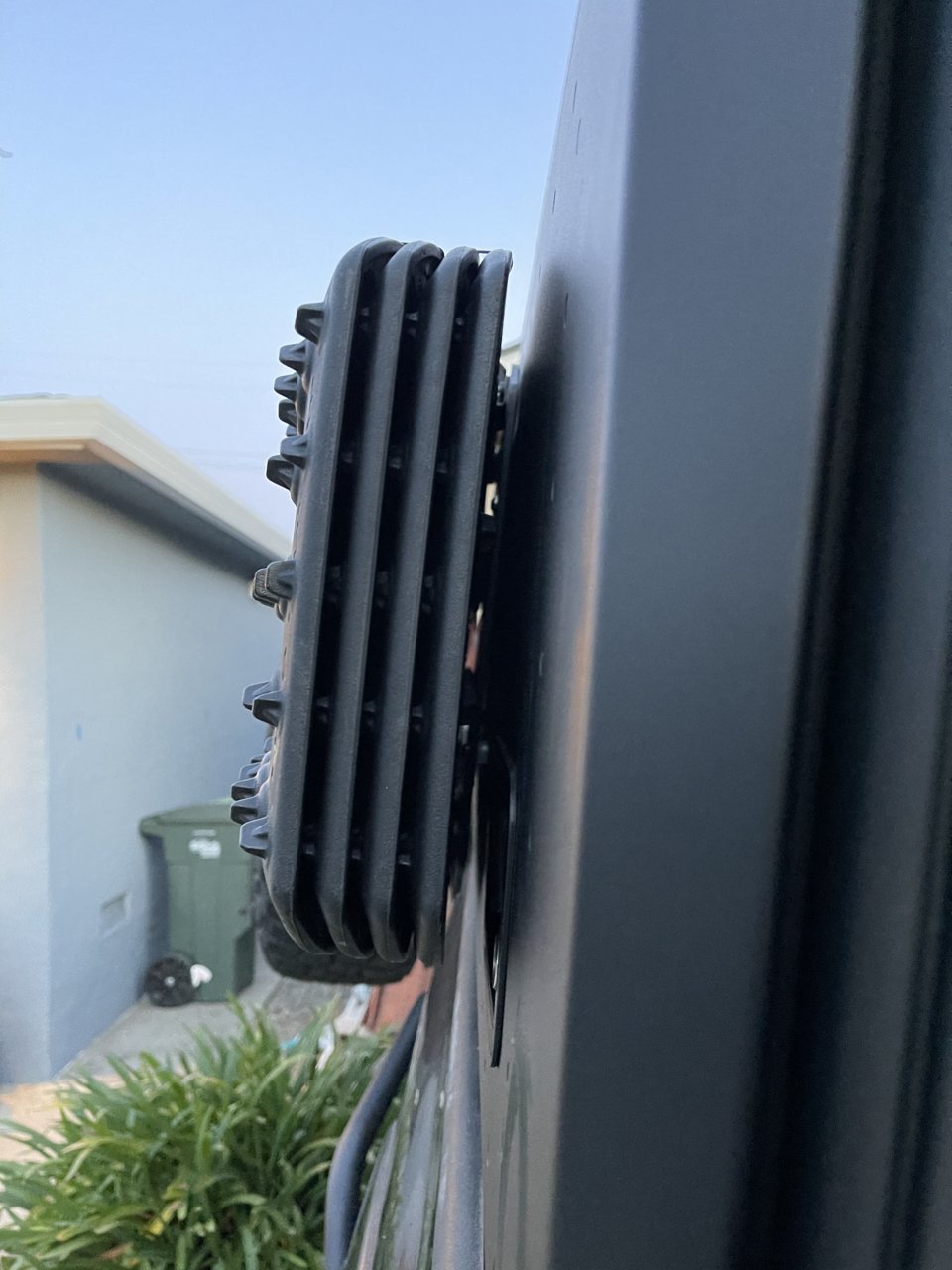

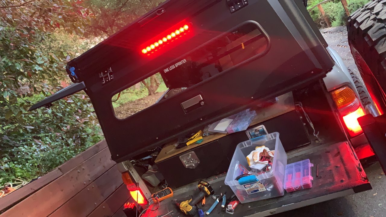

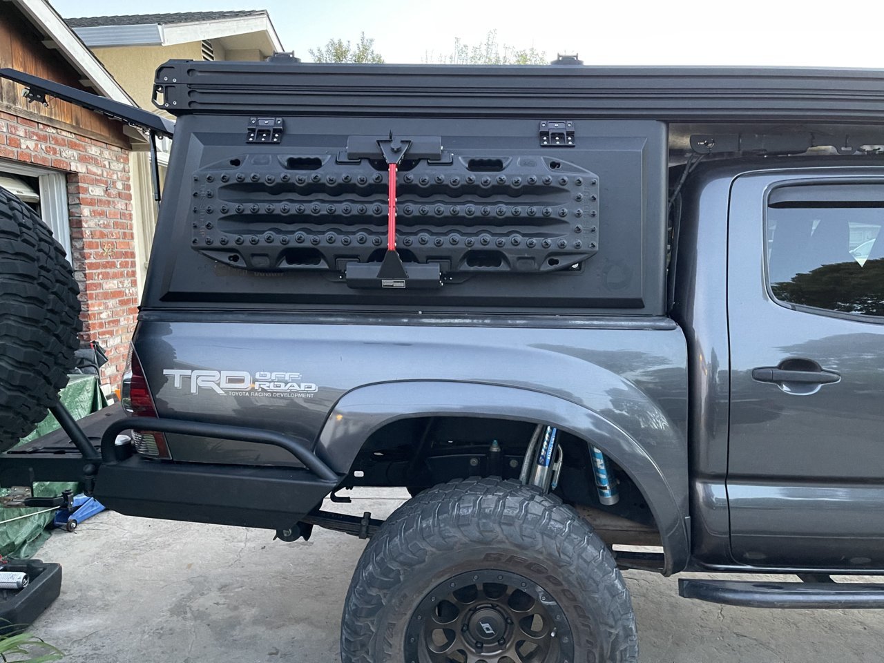

    I’m with you on the door. My driver side won’t open. I know where to adjust but can’t seem to get it to turn since it’s not fixed if anyone has any suggestions.
    I drilled a few homes in the X1 over the weekend. I added 1/2” nylon spacers on the bottom which allows me to open it still. (Will require stronger struts though) also I should have mounted it 1/4” high it’s just anoint to not be able to insert key but it’s easy to open and lock if needed.
    3687DFDA-0076-4788-B5B0-89FF24960875.jpg 044FFBD7-768F-42F3-AFEB-998D3D608227.jpg A23263A9-EFBC-4E15-B283-9C6810305FF8.jpg
    Also giving the rhino rack a 3rd go. It’s been mounted now a 3rd tine and broken every time I’ve used it. It’s solid work 2 mounts but I did ask for a 3rd as they are not as beefy as the Prinsu ones I had before.

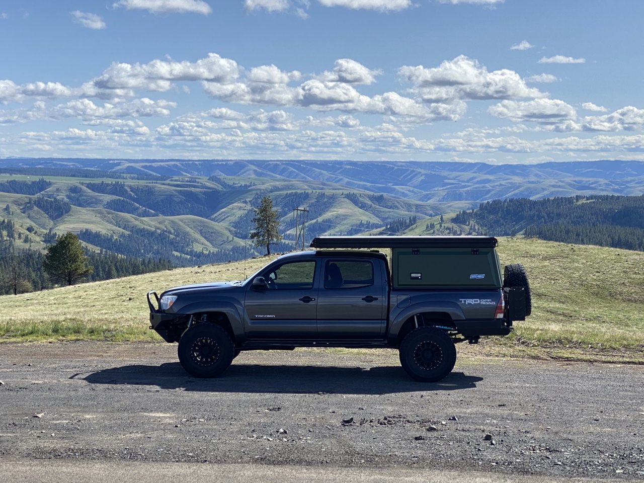

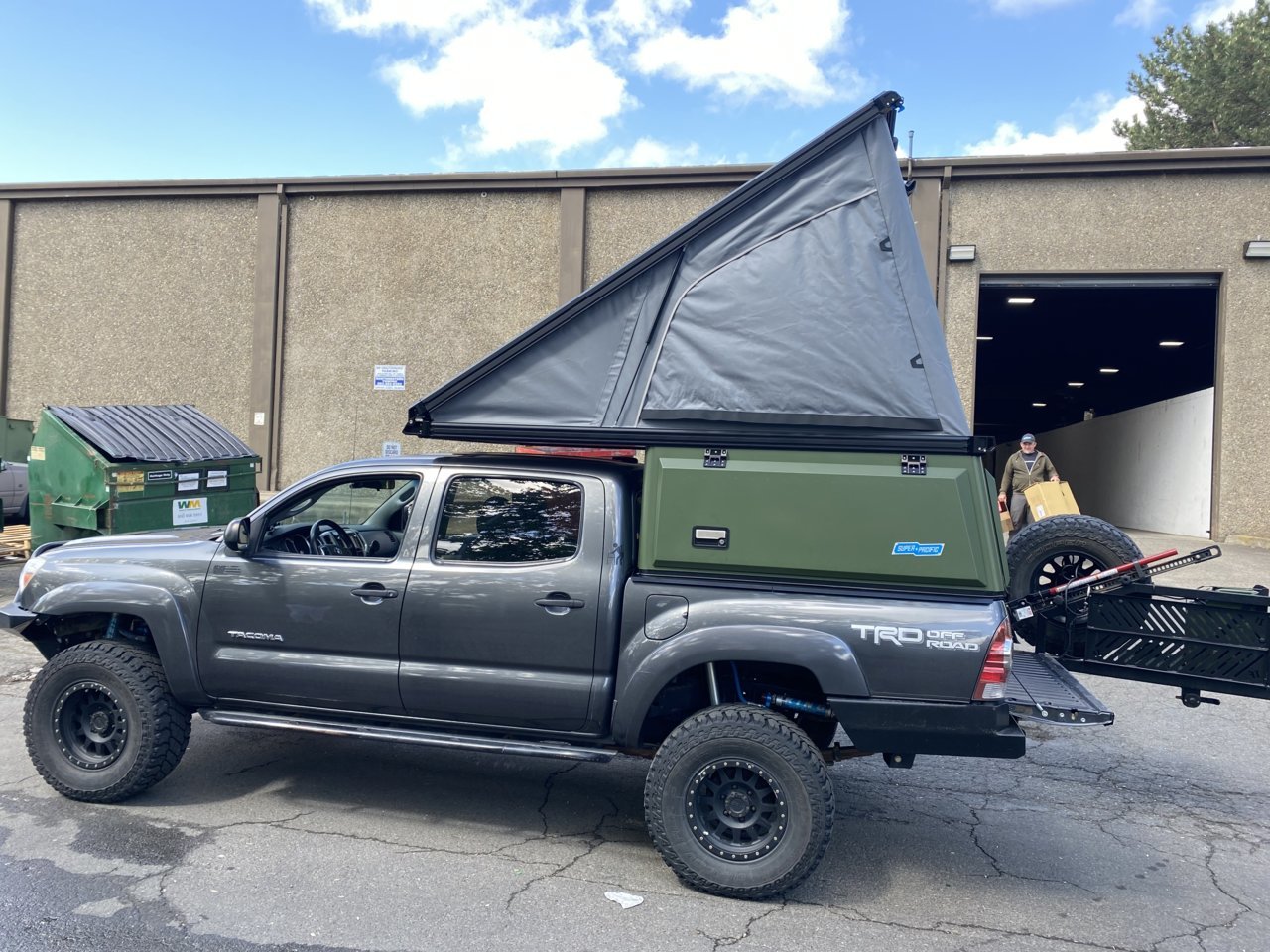

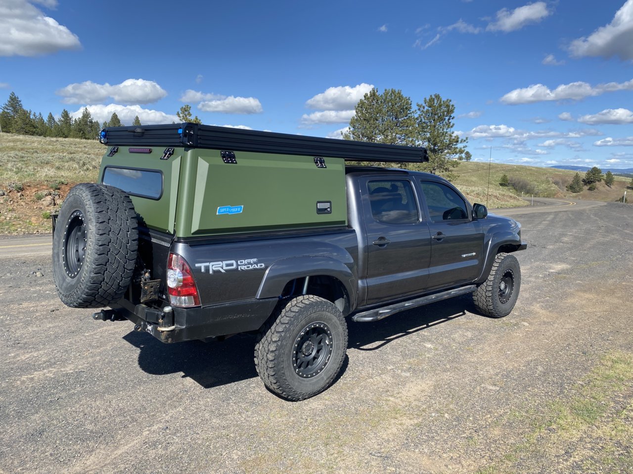

    Well first day with the X-1 super stoked love it. Haven’t had much time to play with it. But the SP team is awesome very impressed. Covered a-lot about the tent and install went pretty smooth. I have ideas and plans going forward for fine tuning the tent for my needs.
    love the Green,

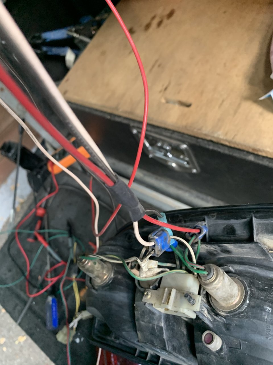

    Posting this for any first gens wiring the running light / brake light to X1 or any camper shell for reference.
    Mine driver tail light already had two vampire connectors (as I like to call them) so I tested them to determine what they were and added a third vampire connector (t splice).
    The white black wire is ground to that bulb.
    The red green is brake light.
    The green is running light.
    Looks messy but thats the nature of a first gen wiring at the brake light I guess. Not that clean from factory lol.
    Took advantage of the existing clips that were in there from a PO.
    Luckily it’s spliced into the tail light wiring which can be replaced and not the actual truck harness that connects to this.
    Will show pic of the wiring inside once I grab grommets from my parents place.
    I drilled a hole in the X1 and kinda debating whether it was absolutely necessary for this :cool: . Think I just wanted to do it to do it. The first hole lol
