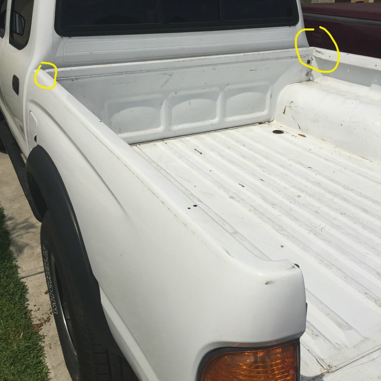

    Idk about second gen, but for my first I should have sealed the bed rails at the front of the bed. Where the horizontal rail meets the two verticals. Water leaks through those gaps.

    Not my truck. But these

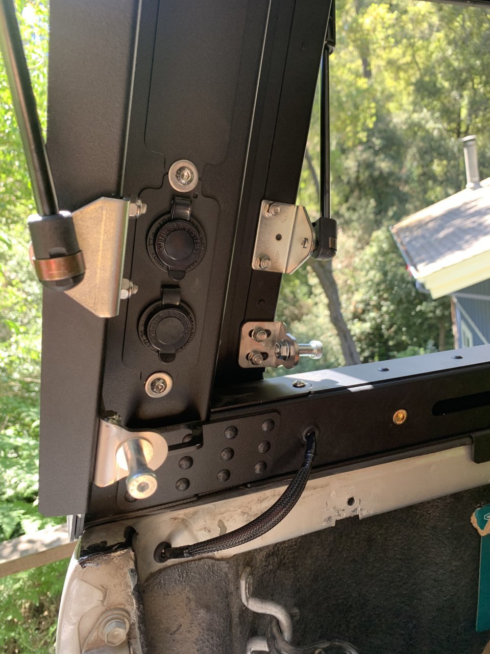

    Nothing crazy but wrapped up third brake light wiring. Used some bullet connectors I had. Hindsight should have made the connections within tail light housing to free up room within the channel. The hole in X1 frame was worth it tho.

    Yeah thought I’d share. Simple but keeps it clean. Wire loom looks like it sticks out more in the pic but in person more flush. Shoulda made the connections in tail light tho but is what it is.

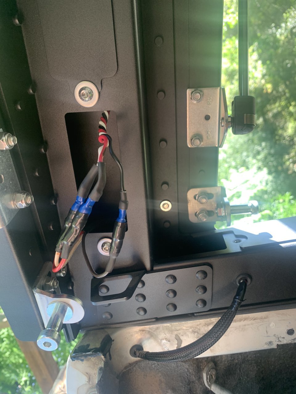

    Getting ready to connect mine. Just wondering, if you’re going to drill why not drill down like they did on our 1st gens when bolting them in? I already have wires coming out of the top of the taillight rear area inside the bed. The gap that the wires are coming through seems to be there from manufacture. It’s right above the old cargo hold we see in your photo, at the top of the “taillight bulge.” Could route right up into the channel if there was a hole. Not a critique, just wondering if I’m missing something, as I often do.

    Huh. Your bed does look a little different. Maybe they changed the bed after they did the refresh with the larger grill. Here’sa photo of my wires. They’re coming through a natural gap right above that leads down to the taillight.
