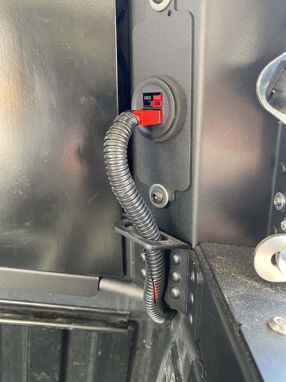

    For those who have gotten into electrical, how did you wire up the USB/plug that came with the camper?
    When I plug female spades onto the blades there isn't enough room behind in the pillar to re-install this plate. Using 10awg wire as that is what I have left right now. Maybe smaller wire would bend more and provide enough room? I could bend the female spades to the side but that seems kinda ghetto...
  17. May 12, 2021 at 7:45 AM
    #3537
    justrussell
    justrussell Well-Known Member
    Jan 21, 2020
    #316883
    388
    Russell
    Sacramento
    I added a spacer on the plug to make it stick out further until I have a better plan. The pillars at the cab are deeper and easier to add outlets to if you hadn’t noticed yet.
    evdog[QUOTED] likes this.

    SLC
    2017 Tacoma Access cab 4cyl 4x4
    i totally bent my female ends... which yeah it felt ghetto but its workin!
  20. May 12, 2021 at 9:08 AM
    #3540
    mac_2_nite
    mac_2_nite Well-Known Member
    Nov 22, 2017
    #236658
    400
    Mac
    SoCal
    2017 DCLB Sport 4x4
    I used a few of these from McMaster as spacers:
    Gasket Washer, for 1-1/4" Hose ID, Water-Resistant SBR
    https://www.mcmaster.com/5456K3
