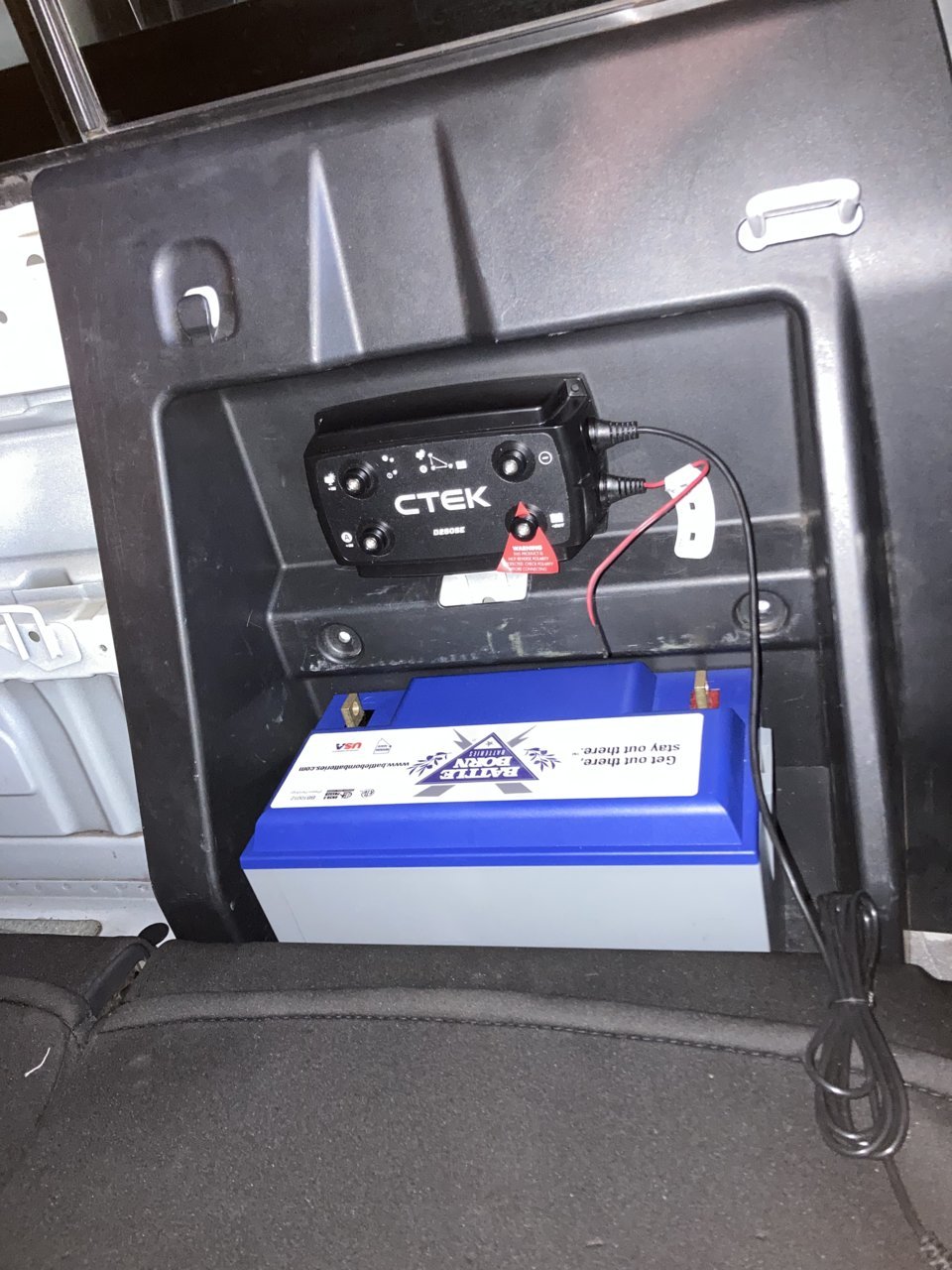

    Has anyone installed their house battery in the small cubby behind the driver? I'm hoping to get ideas on how to strap or tie the battery down. On the dual battery forum, I've seen a lot of people installing it on the other side behind the passenger. There are existing bolts there that you can use to bolt down a tray, but there aren't any existing bolts on the driver's side. Thinking of drilling new holes, unless anyone has a better idea? I'd rather not, because I'm not sure how much I'm going to like this setup. IMG_0969.jpg

    I like the use of that space for the battery. Why not just put a top strap on it? Or maybe make use.of some rivnuts.

    I believe HBmurphy has his mounted in the space on the passenger side.

    I bought a 1.5 NRS strap today to go over the top, but what am I strapping the battery to? I've never worked with rivnuts. Can you explain? Thank you

    Drill a hole for the rivnut size. Not through the plastic cover, but the sheet metal.
    Install as shown.
    https://www.youtube.com/watch?v=dkPhGIaPCVs
    Then drill a hole through the plastic to let the bolt through and attach your strap with that.
    You can use a large fender washer on the bolt and install grommets to the strap in order to bolt through them. Then use the cam on the NRS strap to snug it down.

    Okay, yes that makes sense. I was thinking of just going through the straps with a fender washer. I was just debating if that was strong enough. Really haven't done much of this sort of thing before.
