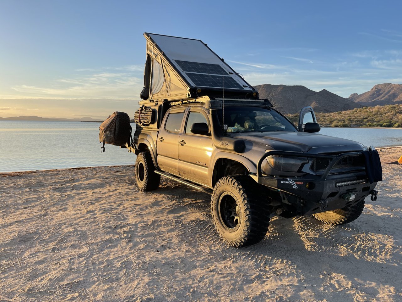

    I got two Renogy 100W panels as well and put them up front on the roof. I ran the cables around the front of the overhang and underneath, using the T-rail to mount them. I looked into using the port under the overhang but the two cables didn't fit very well through it, and not at all with plastic split loom wire covering. Didn't want to run cables through without protection so I ran them down the camper instead and in through the gap between the bed rail and the camper. There are no sharp edges there and room for solar cables plus charging cables from the alternator. My charge controller uses both. Once cables were run through I stuff the gap with butyl rubber to prevent dust and water from getting in.
    One thing to note with the Renogy panels, if you haven't ordered them already. The cable leads exit the panels in opposite directions which makes it a pain to hook everything up unless you run them in series. You can see a pic of mine a few pages back.

    Are your Renogy panels the flex or solid panels? Thx

    Flexible. Needed those for low profile since clearance under garage door is limited.

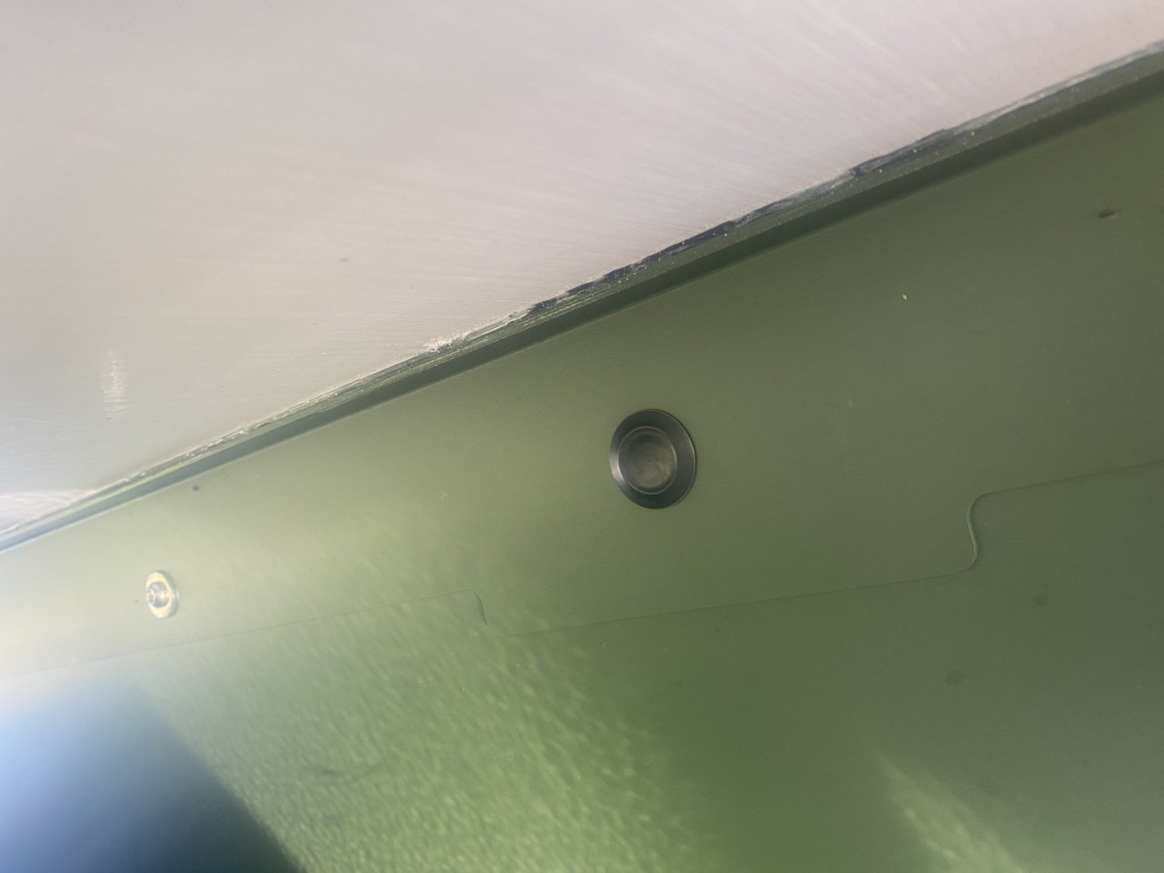

    Can you shoot a picture of this cable port hole on the inside of the camper? Mine doesn’t have this.

    There is a small grommet on the lower back of the cab you can pop out make a hole and put back. I used it to run a rear camera and will use to route my weboost.

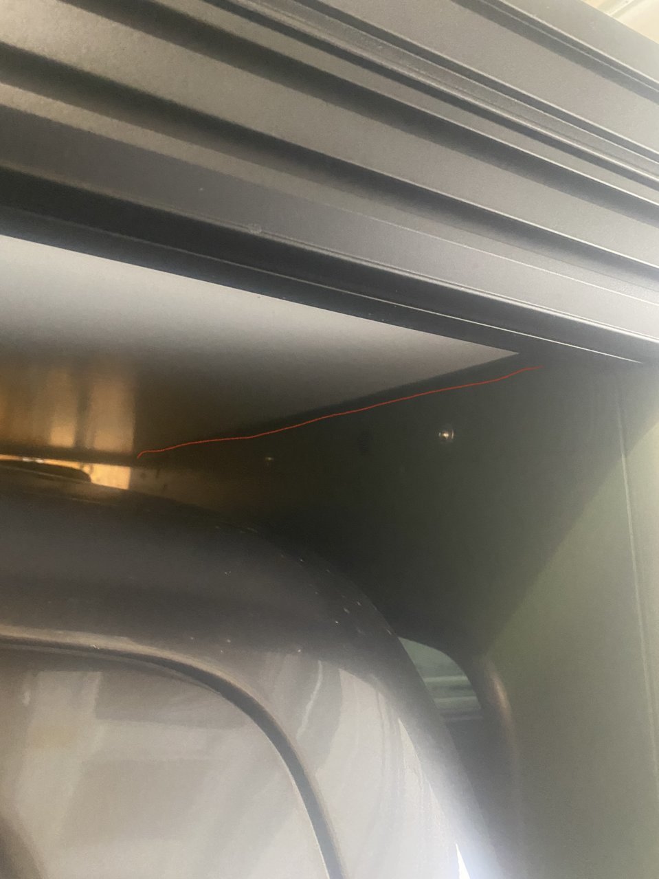

    what were you doing chop or trim lower? I trimmed but on my trip I had to do some more. The bed flexes a lot when off road. Like I trimming a bit more near the front. It should be 1-1.5” of free forward space or it will hit. Downward you need 1.5” or so. I have 1.25 and it was tapping on some back roads.

    This is exactly what I was needing to know. Thanks. I'll start with 1.5" clearance all around then.
    Mind shooting me a picture or measurement of how far forward on your rack you cut? I got dimensions for the camper from Josh at SP.. but some hard measurements from back of your rack to your cut would be super handy!
