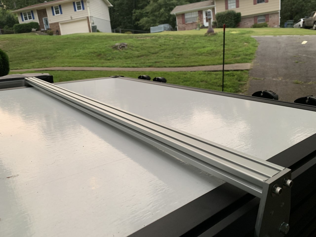

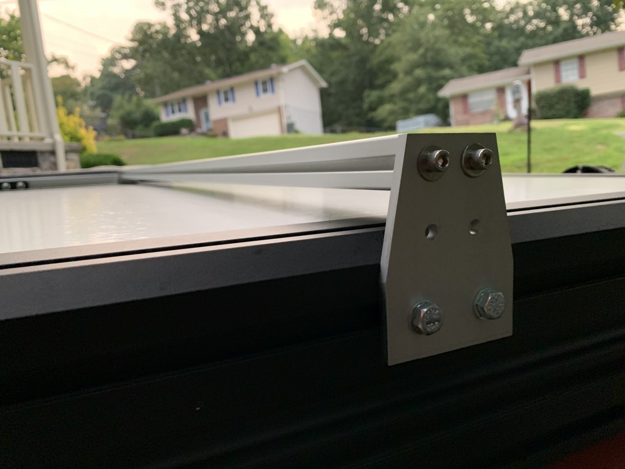

    Where did you order the parts from? I'm sure several here besides me would like to do the same set up.

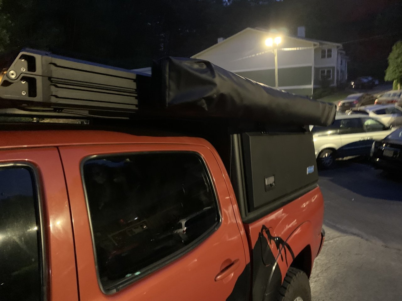

    What awning brackets did you use to attach the OVS NOMAD 270 and did you use 2 or 3 brackets?

    I used three SP ones, but drilled out the mounting holes and used larger M8 bolts and t-nuts to attach the bracket to the SP.

    I used 8020.net for the main parts, then made a quick Ace Hardware run for all the bolts.

    I’ve got a 270 LT awning. Are three brackets required?

    As thin as the brackets are, I would recommend 3.

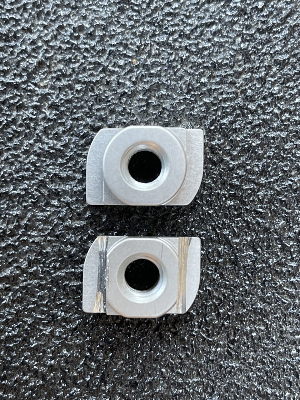

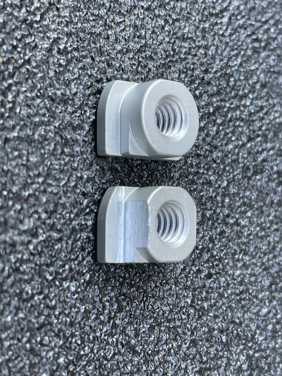

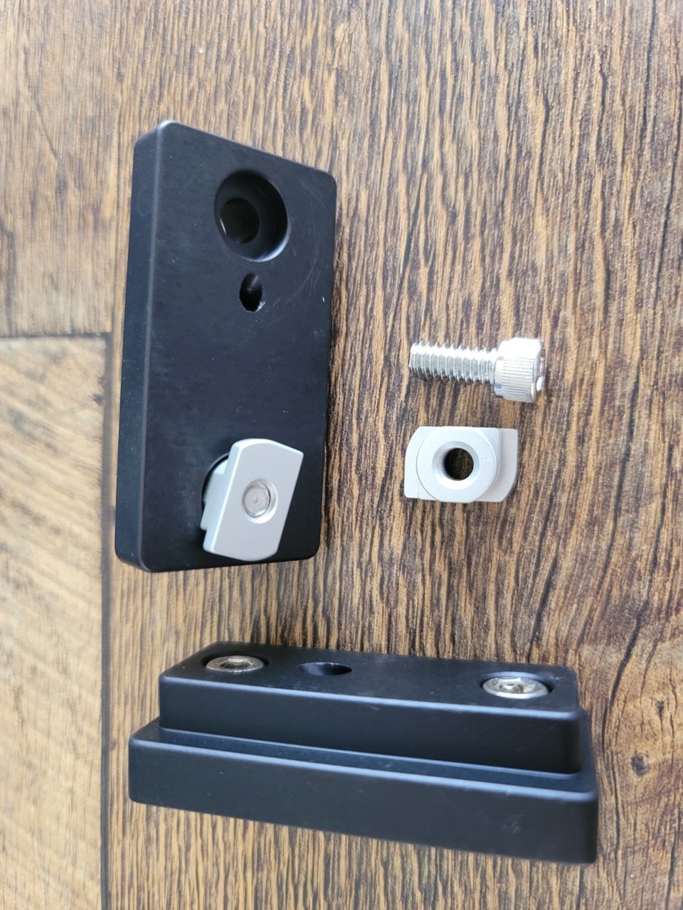

    Gzila rain-fly brackets and poles came in.
    I think I remember some mention about grinding the cams down to fit the SP slots. Not sure how much material to remove.
    Is this something I can do ahead of time or just bring them and a Leatherman along for after the install?
    Or is there a better option to get the pole holders pre-fit?
    PS - there was also some mention of the hinges accommodating a pole slot, not sure what builds that'll be avail on. That would be the best option!

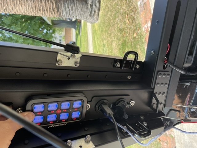

    Just getting around to my wiring… tight fit but works …

    I used a flat-edged file to file down the bolts. I'll try to find the photos. Working fine so far. As to the hinges or some other built in pole receiver, I emailed Peter about this and he said while they have considered this they don't have time for any engineering for add-ons, they're just trying to produce X1s.
