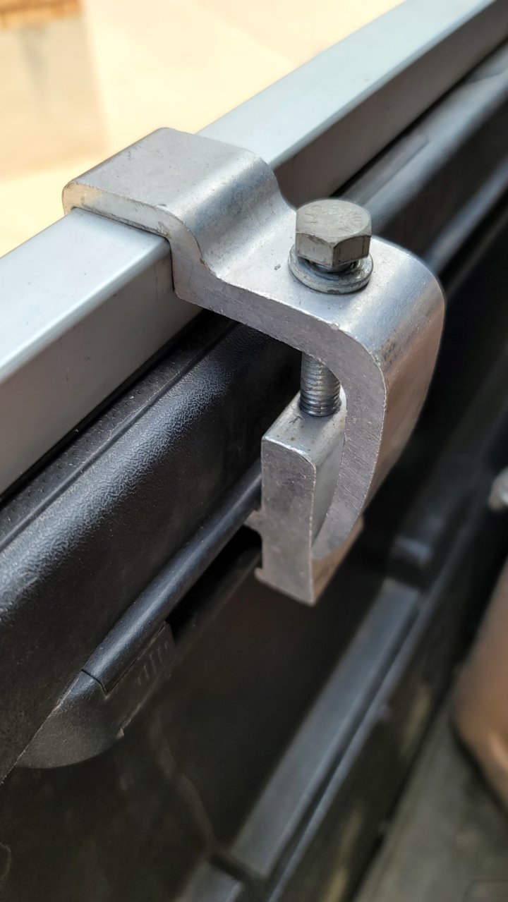

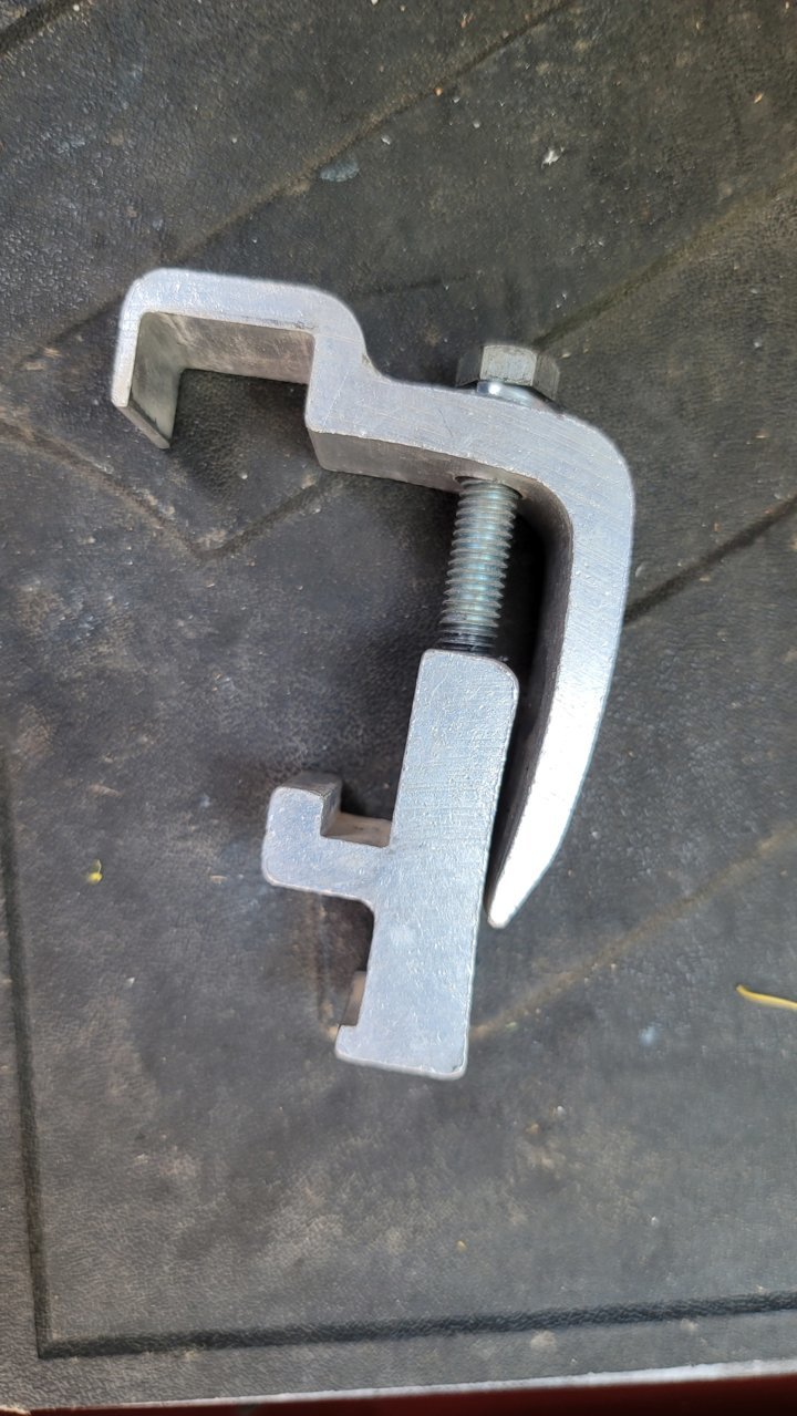

    This clamp issue is a good discussion and I'm sure SP is getting behind it.
    Just another example of a design idea - the clamps from the SoftTopper pull the bar down vertically due to the top portion leveraging against the bottom portion.

    I was thinking something more along the lines of this. It needs to pull from the top not the side like the current setup.

    Agreed. I think if the SP hardware fit tighter and worked better with each other you would get the same vertical clamping effect. As the track block and attached bracket would be nice and tight and sucked together making a stable lower mount. I'm sure that Soft toper clamp fits better in the track as well. I do like that design though.. beefier extrusion for sure.

    My Snugtop shell had similar system to clamp it to the bed as shown by econwatch with two types of lock washers. Worked awesome, never loose.

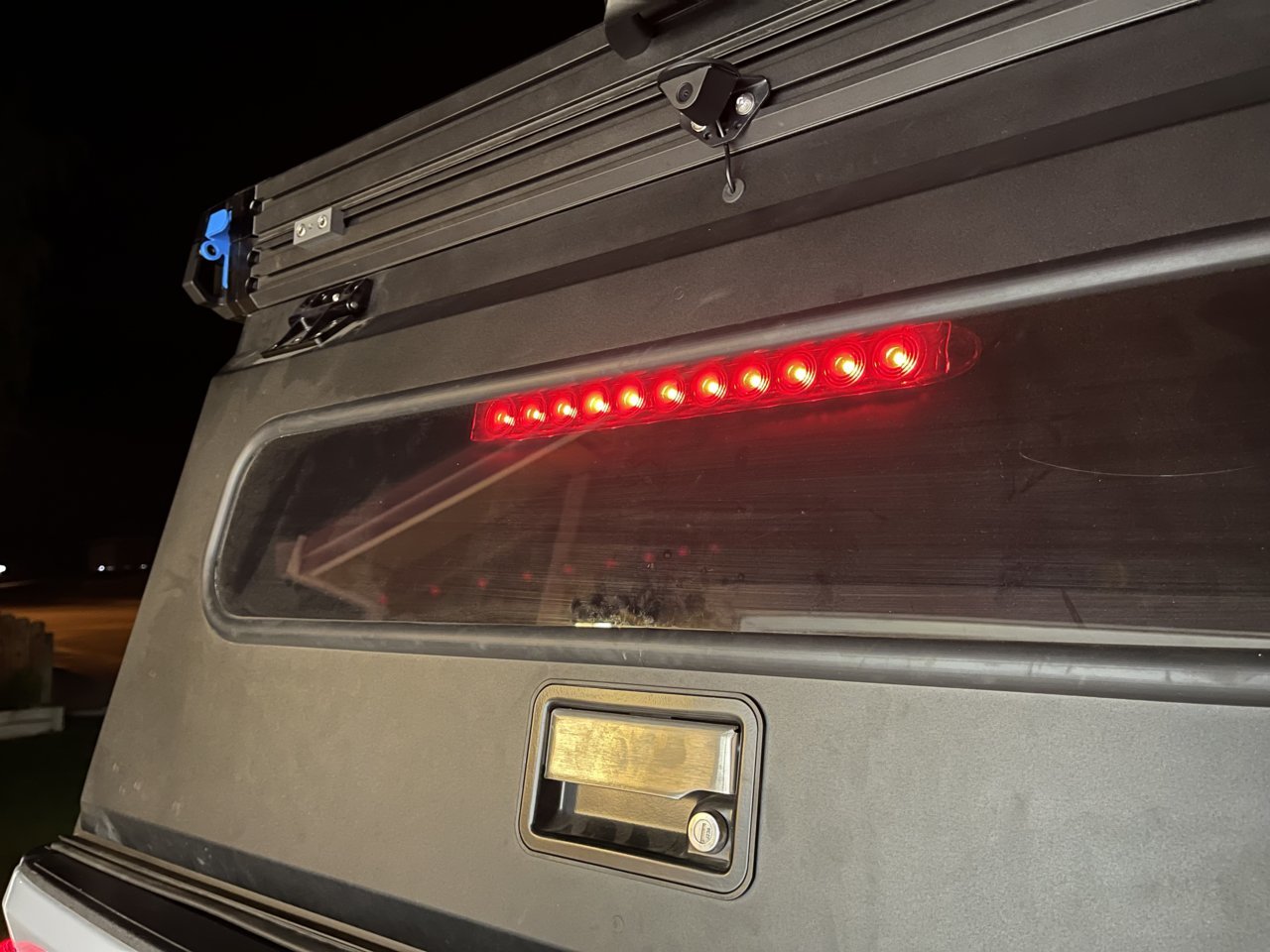

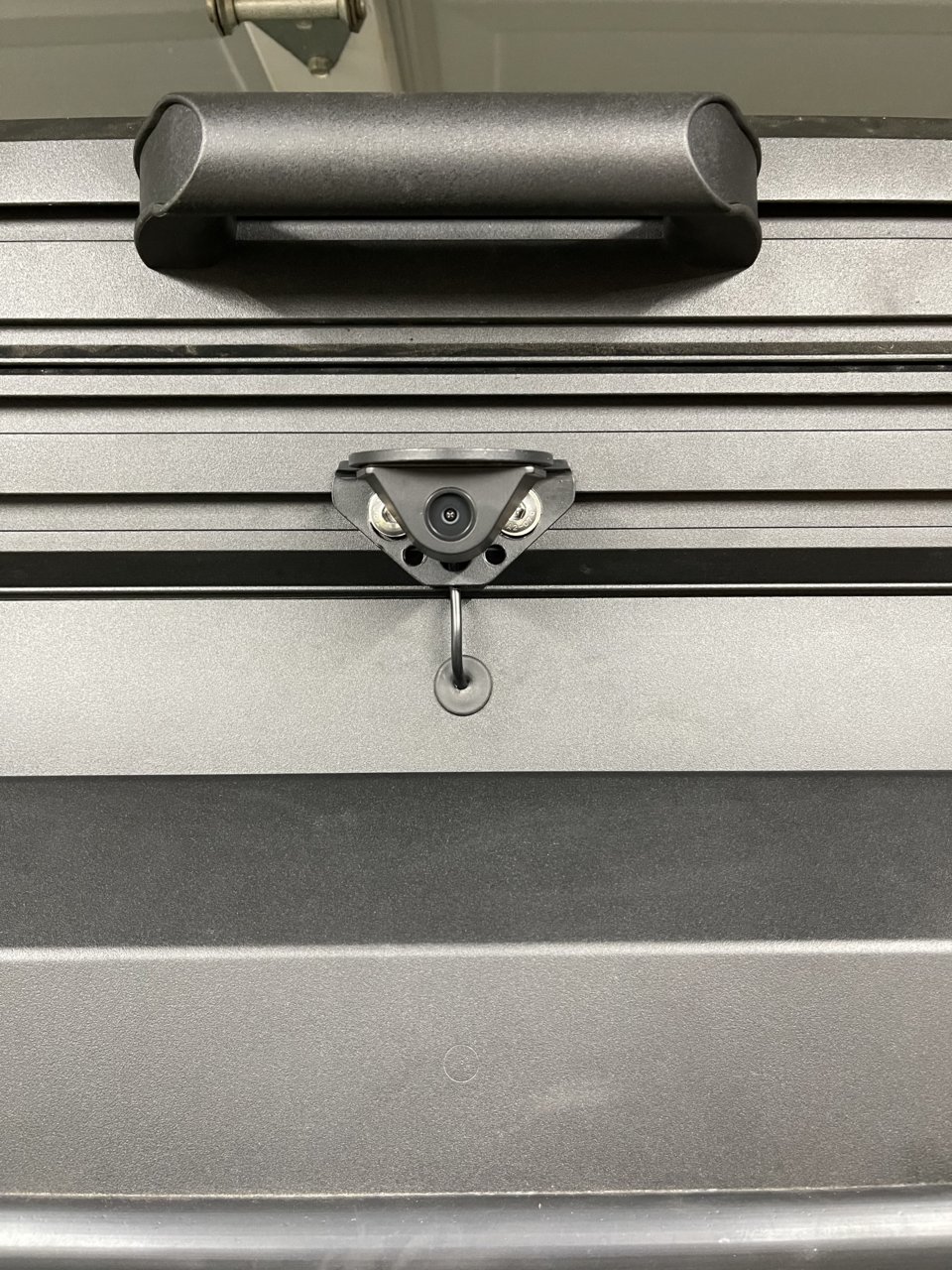

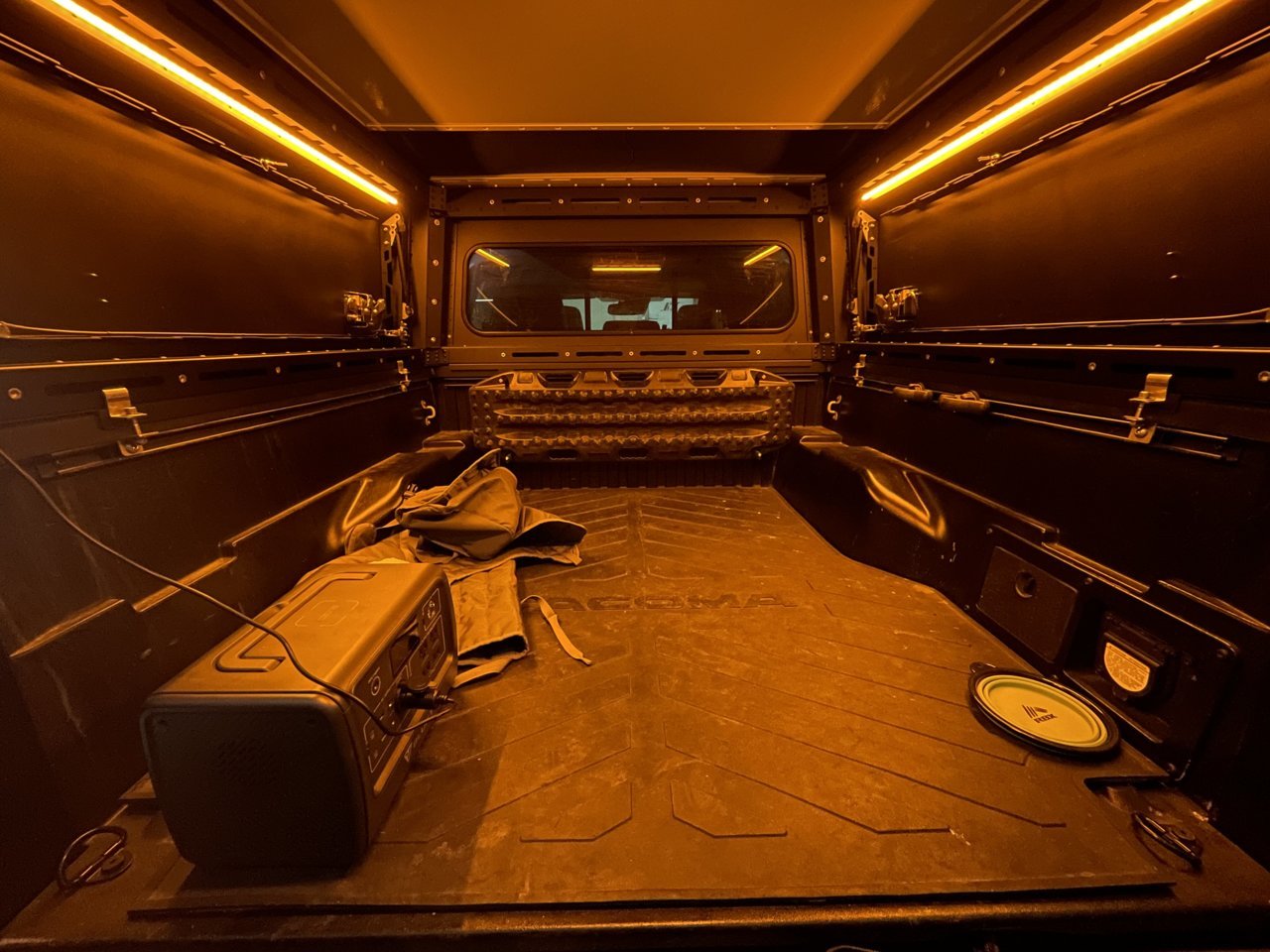

    Progress continues on the rear view camera install. Repositioned the 3rd brake light for now. I’ll probably go with a different brake light. Also installed the interior hard Korr lighting. They flicker when first plugging them in even if you have the lights set to off which is kind of annoying.

    The back of the 12v socket is pretty deep. I had to bend my connections to get a solid seal but even then i get it here and there. For the camera what me and a few others did was run the wire through the hole for the 3rd brake light then reposition it back into the original spot.
