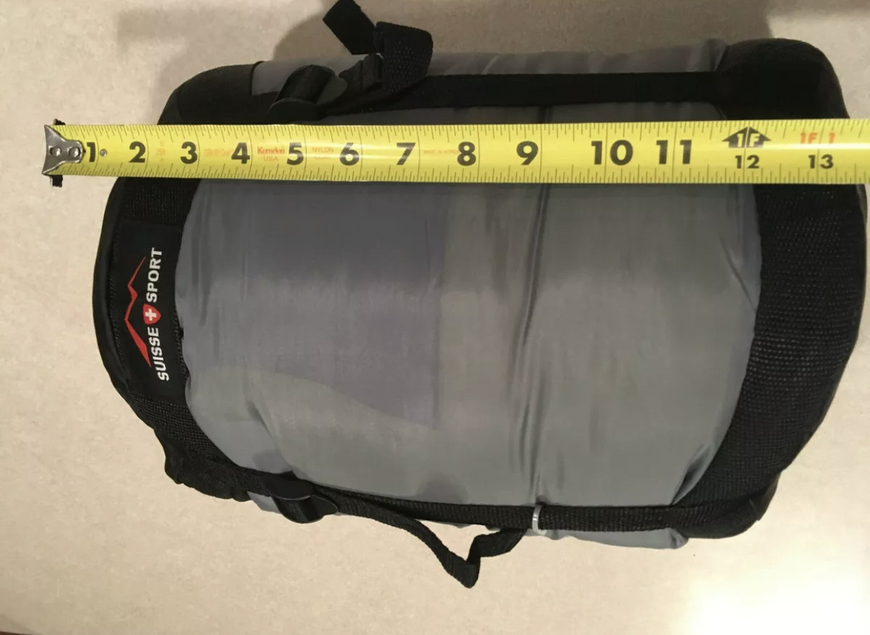

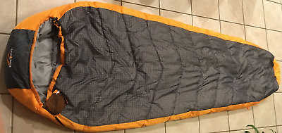

    Jeez my bad lol! Here’s info/pix I pulled online about the sleeping bags I store in the tent. Nothing fancy but they do the job.
    - Double-layer offset quilt construction eliminates cold spots
    - 100% Polyester
    - Great cold weather sleeping bag rated to +5 F lowest, ideal comfort range 20-40 degrees
    - 3 pounds of Hollowblend MicroTekk Z1 synthetic fill
    - Drawstring hood and draft tube; soft polyester lining
    - Measures 84 x 24 x 33 inches (W x H x D); weighs 5 pounds
    - Color: International orange & gray as pictured
    - Comes with a handy light compression sack for transport

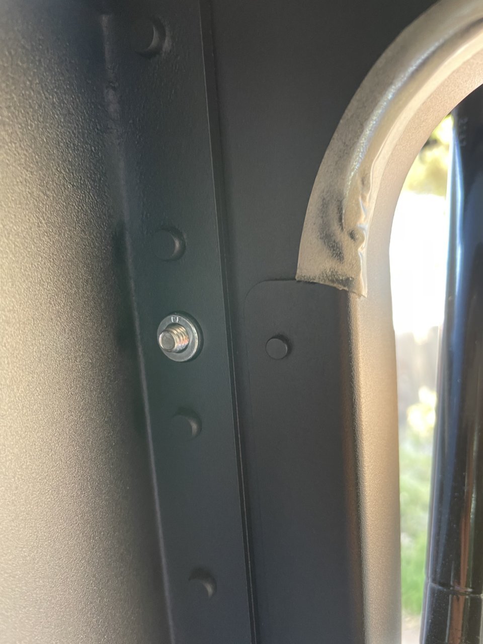

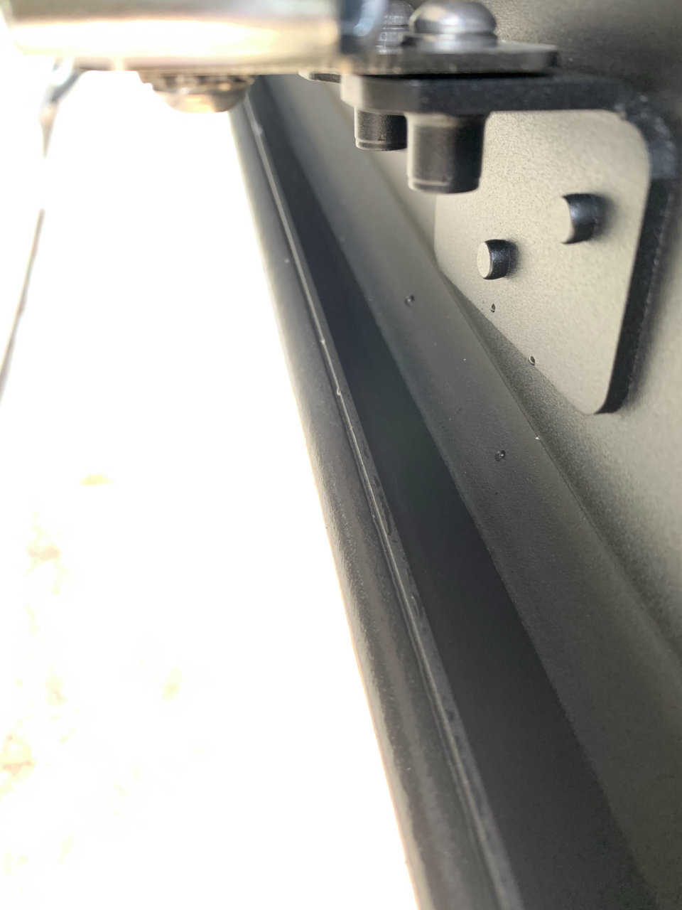

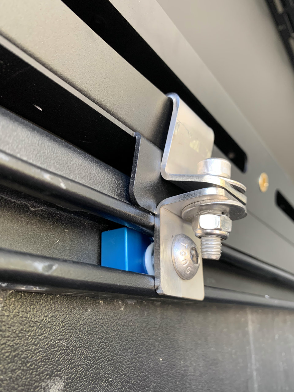

    Three things:

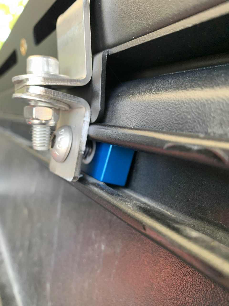

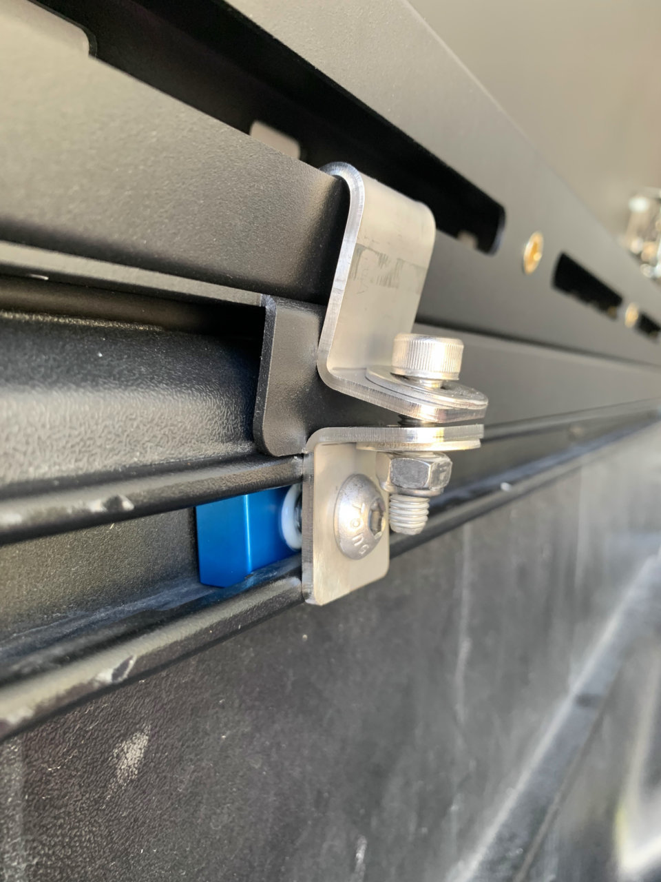

    1. On the topic of the clamps/blocks, I tried moving the block down (on just one clamp for now) to be flush in the bottom of the track and tightened it down pretty well. Feels a bit more secure, but I guess a solid bump could dislodge it. Curious if anyone has a take on this: pic 1 vs pic 2. Thanks

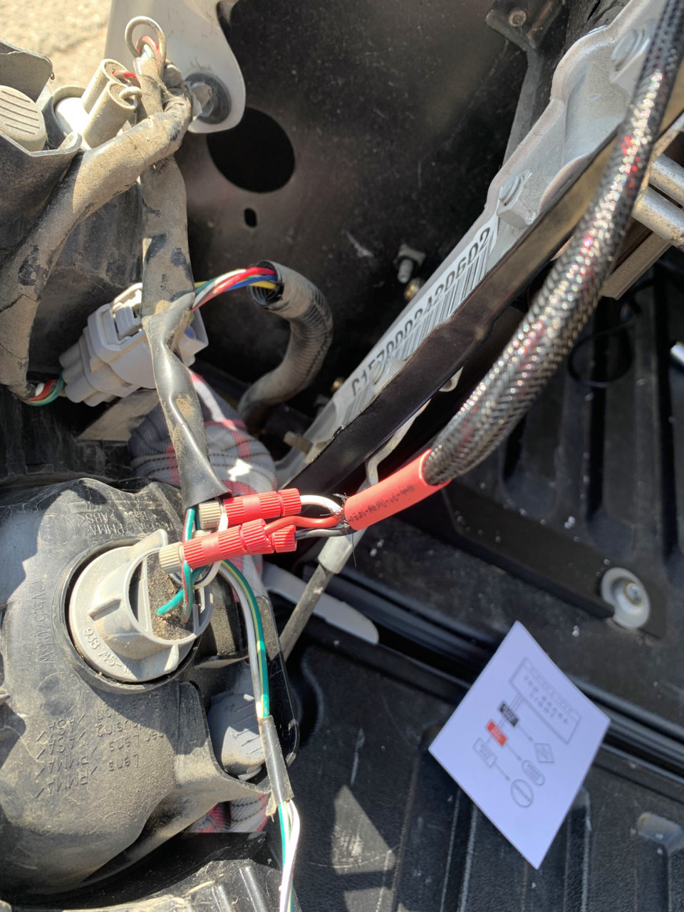

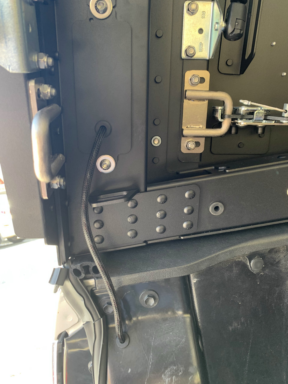

    2. Also finally got around to wiring the brake light. Postitaps made it super easy.

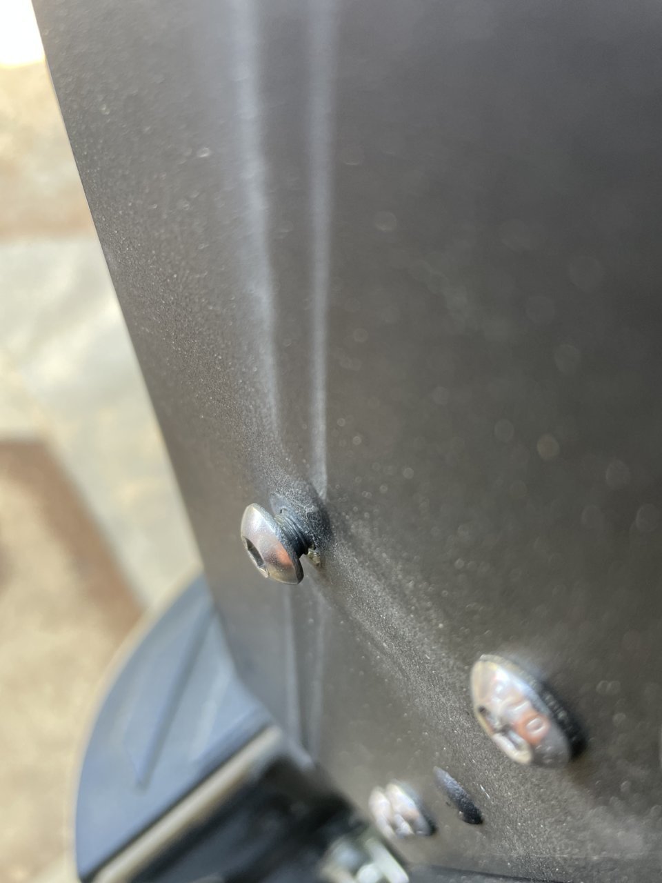

    I was giving the camper a once over today after lubing up my tent latches with BOSHIELD T9!!!
    And adjusting my door latches again I decided to make sure all the bolts were tight and noticed this guy backed out a bit.
    All of the bolts in the space frame that thread into a rivnut were loose enough that I felt the need to come let you all know.

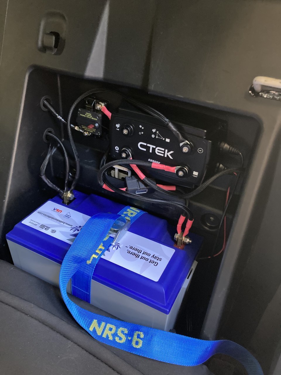

    Kind of off the SP topic, but here's how I set up my second battery in the cubby behind the rear seats. I attached the tie down straps with rivnuts like was recommended. It's been working great and we've been running a Dometic fridge and lights. I haven't hooked any solar up yet.
    I'm second guessing the whole idea of putting it back there and debating if I want to rip it out and move it to the bed. Maybe I haven't tied it down securely enough and it would be a heavy projectile in an accident. Also, maybe my wiring job isn't good enough and it will all catch on fire. When I came up with this plan, I didn't have a carseat back there. Does anyone have any thoughts?IMG_1406.jpg

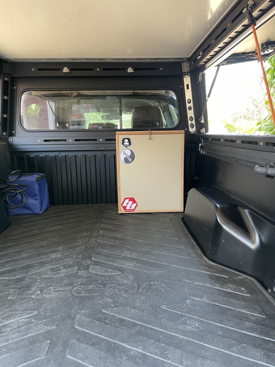

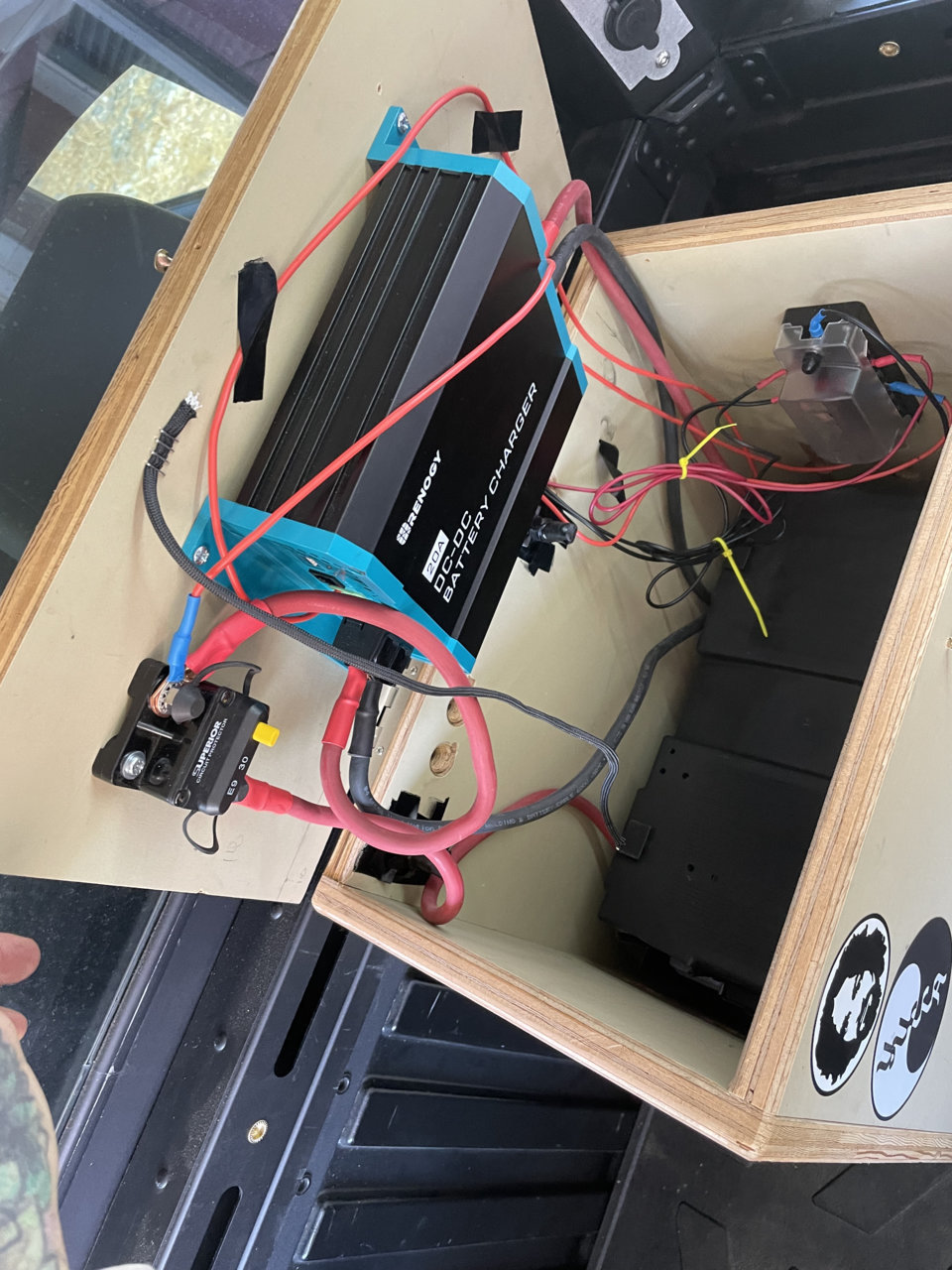

    I would love to have my battery there but I have an AGM battery until it kicks the bucket. I’ve redesigned my battery box 4 times and just ended up making a wood box yesterday and I should have kept it simple from the get go.
    Your wiring looks way nicer than mine, but there’s something to be said about the peace of mind that comes with having it in the bed of the truck and not in the cab.

    If it’s in the cab you might catch an issue way faster though (I.e. odor etc)

    Thanks, that's sort of what I was thinking of switching it to. I'm not so great at making things out of wood as you. I was probably going to use some kind of plastic box.
    Yes, when we camping last time, I sat back there so I could catch any issue. Not a long term solution though.

    You can totally do it. That’s like the second thing I’ve ever made of of wood. Skill saw, a level and 2 clamps is all I had to work with and then I borrowed a router from a friend to clean up the edges. I impressed myself.
