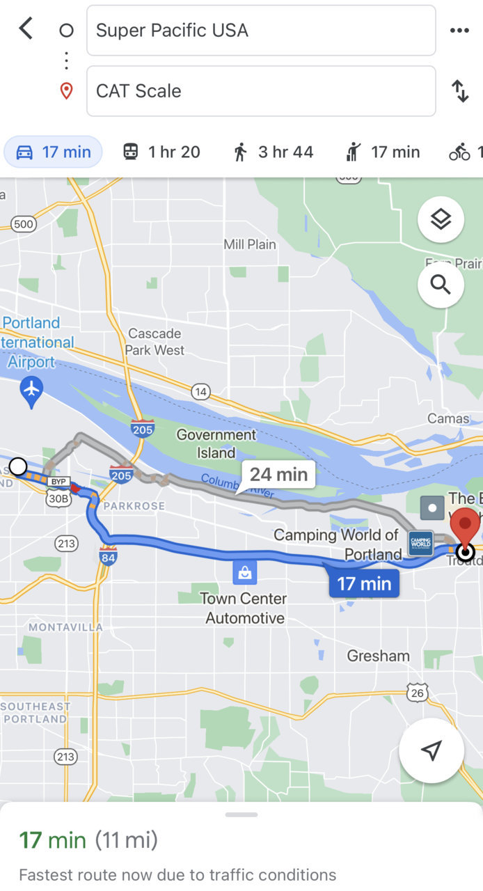

    One of the easiest is a CAT scale. Nationwide.
    Out here in CO it’s something like $12 for the first weigh and then $2 for a re-weigh.
    NOTE: they did not tell me that the re-weigh had to be within 24 hours for the $2 price.
    For ~17 min east of SP, it seems worth stopping first, then SP then back to the scale for the most accurate reading.
    If you want to get more specific, fill up the tank at Love’s next door right before each weigh at the same pump and don’t top off.

    I did look up CAT scales and found one in Aurora, which is on I-5 South; the direction I will be travelling from.
    Will do your suggestion of topping off just before weighing both times.

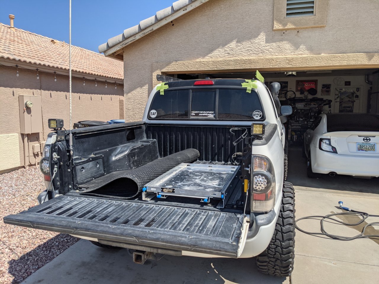

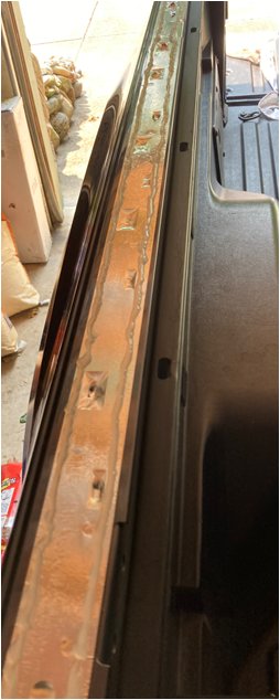

    Did more prepping for the camper this weekend. Removed bed rack and tent.. All the accessories on the roof rack. Removed roof rack to trim height. Gutted all my electrical, lights and wiring. Cleaned up the bed for the first time in probably 6+ years since the bed rack and tent lived on it. Need to seal the bed rails and other problematic areas. Ordered Butyl tape..need to order tailgate seal.
    For under the bedrails.. are you guys just pulling the rails and sealing under it? And with what? I guess I don't see the big issue with that area... More so corners and around the tail gate primarily. Again.. we aren't trying to completely seal this thing. We know there will be dust and we are accustomed to that so no biggie for us. Anything will be better than what we've been used to. Will be nice to have a "clean/dry" bed and storage area for once.
    Bringing in my Prinsu rack, Newly purchased bed mat, and some material to seal off the dumb little side cubbies in the bed to my work to waterjet everything nice and clean and precise. Bed mat will be notched to fit around my fridge slide.

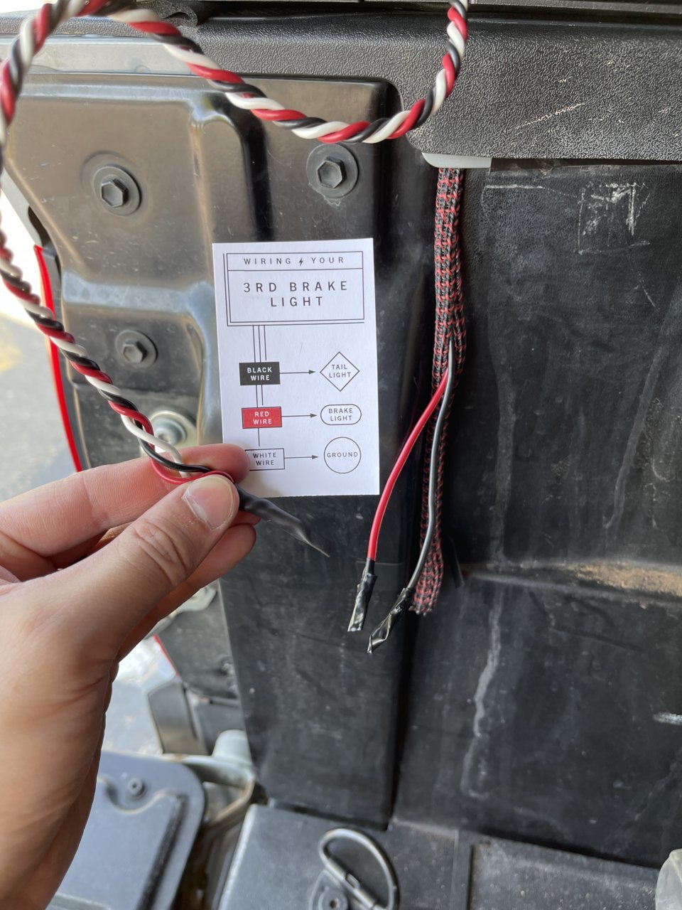

    Not sure if this was answered for you or not but here’s a pic. The wires in my hand are from the SP brake light along with a card they give you.
    justrussell likes this.

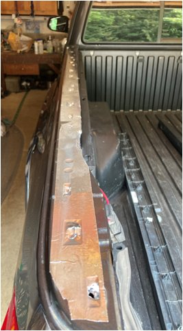

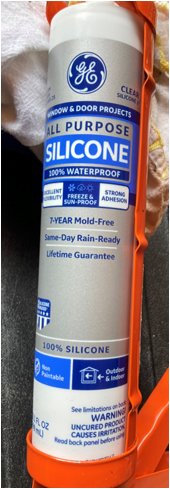

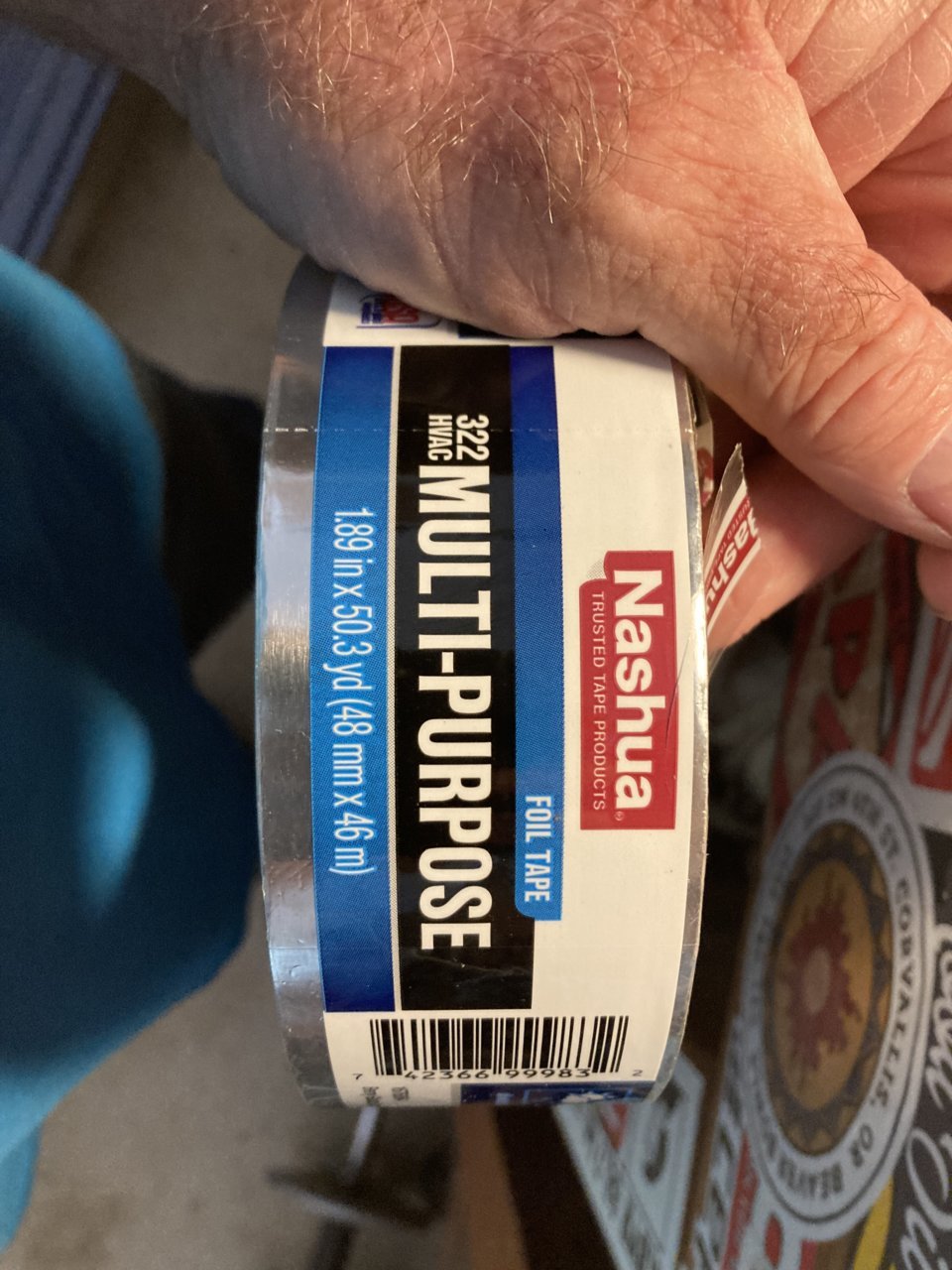

    I did the HVAC tape and silicone caulk on the side rails.
    upload_2021-9-20_18-22-17.jpgupload_2021-9-20_18-22-51.jpgupload_2021-9-20_18-24-8.jpg
    Used the butyl tape for the front corners

    Thanks for that picture.
    I did hear back this afternoon from Josh and he confirmed there's no connection/connector provided.

    ah-ha! thank you.. thats what I needed. I started trying to take the rails off the truck.. but like everything else on it.. the Az sun has taken its toll. They feel brittle and.. Meh. Was seeing how bad the areas were that needed to be sealed and what went into it to justify tearing into them or not.
    above is how far I've gotten on it. I can still get to them if I really wanted.
