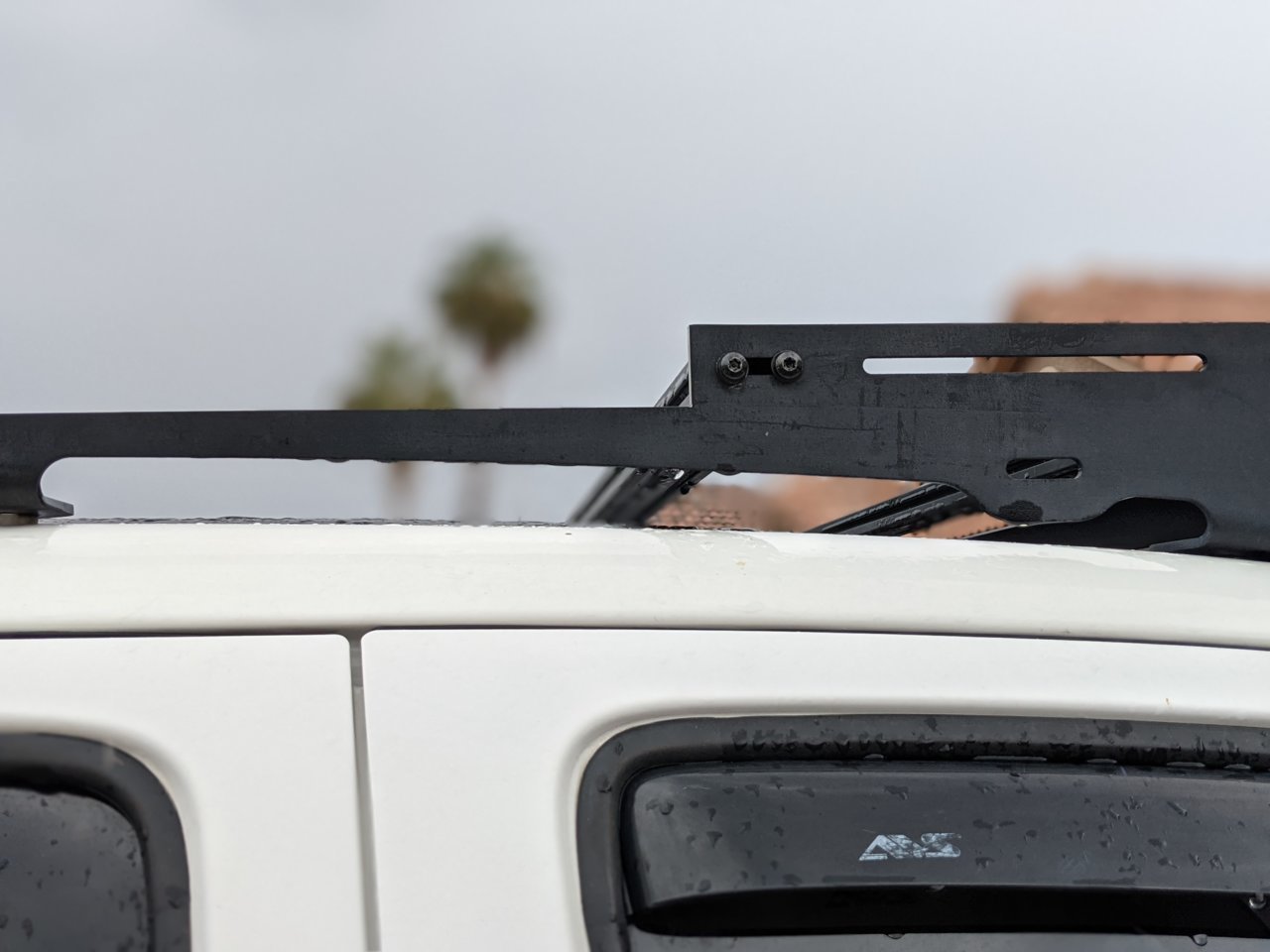

    Nice looks much lower on the rack. You should be good to go. Add the cross bars yet?

    Gonna be an armchair critique and say you should have radiused that cut lol.
    Bottom and top right angles.
    JasonLee and XPOTRPR[QUOTED] like this.

    Awesome. Good to hear. And not yet. Going to order those soon. Been ordering other goodies first.
    Hahaha. I knew someone would. I thought about it.. but we just manually sliced it real quick. I wanted max clearance as well and I think the sharp edge will match the SP decently.

    I held my tongue on that radius... but if you want to do all the things… I would have done more of a 110 degree cut and not 90 as when the truck frame flexes, any camper with an overhang doesn't move in a vertical plane.

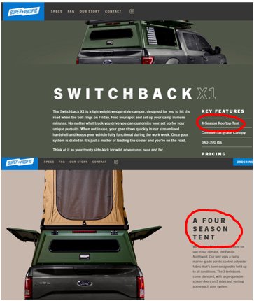

    So when I saw SP claims about a four season tent, I took the bait.
    Thankfully it appears that closing the tent with flaps closed can be done.

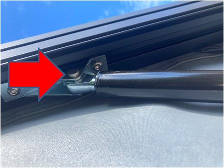

    It seemed that there might be an interference from the bracket that holds the top of the gas shock.

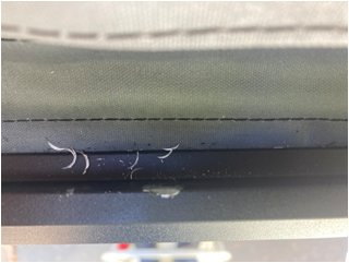

    I took a closer look and found this (looking down at the bottom rail):
    Saw it on both sides
    It appears that the pivot pin (name?) is catching the side rails.
    It's dug out a little gouge. And created the metal shavings.
    So I went to my engineering flowchart and found my solution.
    Cleaned the shavings, added some magic Boeshield to the bottom rail and sure enough, I can get it latched with all flaps closed and the floor in place.
    I may cautiously etch out a bit more of the bottom rail to make it easier.
    Still need to try it with the deflated exped.

    I sure hope these builds aren't getting sloppier as time goes on... Quality should always be priority.

    Good catch with the bracket/pin.
    I was going to say, loosen it and try to move it inward, or grind pin down if possible but you're in Oregon.
    Might be worth a trip for them to look at it to be honest...
    So far I've been affected by two issues.
    1. Sealing on my first gen bed
    2. The tent strut bracket pinching my tent. (similar to yours I think)

    I cut the rack with extra per @nudavinci64 and his setup.. and having to trim extra for the flex. I think it'll be good... And I didn't want Rads.

    Everywhere you drive, you will be judged for that cut. :boink:

    Hey.. it's cleaner than any others out there tho!

    no argument there. mine wasn't too bad but cant beat a machine cut. nicely done.
