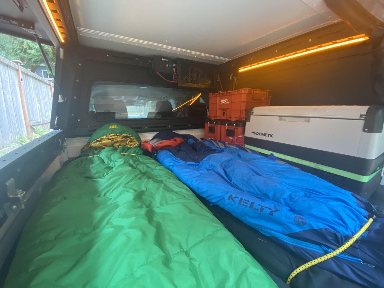

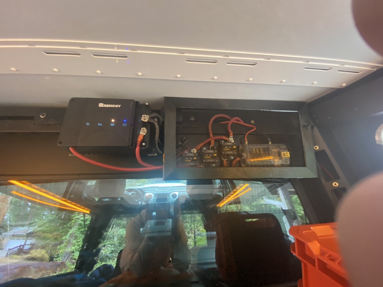

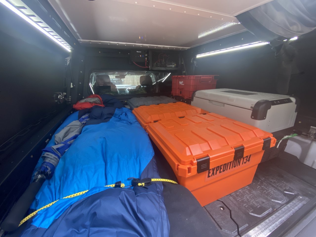

    A few buildout pics as it’s progressing.
    Includes home made kids beds, Renogy DC-DC charger and wiring, Hard Korr lighting, Milwaukee packout for battery and other storage. Beds stack to allow room in the middle for storage boxes.
    B7097C9B-8652-4B4C-9914-DC2F747B8D64.jpg E2C612F1-710A-4677-997F-CF6F2523F2D6.jpg ECA556D4-5642-4E69-AEBB-B910BBCD906D.jpg

    Are you charging off of your stock alternator? If so, how did you route the wires from the engine bay back to where you have the charger?

    Yes, running the positive cable down the driver’s side tucked up around the slider for the most part, and using existing heat shielding in certain places. Cable comes in through the passenger side bed grommet. Neutral runs through the same grommet but straight under the truck and grounded at the chassis.
