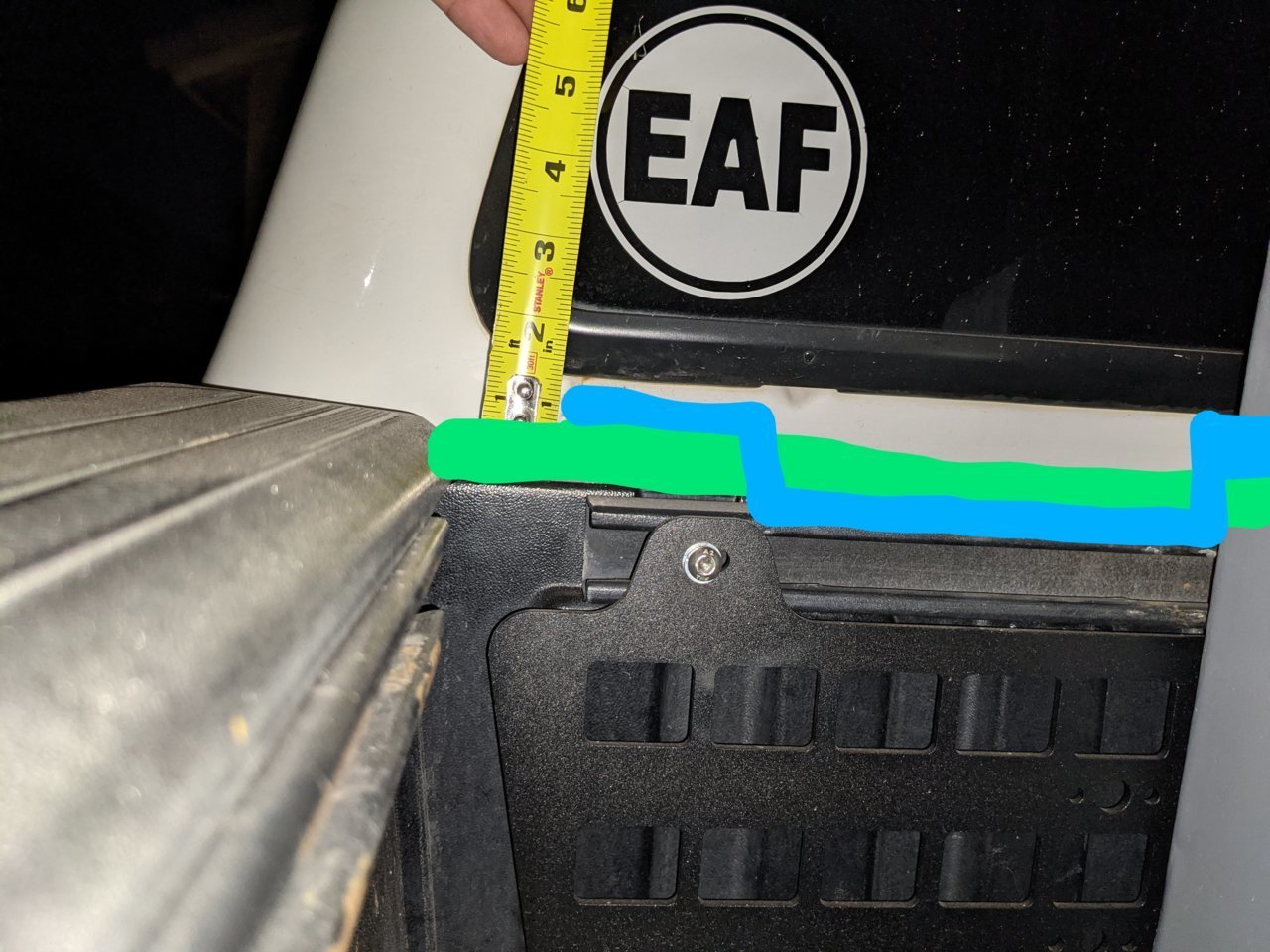

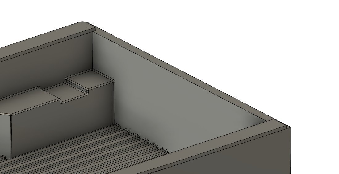

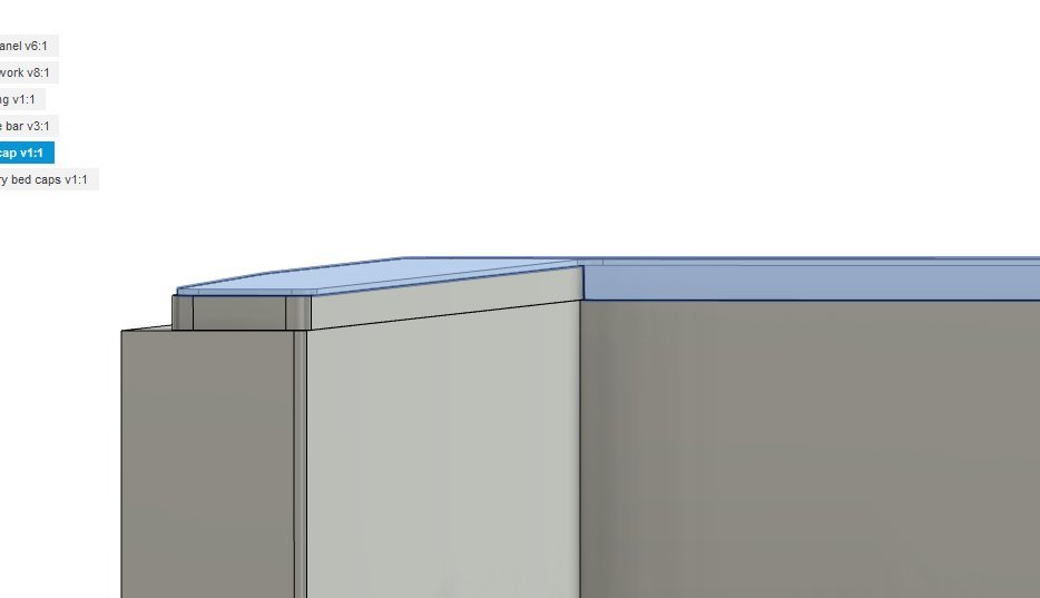

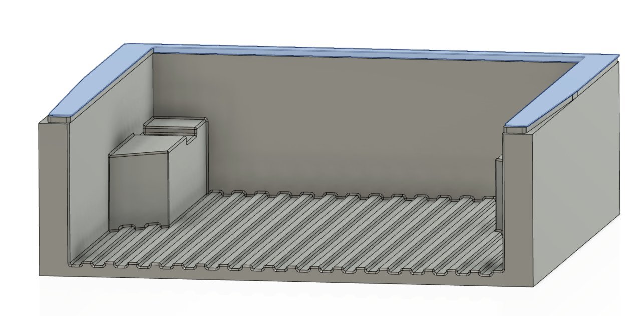

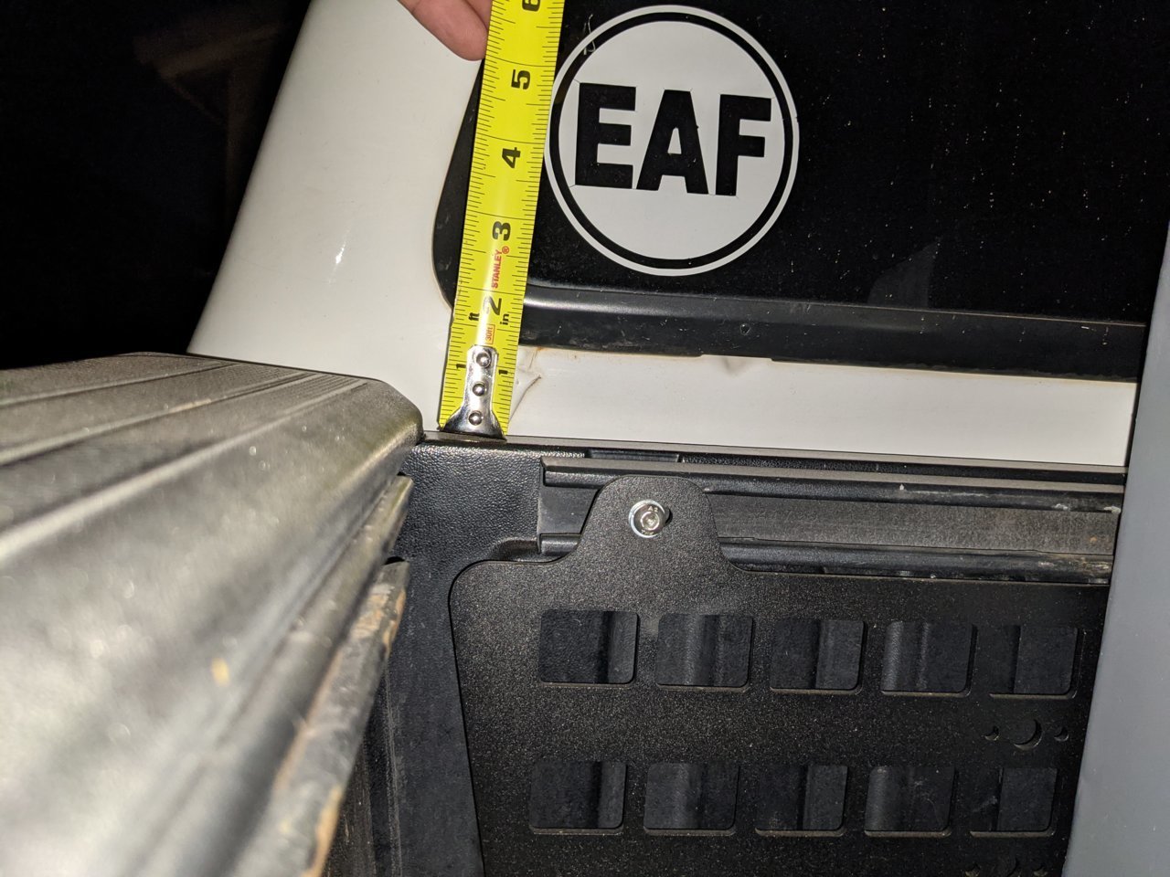

    So here's a breakdown of what I'm thinking for 2nd gens and the locating tabs of the X1 on the front side/cab side of the bed.
    Green is a solid bar or square tube of aluminum machined to fit across on the top of the bed. This would be hard mounted with hardware. The locating tabs of the X1 would then make contact with that instead of their starboard. That would keep the camper from being able to slide forward. It just needs something to catch it.. that's attached to the bed.
    I would then add a 1/8" thick sheet of aluminum along the entire top of the bed rails.. making a giant U... Making a nice even flat surface for the camper to sit on.
    Pretty accurate model of everything. Forgot I modeled the bed years ago... and glad I took my time and made it to the real deal. lol modeled the bed rails and my bed cap idea real quick.
    first pic is of the front of the bed against the cab. It has the factory bed with the factory plastic bedrails. note the height difference. (about .750")
    here's my idea for a filler. Aluminum square tube cut to fit between that gap (57"). secured to the bed. This is where I need to verify with them.. I can make it 1" wide (shown in pic).. so it sits behind the factory accessory rail (u channel).. OR.. make it 2" wide so it comes flush to the U channel. Making it 2" wide would allow easier attachment to the bed. drill holes in the top of the U channel and bolt & nut it with easy access through the front of the U channel. I just dont know if this will interfere with the X1. If I have to make it only 1" wide.. it would land on the 1" wide fiberglass bed portion all the way against the cab. this would mean it would need to be screwed in, or have some inserts installed. Regardless.. it would be attached to the bed and make for a solid catch point for the X1 tab.
    I'll go back and adjust for more detail if this is even worth it. I'll add the thru bores for accessing hardware through the square tube and show where they will bolt into the bed, etc.

    Does it not show the pictures? Total of 5. breaks it all down.
    but yes I agree.. bolting directly to would be preferred. I'm just trying to eliminate the problem of the camper sliding forward with heavier use. thats a big concern of mine. I know it will happen with how we wheel.

    now we're in business. Excellent! I like the idea. Any idea needed to be permanent of sorts. If SP had made that part don't he 2nd gen dip down and have a longer tab we would be in business but this def is a nice adjustment plus I assume we would swap out the plastic rails for new ones you modeled?
