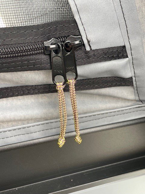

    I'm not that tall and had a hard time reaching the upper zippers on the outside flaps, so I made these for all of the zipper handles. The ones on the outside side flaps are longer than the other ones. zipper pulls.jpg So much easier now.

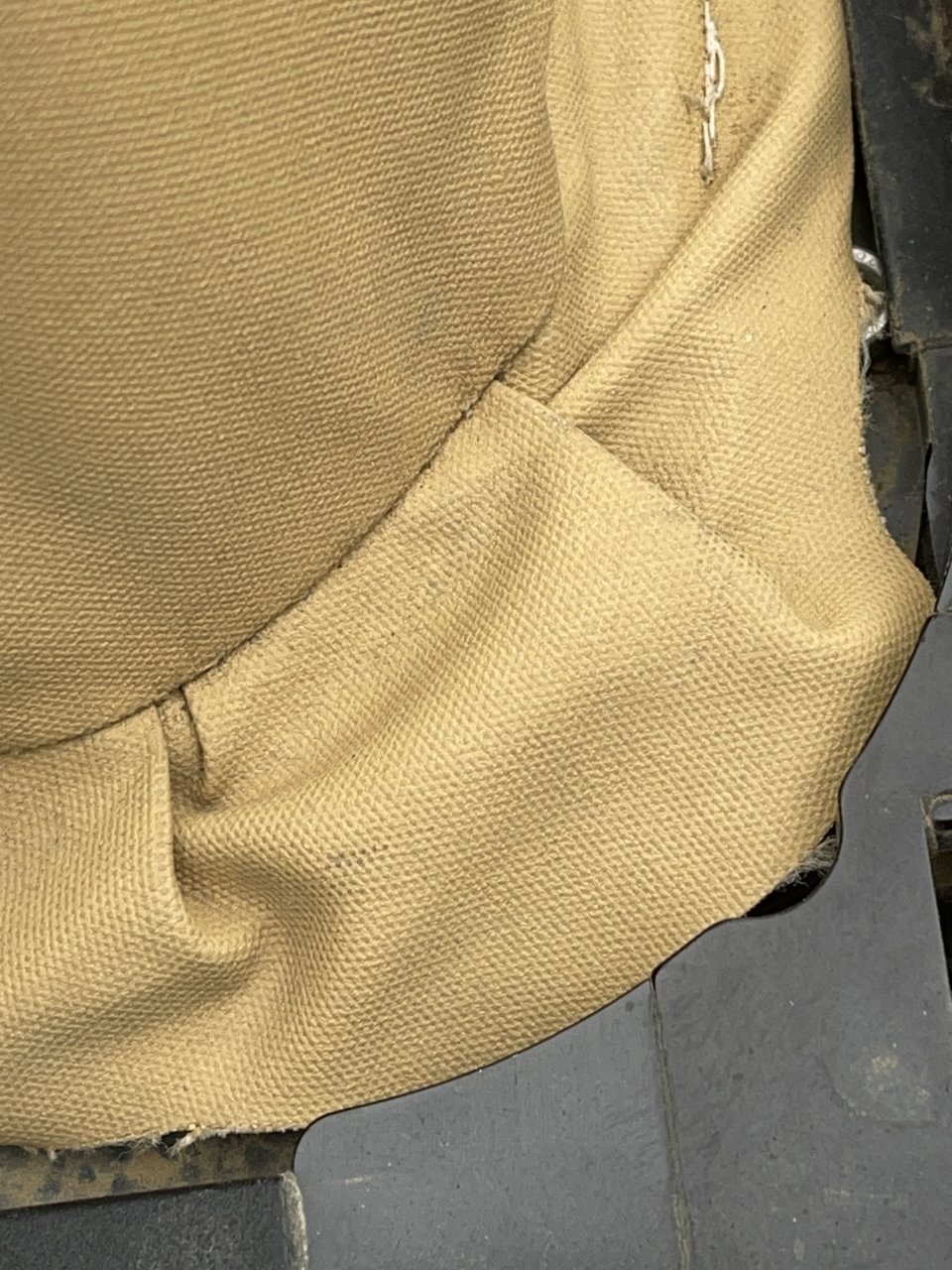

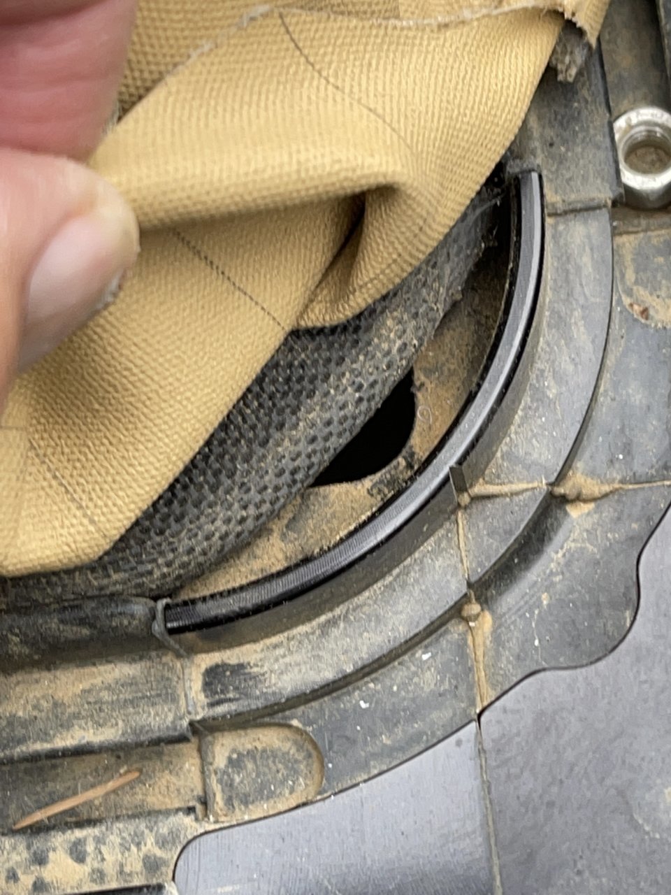

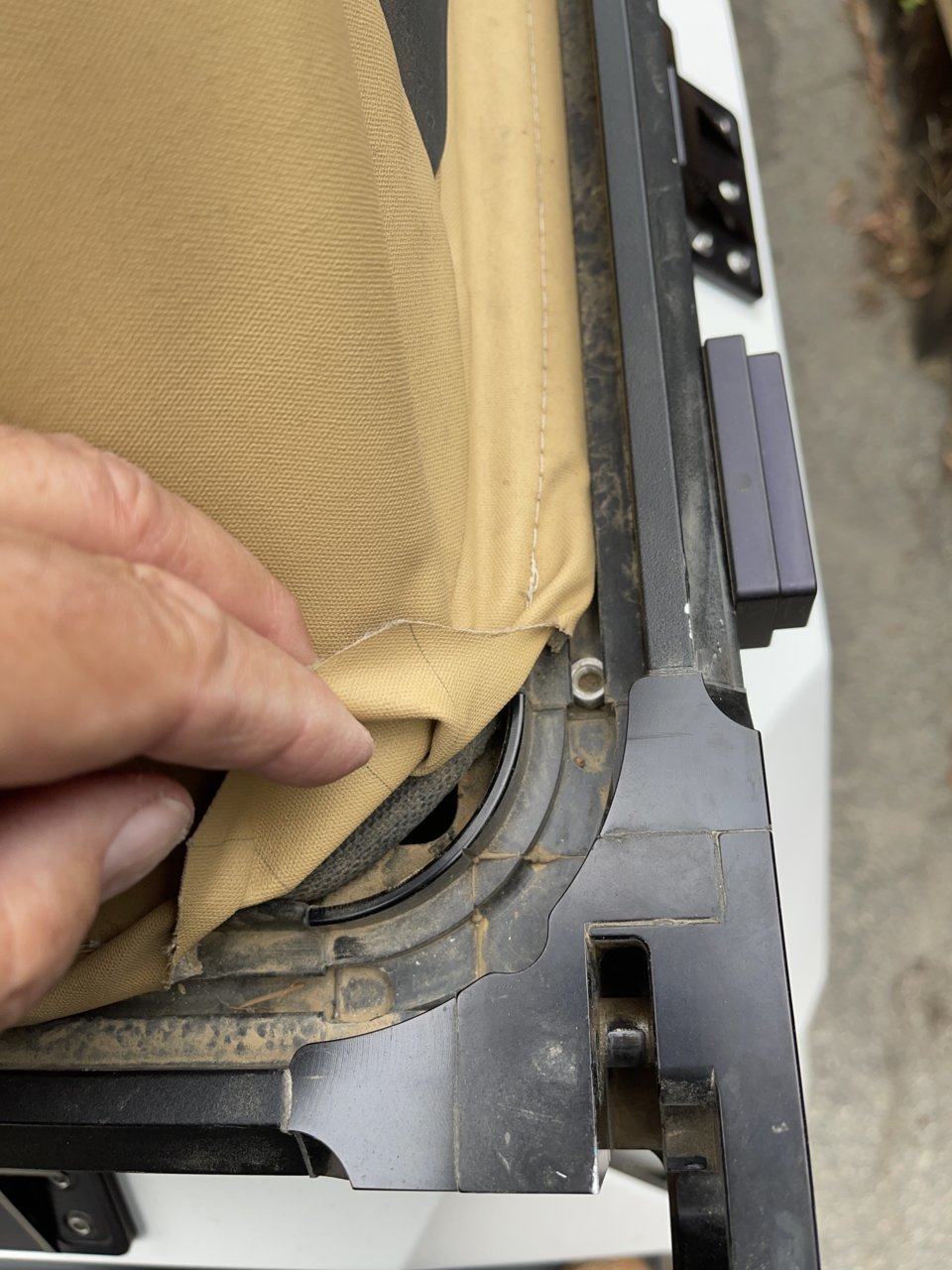

    I went and took a look at the corners again, lifted up the fabric skirt (no comments please) and low and behold there’s a fairly big hole where the keder rail turns. Leads right inside. If the rain is heavy enough or at the right angle it could easily splash up under the fabric and into the hole. Especially if the drain holes are clogged. I remember SP talking about a “corner piece” that they decided wasn’t necessary, so I’m wondering if this was it. You can see a couple of notches in the aluminum and a nut that they said they didn’t use but go ahead a leave it there. Anyway, I’m certain this is at least one of the sources of the water intrusion.9CD3FF72-D9A9-41C1-9D46-9C15FD60E6B3.jpg60434BE0-620D-450B-9FAB-BD90B83481A7.jpg2BCA04BB-1C81-4155-8198-D967F3A27AE1.jpg

    I sealed those holes, along with the matching ones at the other 6 corners (they exist at every corner of the tent), and it seems to have helped a little bit. I'm still getting a bit of water inside up in the mattress area, but I think it's just intruding along the black keder fabric line.

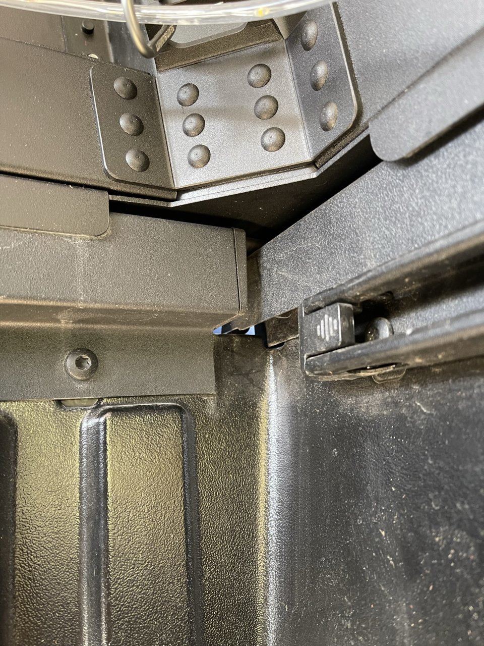

    Ahh I think I found my problem. Huge gaps I totally forgot about in the bed.. I had a little foam piece in the other side from my tonneau cover but this side must have fell out at some point, I added some butyl tape on both sides so I think its sealed up now. Going to test drive around tomorrow when its raining.

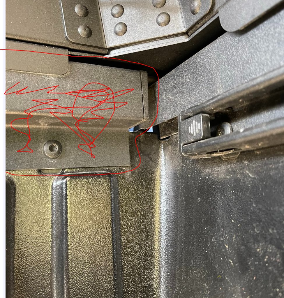

    I am curious now to look at a 3rd gen truck that upper rail deal that sits on the shell. @XPOTRPR that seems to be our missing link a bit (although prob higher than our trucks). Maybe that aligns with your ideas.

    yeah.. that whole circled drawn over block/plate/part... is what I'm trying to replicate for 2nd gens. see how that one is a hard stop for the X1 lip to hang over and catch on.. and that part is hard secured to the bed itself.. thats what I'm trying to do with mine.
