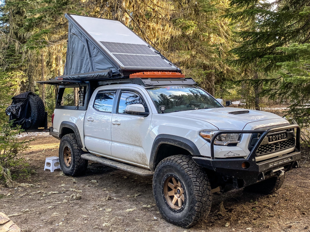

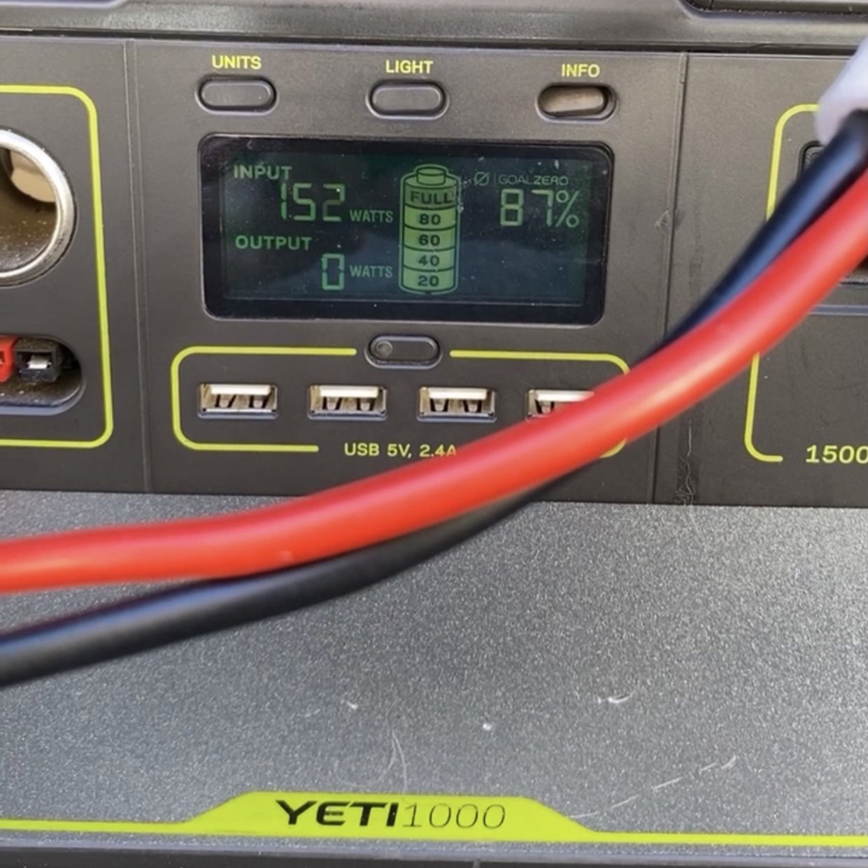

    I have (2) 100W Renogy flexible solar panels mounted with industrial strength velcro. They’ve been through 100 degree weather, lots of rain (I live in the PNW), been in strong winds, snow and been on the truck for about 7k miles with no issues. I even sat on them when I was up there doing something. I get at least 150+ Watts of input from them (when sun is optimal of course) according to my Goal Zero.

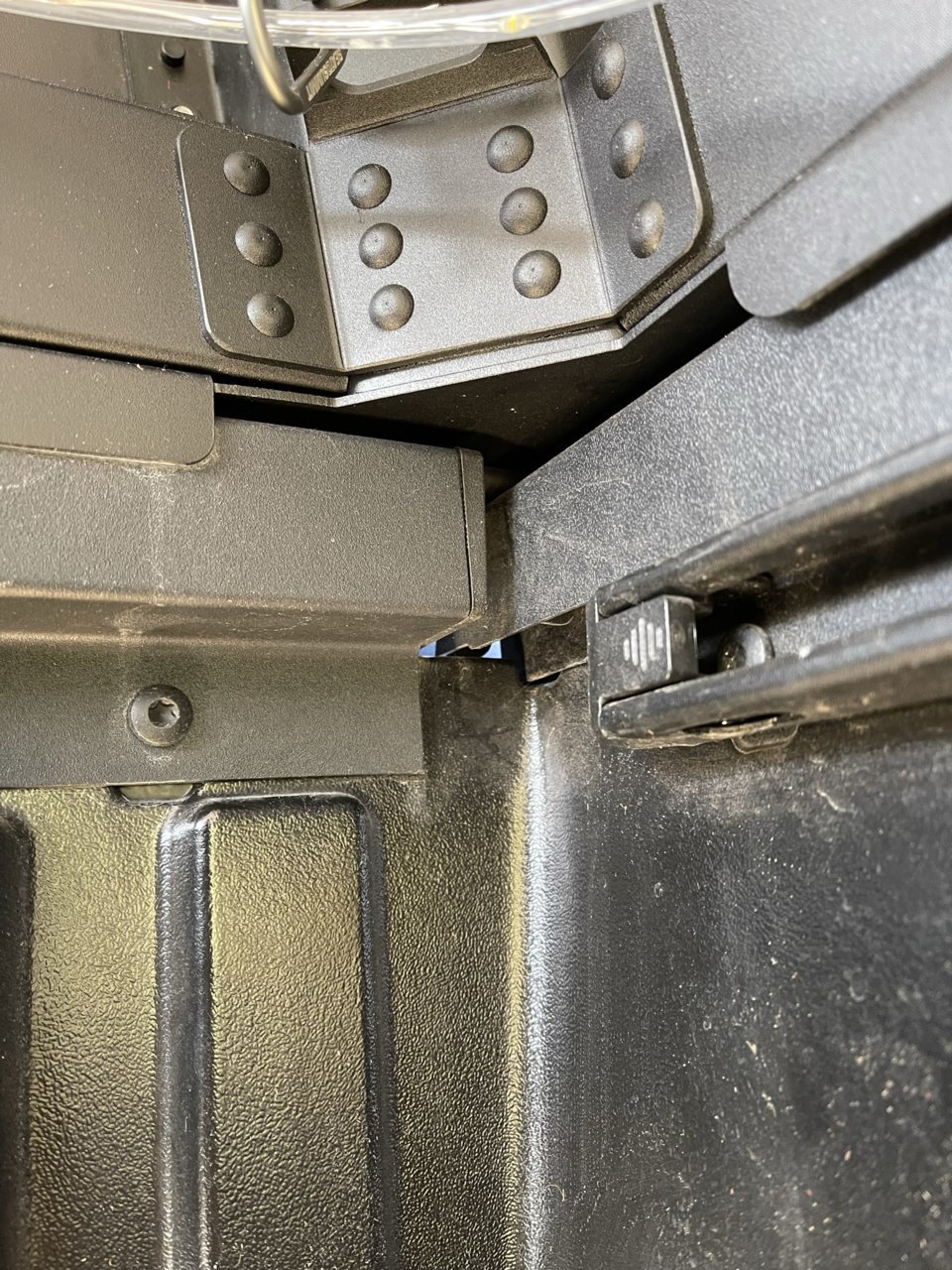

    3rd Gen cab side stop for reference..

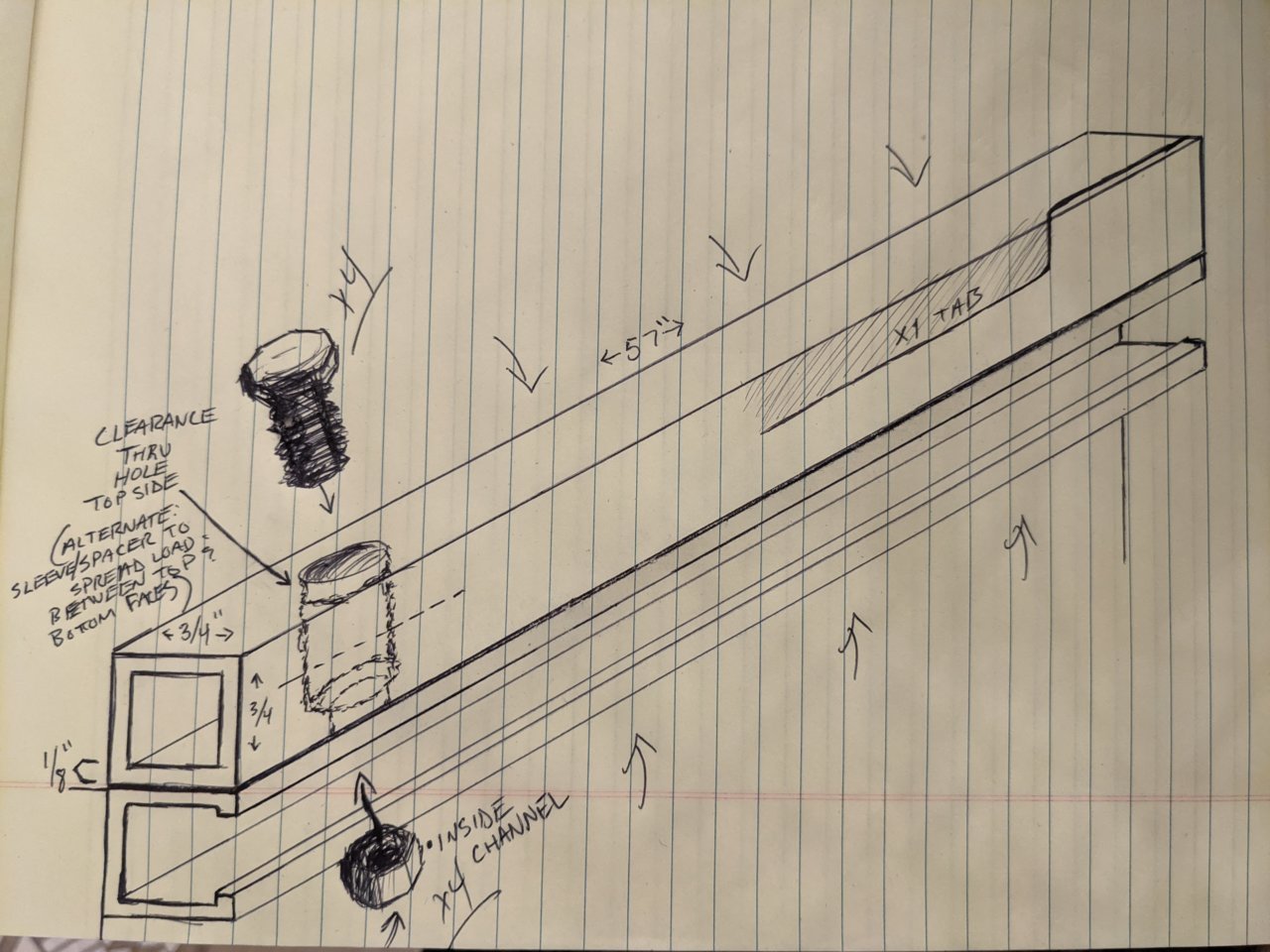

    My thoughts for a 2nd gen cab side hard stop.
    Clearance hole on top surface large enough for head of bolt to pass through and get a socket in there. It would go through the top of the cab side T-Slot channel, so that you could access the bolt and nut from the inside/underside. Was also thinking if it needed more surface area spread throughout that aluminum square tube.. that a sleeve could be inserted into the top.. then the bolt recessed inside so it still sits below the top surface. I think it would be ok without though for simplicity sake and still be enough to keep the X1 from shifting. At least at this point.. it's a hard stop just like the above pictured 3rd Gen. Essentially the same thing.

    Synergy, are your panels hooked up to the Yeti 100% of the time? I'm planning to install a 100 ah house battery that will be connected to a single 100 w solar panel. I don't have a lot of draw other than some LEDs and maybe a small pump for the mattress. thanks. Looks awesome BTW!!
