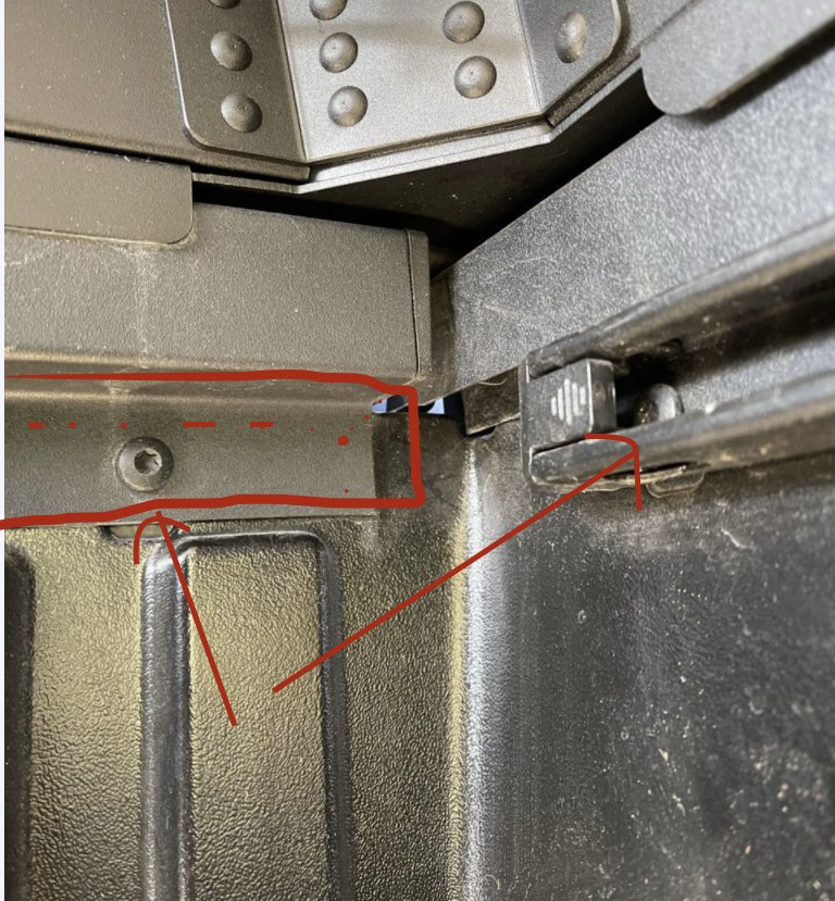

    What about using the front existing with an added brace with a lip. Curious if the 3rd gen has it in both spots. or even better use both top and side anyway. I like the top mount you noted but this would be good to keep it braced instead of all at the top.

    you're saying like a piece of angled aluminum essentially, hanging down like that so we can tie into the hardware already there for the 2nd gen T-Slot channel?

    Exactly. If you put the T-Slot over like in the photo given the existing hardware or maybe a slightly longer one that aught to be enough to keep the camper in place. Way better than starboard.

    definitely. I thought about that.. but was trying to be as unobtrusive as I could. but.. the more attachment points the better I guess right. I havent heard back from them yet.. I need to give them a call. 10 days away from heading out.

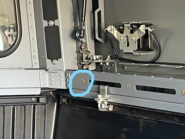

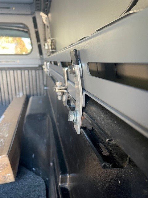

    I was working in the new camper today and thought of this idea to keep it on and from shifting. I have riv-nuts up front and in back on either side and can connect to a T-nuts in the side rails. This is just a piece of aluminum I had sitting around and cut it to an approximately length and drilled a single hole. I didn't have any M8 bolts for the T-nuts. I don't know what the strength of the M6 riv-nuts are, but couple this with the clamps seems like a really simple way to work this all out.

    Quick job as a mock up. The blue circle is the front riv-nut.shell clamp3_LI.jpg shell clamp2.jpg shell clamp4.jpg
    I'm a geologist, good at drinking beer, not an engineer, but I think this would work. Need a drill press, but I think you all get the idea on all 4 courners

    Def seems more secure then what the gave us

    Icon Stage 3 suspense, method rims, KO2s, shell
    I agree. I just don't know how strong the riv-nuts are. I sent an email to Peter and Josh with that question. If you add these with the clamps it should be golden and spread the force around.

    @Taco-Surfer I like that! Simple and effective. Should be able to do the same along the front and in theory.. would act, or at least help, as a hard stop to keep the camper from shifting forward towards the cab. Right? I'd still like a better filler than starboard (I still might just use some square tubing to fill that section along the front of the bed) but then doing this too.. I'd at least feel more confident in it that it's not going to move.
