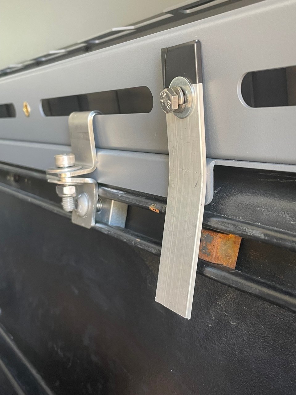

    57" is what you need! Was going to go with 3/4x3/4 OD and 1/8" wall. Mcmaster was out of what I was going to order when I was looking the other day. I havent checked Locally yet. I was waiting to hear back from them.. I've sent 3 emails with some screenshots and other info to get the idea across. I was worried I wouldnt be able to do anything after the fact, and was rushing to get it sorted before we head up next weekend, but it sounds like you may be able to mess with it afterwards from what you're saying?

    I agree. That's why I want to try 3/4.. then shim it essentially to fill the rest. The other benefit of doing this imo.. and going full length especially.. is that helps seal that front section. Only areas would be the front corners where square tube and bedrails meet. Fill with butyl tape and I think it would be good. Solid and sealed.

    This is exactly what I was thinking with my post earlier, but used on the cab end of the camper to try to keep it from shifting at all. Looks good!

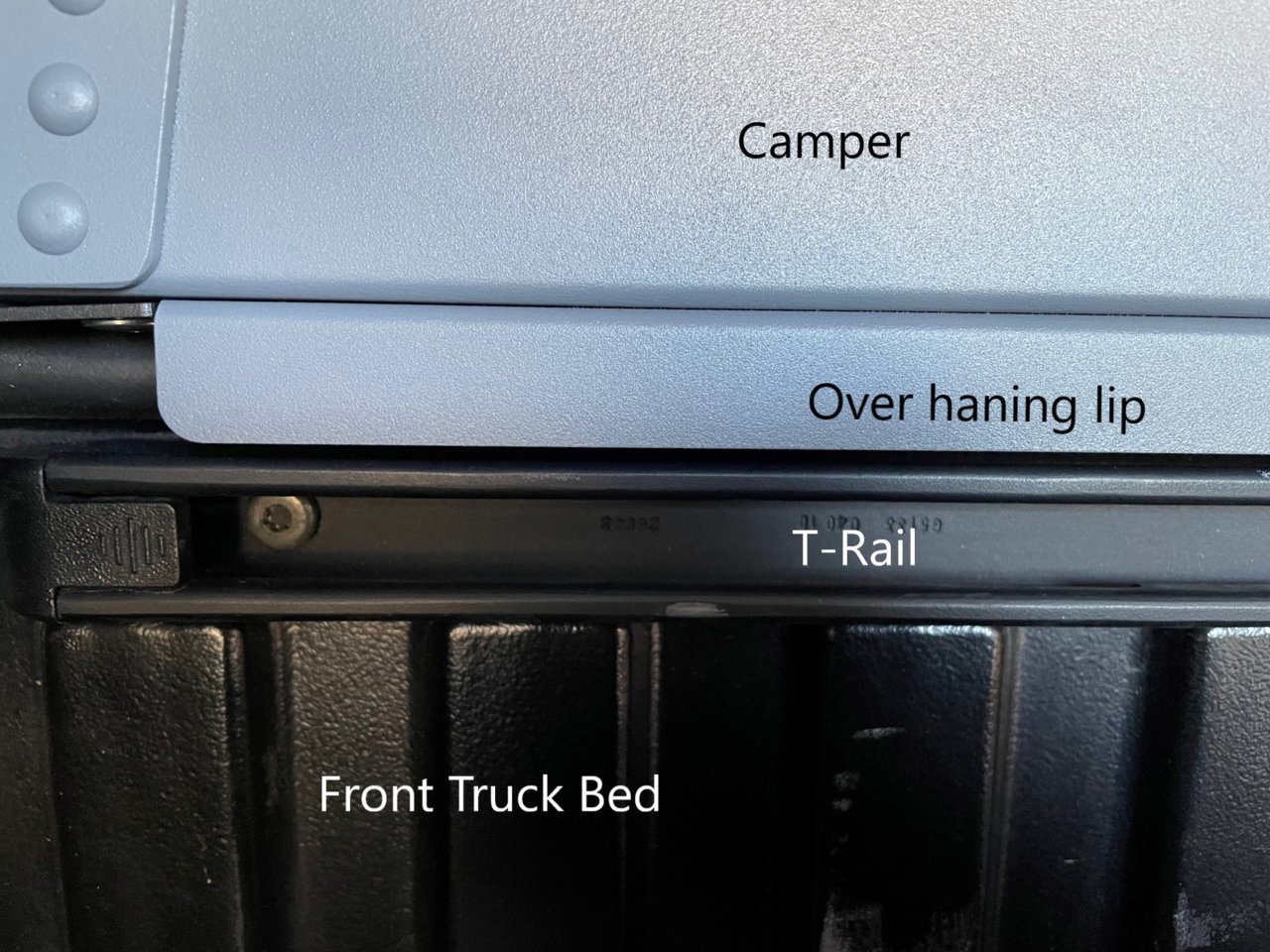

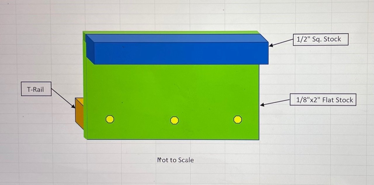

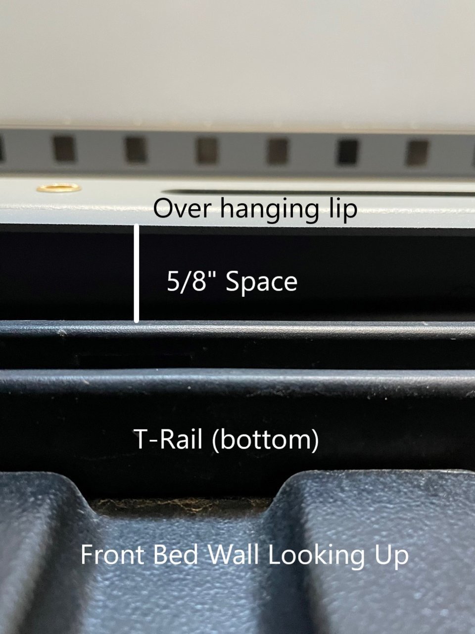

    I measured out the front of the truck bed for "my" camper, so the dems may be different for others by a slight bit. There is an overhanging lip that is 5/8" wide from the front of the T-rail to the lip. This is the inner dem as best as I could get. This over hanging lip runs the length of the front of the camper, and is what the 3rd Gens have butted up against the front bed wall. From the bottom (underneath) of the overhanging lip to the bottom of the T-Rail is 2". An option to fix this is to use a piece of 1/2" square stock connected to a piece of 1/8" x 2" flat stock. Connect the flat stock to the T-rail with T-nuts. Here are some photos; looking straight ahead at the front bed wall and looking up underneath the T-Rail and overhanging lip. I've also added a couple of sketches using Excel.
    Bed Front and Camper Lip+T-Rail.jpg Looking Up under T-Rail and Camper Frame Lip.jpg
    I think the drawing on the far right is like your idea.

    yesssss!!!! It sucks not having the X1 in hand to do all this.. but this is why all you fine people are awesome. TW community FTW.
    Thats what I was wondering.. what kind of space we have to play with and if that idea could be done. So yes.. that last pic (right one?) showing the 1/2 square stock and the 1/8" flat stock to connect to the T slot is pretty much what I was thinking. That.. or go down through the top of the T slot and possibly eliminate the need for the 1/8" flat stock.
    Does it seem possible to do that? If the bolts were recessed into the square stock. reason being.. I would prefer not to alter that slot and push it out.. even if it is just an 1/8".. I have my All Pro Molle panel and water tank up against that slot already and the mount utilizes the Slot and its position.

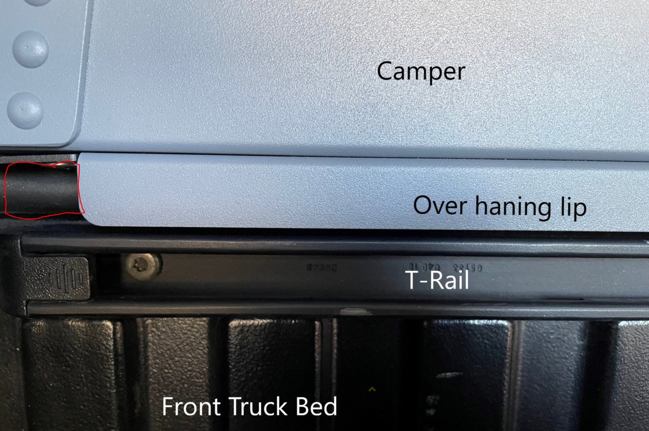

    > BUILD LINKS >
    what is this section? the bulb seal for the X1? That essentially is where the square stock would be, correct?

    Yes, that is the bulb seal. Per my drawing the 1/8" flat iron would extend up there with the square stock at the front butting up into the space from the over hanging lip. IE: The blue 1/2" square stock in the 2nd drawing would fit up underneath the yellow Overhanging Lip of Shell in the 1st drawing.
    At HD I got steel square stock and flat iron instead of aluminum and will get my son to weld it. I may also go get a piece of 1"x1" to put behind the flat iron to butt up against the bed. But I don't know if there is enough back there for it to butt up against.

    I see what you're trying to do...
    The bold is what I'm trying to fill/figure out.. kind of a two in one thing. It should really be like 1/2" x 2" square then for what I'm trying to do. I want to make a stop (basically what you're talking about, but mount it in the top of the T slot) and it will extend forward over the bed as well. This way it fills that gap where your bulb seal and starboard is (the front of the bed where it sits lower than the sides).. and also makes a hard stop for the X1 tab.. in theory anyways.

    I agree with you. I'm unfortunately late on this. But, if you do what you have thought up, I think using my Dems can will work for you. The overhang extends out 5/8" from the T-rail. So whatever you can fit in there to make that meet up I think you're golden. I like your idea as you can seal the whole thing really well and have that hard stop.

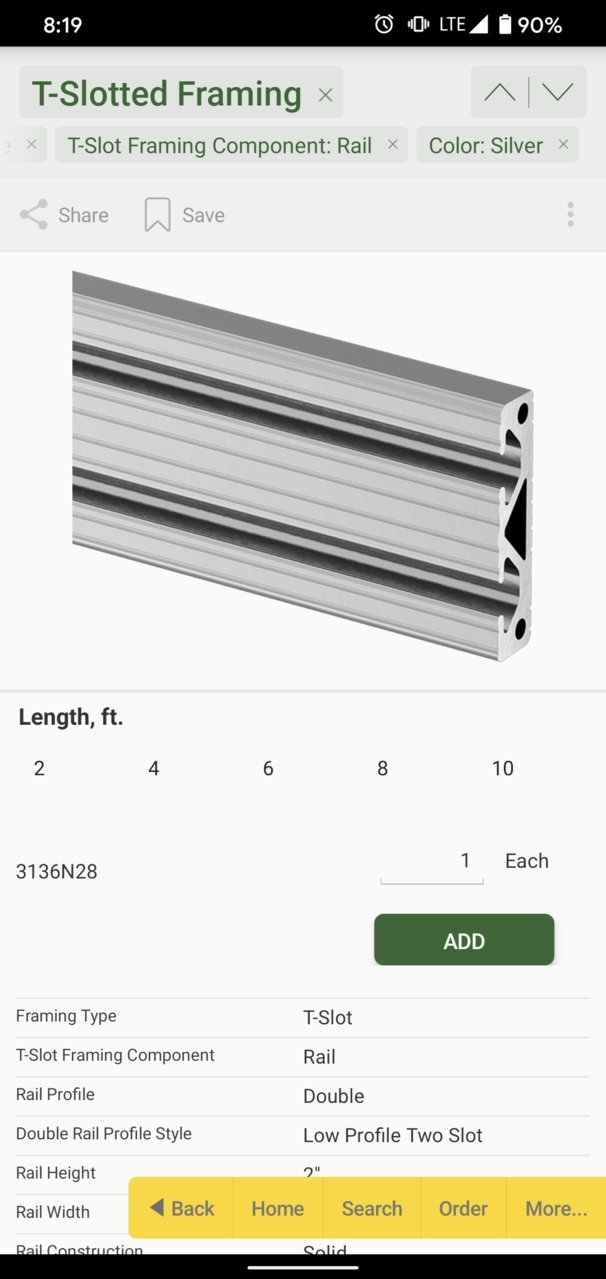

    Right on. Ok, so trying to order materials for this project. I was going to order 3/4" x 2" wide bar stock, but you're saying the lip overhangs away from the t slot another 5/8".. so I either shift the 2" wide stock that way to compensate.. or go with wider than 2" stock.

    Also ordered a couple of these to see if I can fit them on the Prinsu to help stiffen it up.
