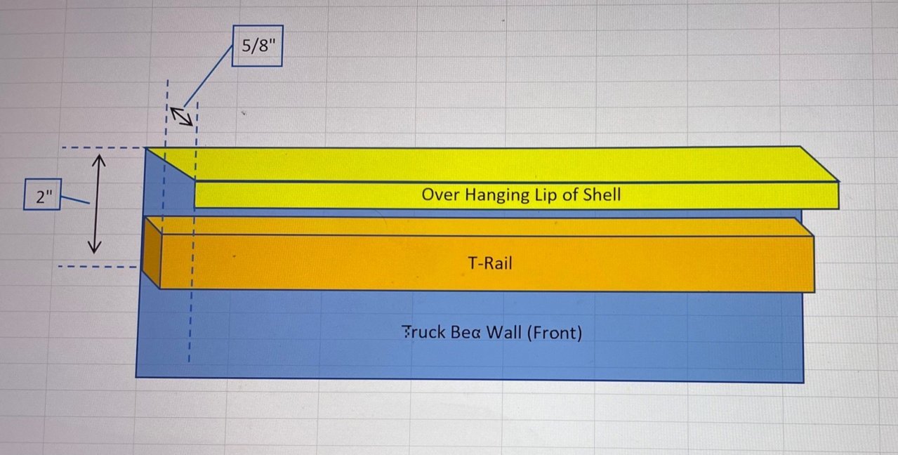

    No problem at all. IMO, the measurement of 5/8" from the T-rail to the over hanging lip(see below) is the important one so the over hanging lip butts up against whatever support you put there. I think the T-rail is 1" wide from the front bed wall to the edge. So if you install a support on top of the T-rail extending to the over hanging lip it needs to be 1-5/8" wide. I have just a 1/16" of play it seems so if you went 1-3/4" I think you will be ok. Remember, this is all based on how my camper was installed. So if you're close to this it seems you should be ok.
    Just so I am clear, the 3/4" x 2" wide bar stock will sit on top of the truck bed wall (near cab) and extend to the rear (towards tailgate) or on top of the T-rail? Am I seeing this right? Maybe sketch something up.

    perfect thank you. that's what I was wondering.
    and yes.. you have that right.. the 3/4" x 2" (now going to be 2-3/4" wide) bar will be on the truck bed wall near cab.
    working on a quick sketch now. Work is too busy... even though I have all the necessary software and can make a nice model.. a basic hand drawn sketch is always easier. lol

    Ordering both 2.5" and 2.750" wide by 3/4” thick bar stock.

    That's what I thought. should work. Run it by Spence/Peter and Josh to make sure.

    Agree! If everything is level, top of the side rails to the front rail, seems like it's a sound idea and will work.

    That's my thinking. I'll add 3M and or Butyl tape in the small gaps that will inherently be there after the fact... to help secure and seal. Between that and the solid bar.. it should help to make a nice seal for sure.
