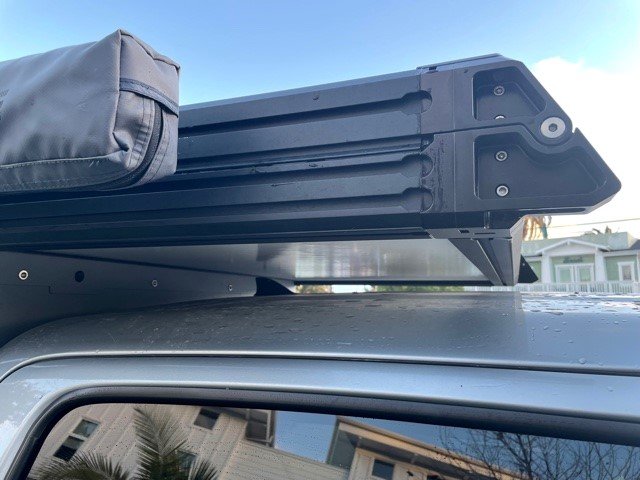

    I know somewhere herein this has been discussed a bit, but has anyone come up with solid ideas to prevent the running of the water into the back seat. I've seen L-bracket, GFC mods, someone made some out of sheet metal... TIA

    the GFC mod is about the only thing so far. I think only real options are redirecting it to the cab or closer to the back of the cab. id be open to others but only ones I have seen.

    Is the drip issue mainly when the top is up, down, or all the time?
    Searching on Amazon and Ebay comes up with a number of stick-on drip rails. Maybe some one with an X1 could look at those? I don’t have mine yet, so not knowing the details of the issue, that’s the best I can come up with.
    Best of luck figuring it out!

    The drip issue only occurs when it rains with tent down since it overhangs a little on the side.

    In that case, it seems like one of the stick-on drip rails stuck to the extrusion and slanted down a bit toward the back of the door might help. It should work like a gutter.

    It def happens when it’s open and up. just a placket that’s inevitable without some add on. Just went though it over the weekend.

    I’ve had a similar issue with every cab-over camper I’ve had. Adding side stick on gutters helped, but never found anything reliable for the front. Wifey always hated getting in and out of the cab in the rain.
    I don’t think any pickup in the last 20 years has had a rain gutter.

    My bad my poor choice of words. I shouldn’t have said only when it’s down. I should’ve said it does it both when the tent is up and down. It rains a lot here in the PNW so I notice it more going in and out of the truck when I do drive it.

    I've speculated here before and I'll say it again...
    A roof rack that is extended wide enough to catch the water from the camper overhang. Channel the water toward the center of the cab roof where it will then hit the gutter rails (aka roof rack mounting area) and run to the windshield or behind the cab.
    I haven't bothered prototyping anything yet as I am still considering what this means during snow and ice. Currently not having any rack allows me to easily brush the snow off.

    It doesn't help that the extrusion drains out the front corners - that said, I bet someone could CAD up something similar to the drip cover for the GFC

    It's hard to solve for all use cases... The overhang mounted ones like for the GFC would be fine outside of freezing, not sure how it would do when the water turns frozen as it's dripping into it.
