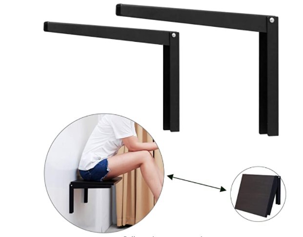

    I think this Welland hardware might be the ticket. You could mount some box tubing vertically inside the bed that the Welland hardware would just drop into. When you want to swap direction, lift it up and turn it around. When not in use, fold up the hardware and secure the table surface to the door with some bungies.

    The idea is to create a surface where you can put a stove and other goodies when your cooking inside on a miserable day. I don't think it would be a very good seat. You are better off with short folding chair inside the bed if you want to sit.

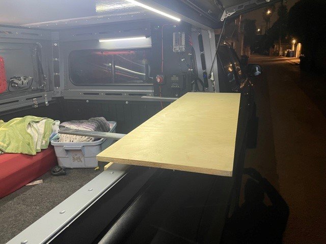

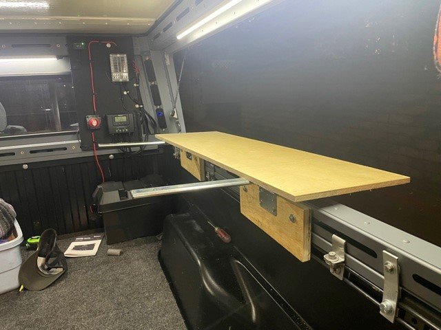

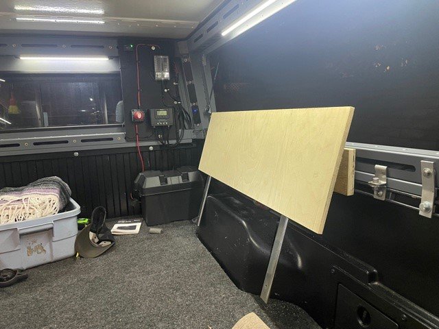

    @DavidS The door storage idea is interesting. The slides I have can go both in and outside at this time, I believe. The system I have with wood is a beta and I need to do some cutting of the slide to see if it will work for the inside. Another why is a simple hinges so a table could fold up from the wheel well. One would need a support under the table or use the idea of the Wellland Hardward with a longer piece bolted to it. That's kind of small in size IMHO. If those down piece could fit in a square stock, then it may be removable and stored in the door, if the size is right.

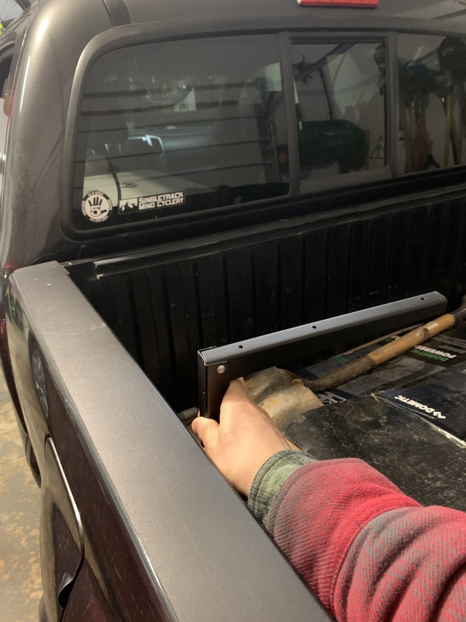

    @Taco-Surfer The Wellland hardware was only $10 for a pair so I rolled the dice. They are way more solid than I expected and don't flex at all. The size seems about perfect for the 12" wide table I'm planning. The only hitch is that they don't actually form a perfect 90. I'm not too worried and expect I can get it dead level by using an 1/8" shim on one end. The trick will be finding a piece of stock with a 1" interior dimension and securing it so it won't flex with weight on the table.

    A 1.5" inner diameter pvc or other pipe would probably hold a 1" x 1" square tube fairly well if my math is correct. Too wide and you could wrap tape around the square tube to snug it up. Too small and you could grind a bit off the corners of the square tube. The pipe could be attached upright quite easily. A 1.5" outer dimension stock would also be close depending on thickness of material.

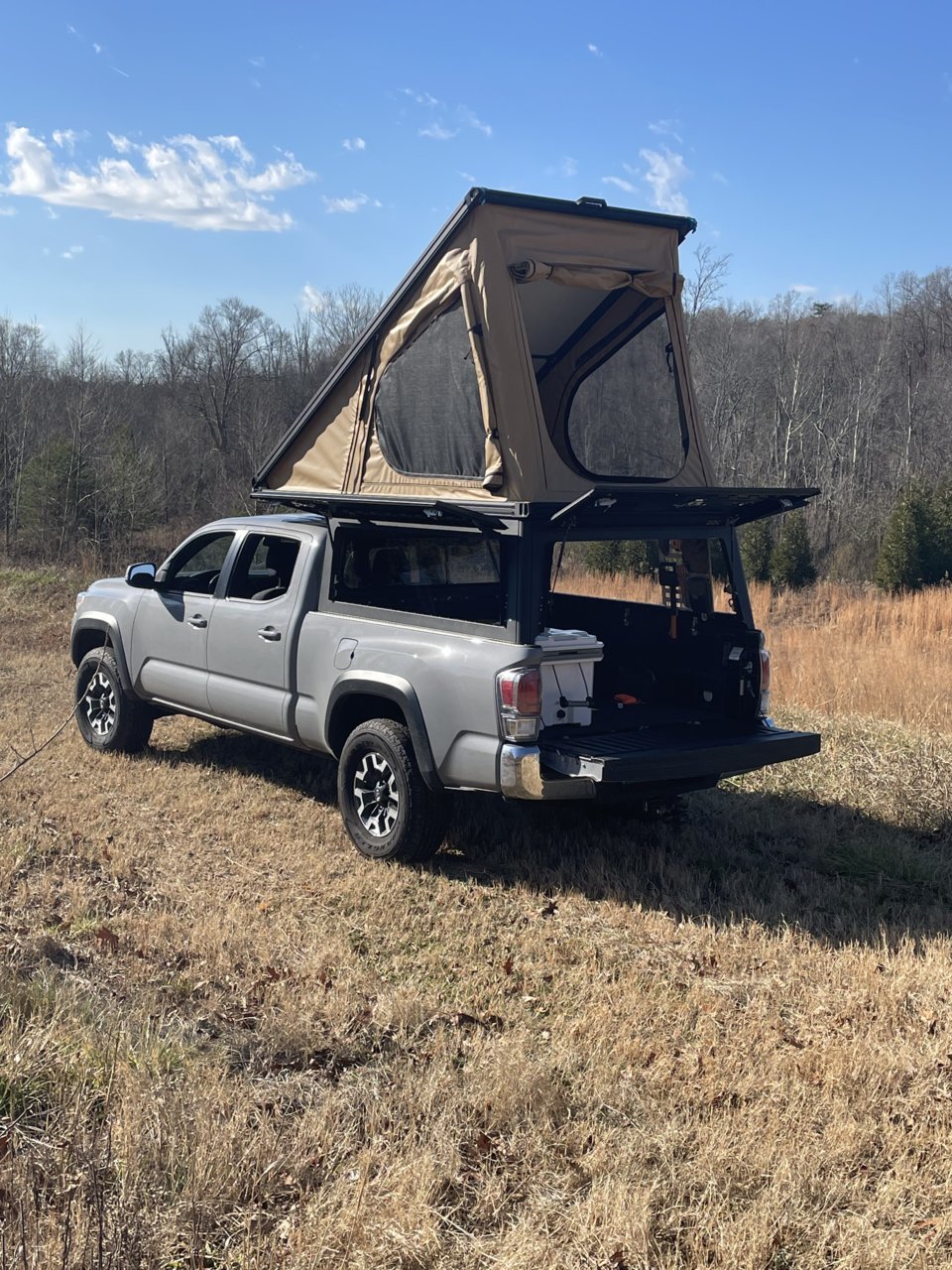

    EA743C6D-E1DE-46E6-87CE-86C17F6BF0A2.jpg Got my install December 14,2021
    We drove 5900 miles from North Carolina to pick it up.
    Was worth the effort.
