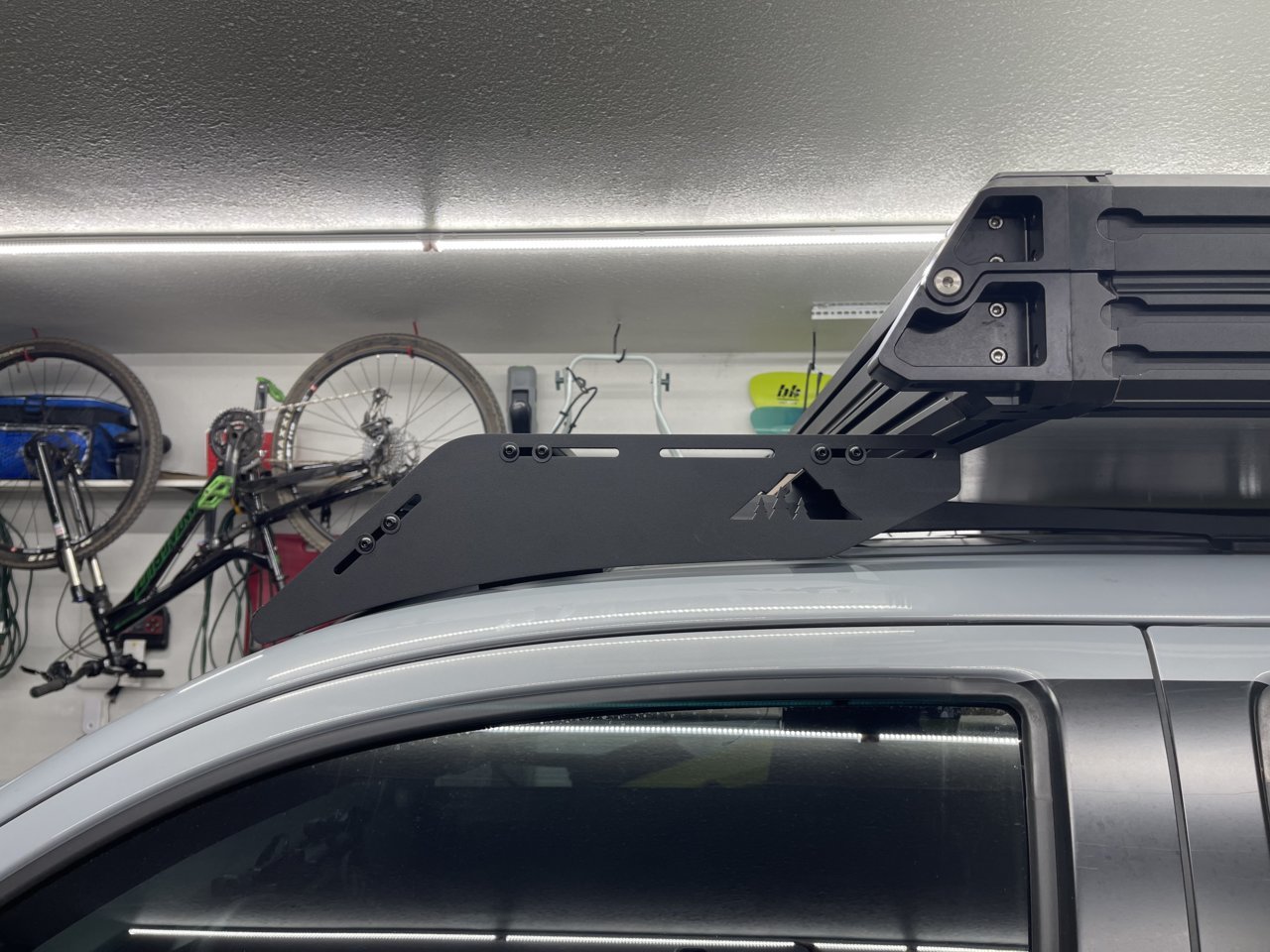

    I didn’t think there was room for the 21”. I was planning a 16”, but now I’m going to have to rethink this and look at the 21” once I pick up my SP. My neighbor just had a 21” installed with his GFC.
    Thanks for the pictures!

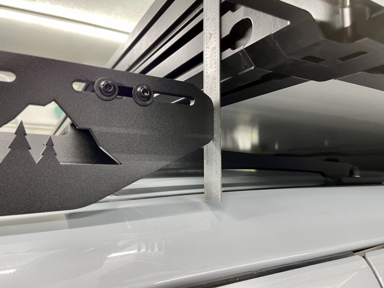

    Keep an eye on the rack. How far from the bottom to the rack? Good chance it’s going to hit it on bumps. That front part moves up and down a lot

    Yep. And the one designed a 2nd gen DCSB with a Vagabond is too close on a 2nd gen DCSB as well. Clearance is ok on a 3rd gen from what I saw in person.

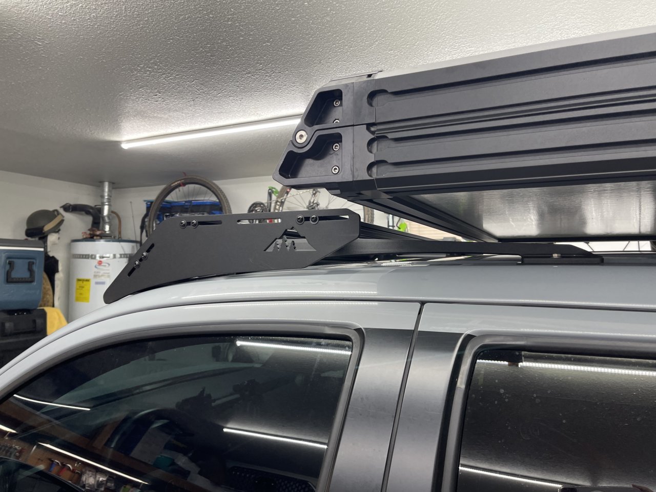

    Thanks for the heads up! There was about an inch of the rack under the camper with about 1/2” clearance. I moved it forward now so that the rack doesn’t sit under the camper at all. Should be good now?

    Nice should be okay ok 3rd gen. On 2nd since the front doesn’t have a solid hold from keeping the X1 from moving forward it would be an issue. Mine moved forward and down. worst case just shave off a bit at the end. Looks good.

    Def better not being under neath. You need a good 1.25-1.5” of clearance under the X1. As long as you don’t have forward movement that looks good

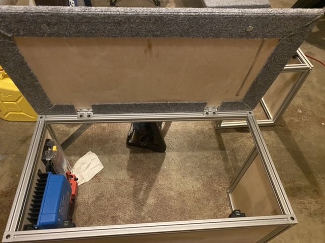

    So being my stubborn self, since I bought the hinges to use with the 8020 i ended up chiseling out an indentation so the hinge would work and sit flat. Adding the carpet covering helps keep it flush. Then magnets to keep closed.
    Since I used 1/2 ply I drilled the screws beyond the ply and then cut them off since the carpet covers. Using these hinges took me more time but since I bought them might as well use them. Just wasted labor monies haha.
    pretty happy with how it turned out.
