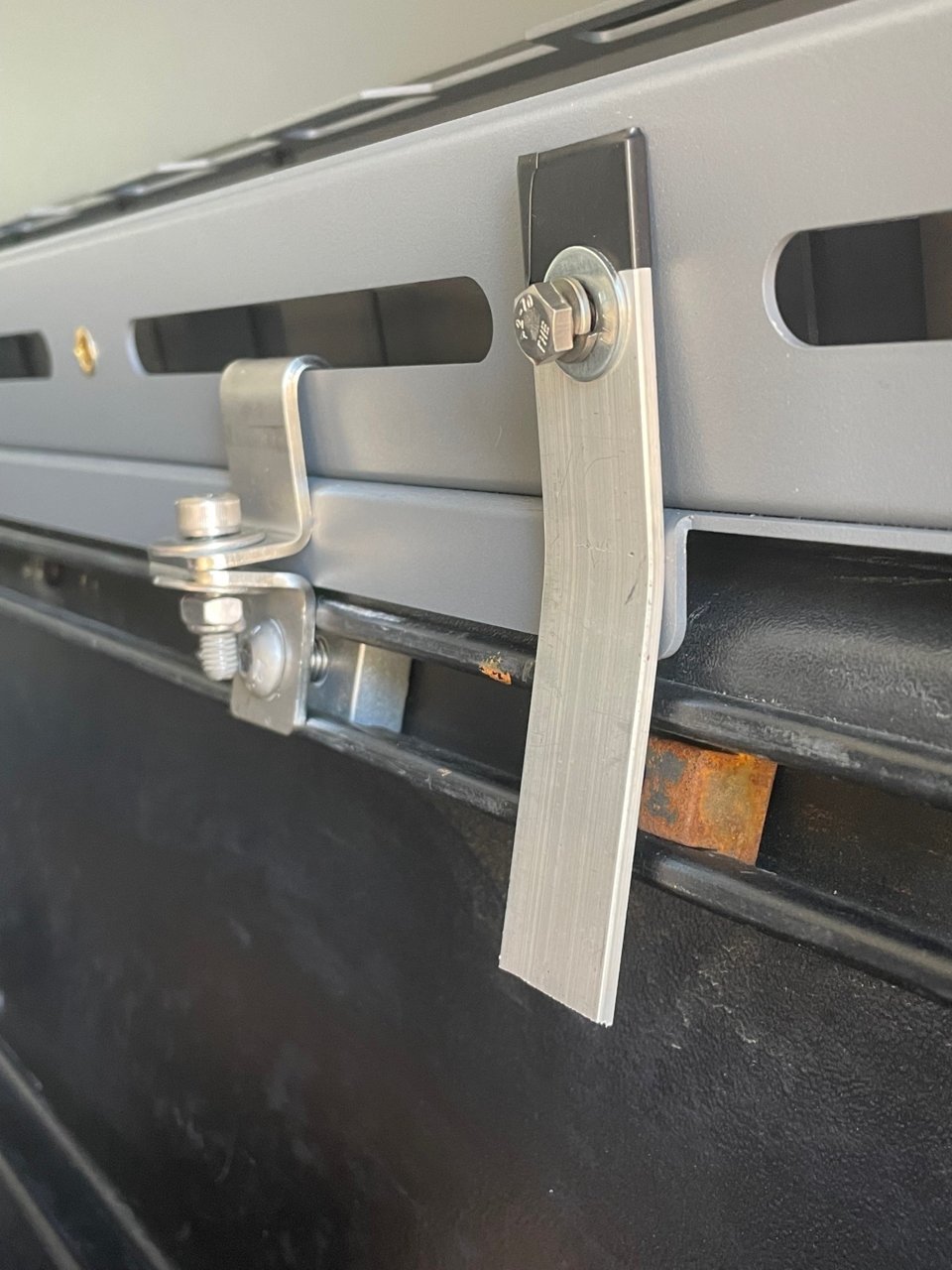

    @mjb11mjb This is what I did to help keep the X1 on solid footing and not moving. So far so good, no issues at all. I put one in each of the 4 corners.

    Yeah this is what I think I'll do if they haven't solved the issue by the time I get a build. Thanks for the posting!
