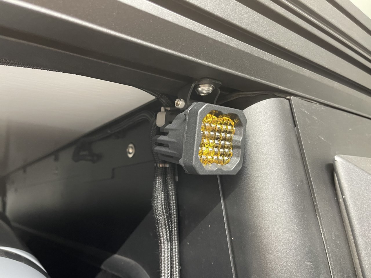

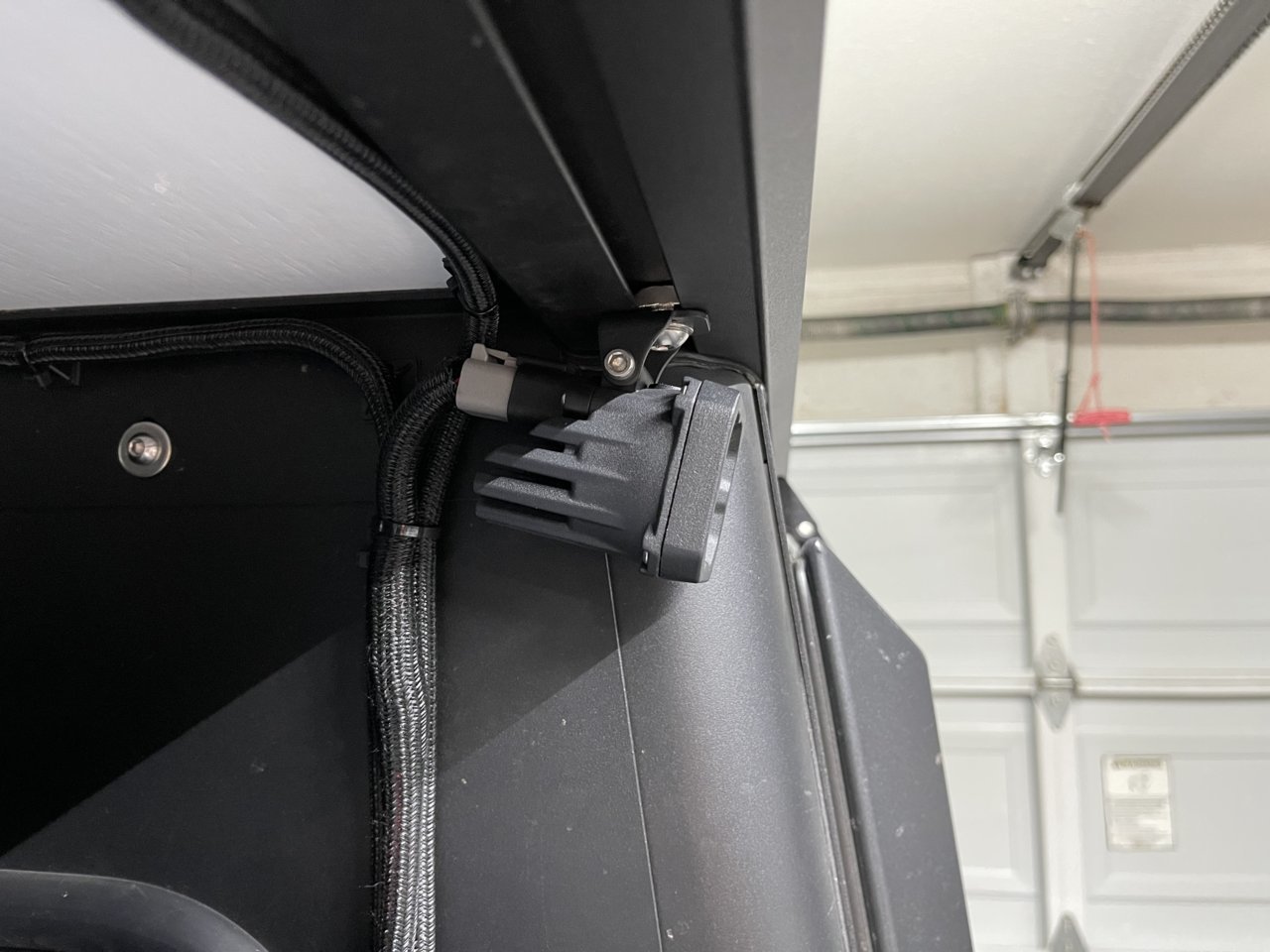

    I mounted them in the slots with M8 button head screws (12mm length) and t nuts. I tried some t nuts from mcmasters but they were a little too tall and didn’t fit.
