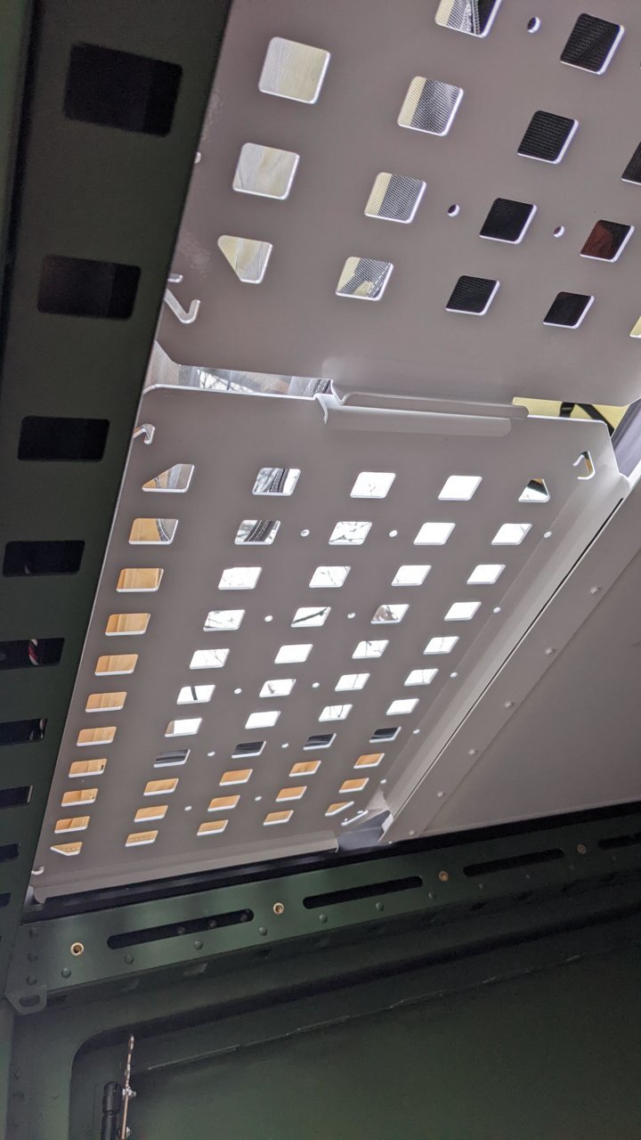

    Taking the leap and placed an order for the new molle floor panels. Should be here within the next week or so.
    Pictures provided by SP.
