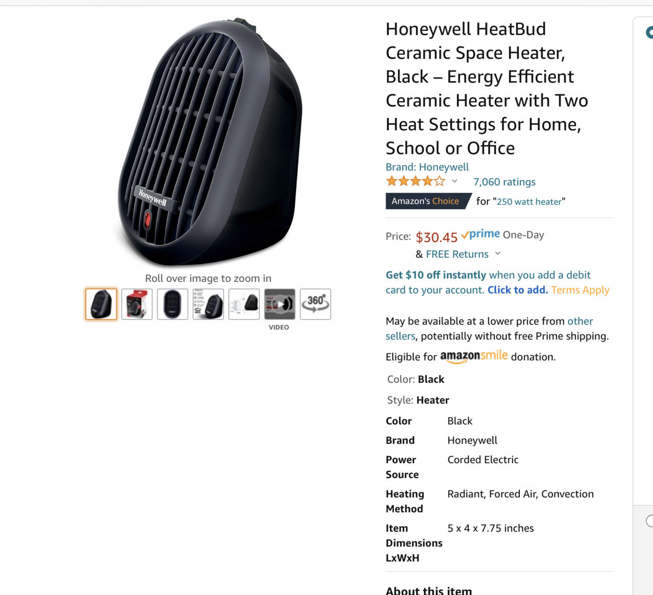

    What 250 watt heater is that? I’ve been looking for a low wattage electric heater to use in the tent area on cold nights or mornings.

    That's gonna kill a 12V battery quick running an inverter.

    I only plan to run it long enough to warm it up, crawl into bed, then turn it off. Back on in the morning again just to warm the space up.
    You may be right, but I have to try it anyway.

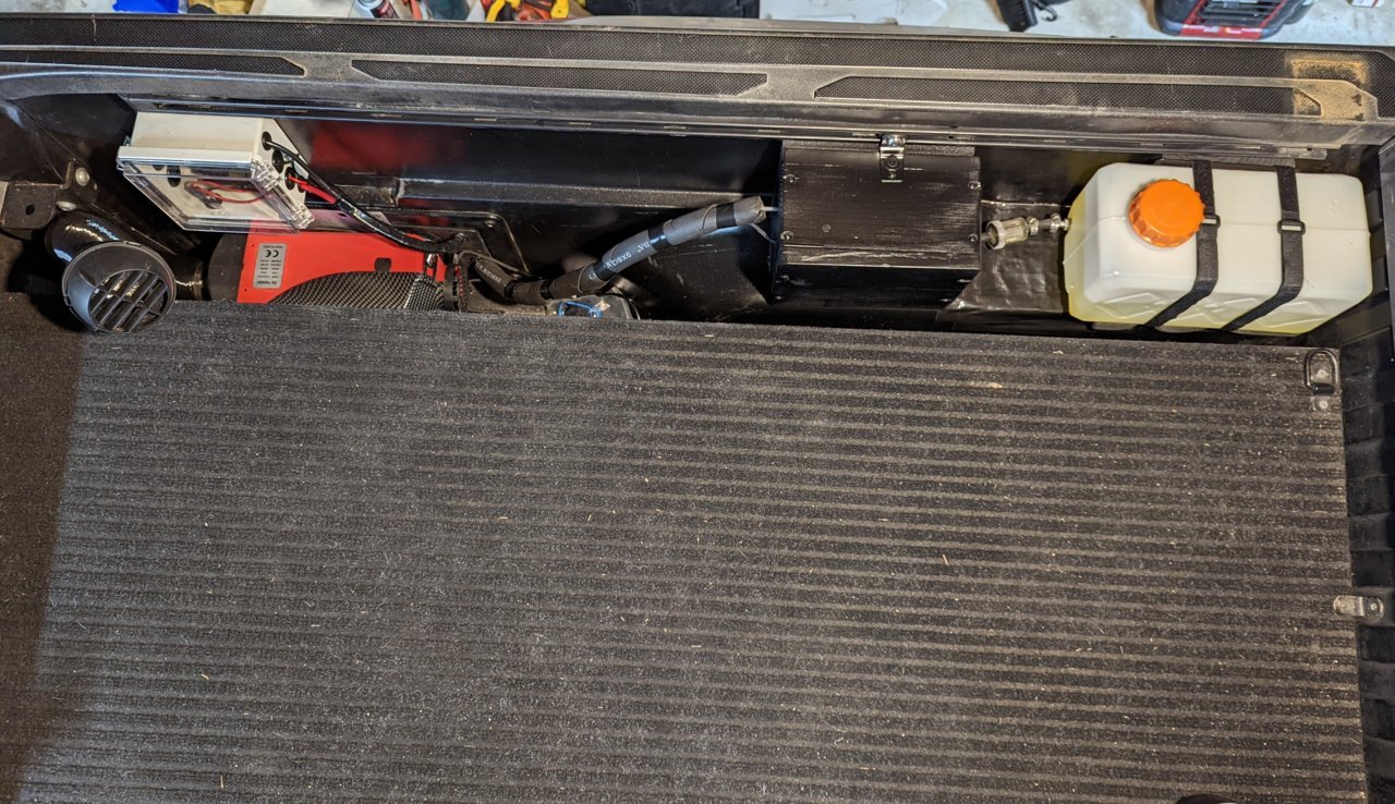

    I installed a cheap diesel heater in the unused space between the wheel well and my box. Will run for 30+ hours on a gallon of diesel fuel. It exhausts outside the vehicle and will not deplete the oxygen in your sleeping area. The only electrical draw is the glow plug on startup, the fan, and the LCD controller (maybe 10-14ah per night, running all night)

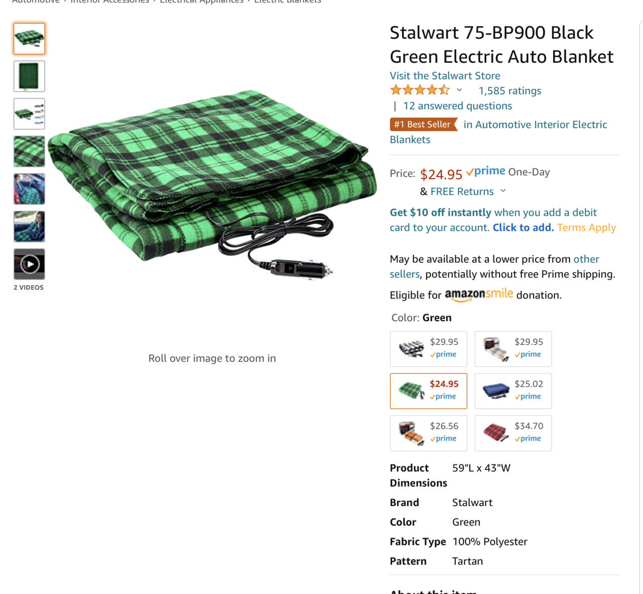

    Another 12v option I am considering:
    Warm the sleeping space up, then turn it off.

    Any sort of space heater is inefficient by design. I’ve gone so far down this rabbit hole ha! Best bets for efficiency are diesel and propane.

    And the summary is:
    Diesel, you need electric to run the pump.
    Propane, you don't need electricity since it runs off pressure.

    Downside to propane is it introduces more moisture into your camper and also more likely to burn the oxygen in your camper.

    My issue with diesel is it’s a single use fuel. If my engine was diesel it would be great. Propane, better (JMO) because I already use it for cooking.
    Propane does introduce moisture when not using a heat exchanger. The heat exchanger needs electricity for a fan.
    Nothing seems ideal.

    I understand your point, the only thing is: $3 of diesel will run your heater for 30+ hours. $3 of propane will run a heater for 3, maybe 4 hours.
