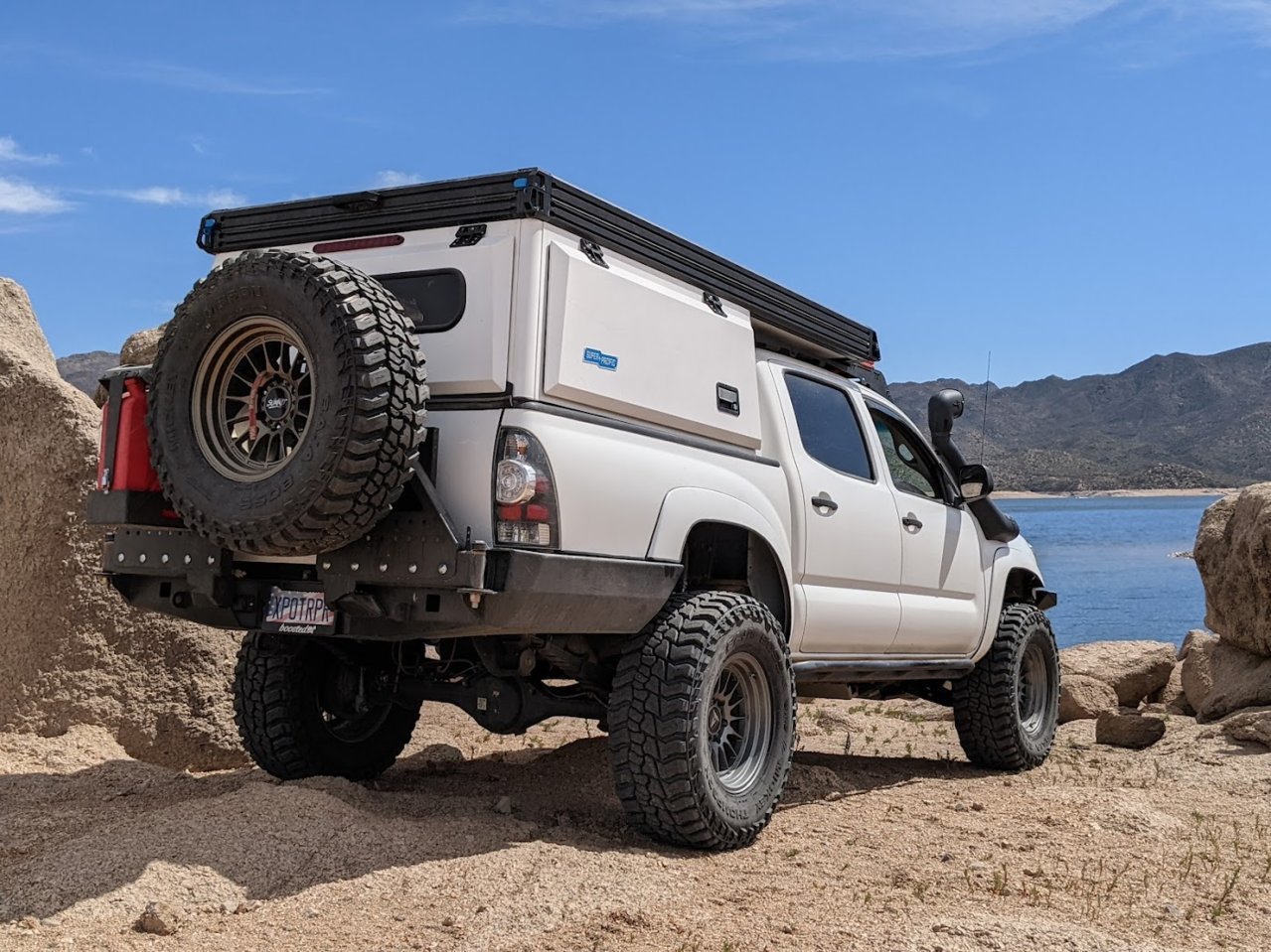

    Love that board. What kind of propane mount is that?

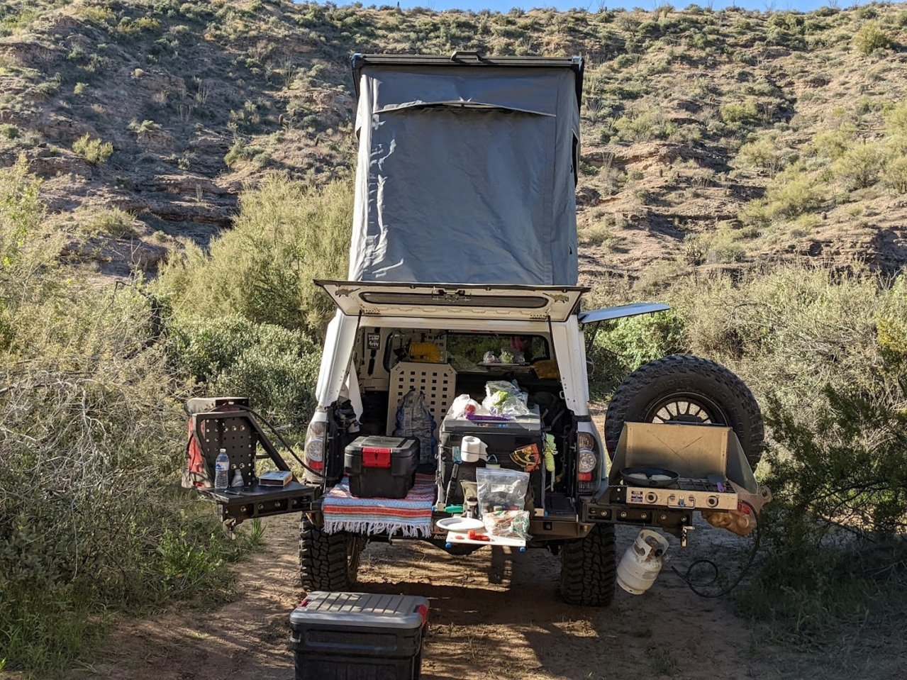

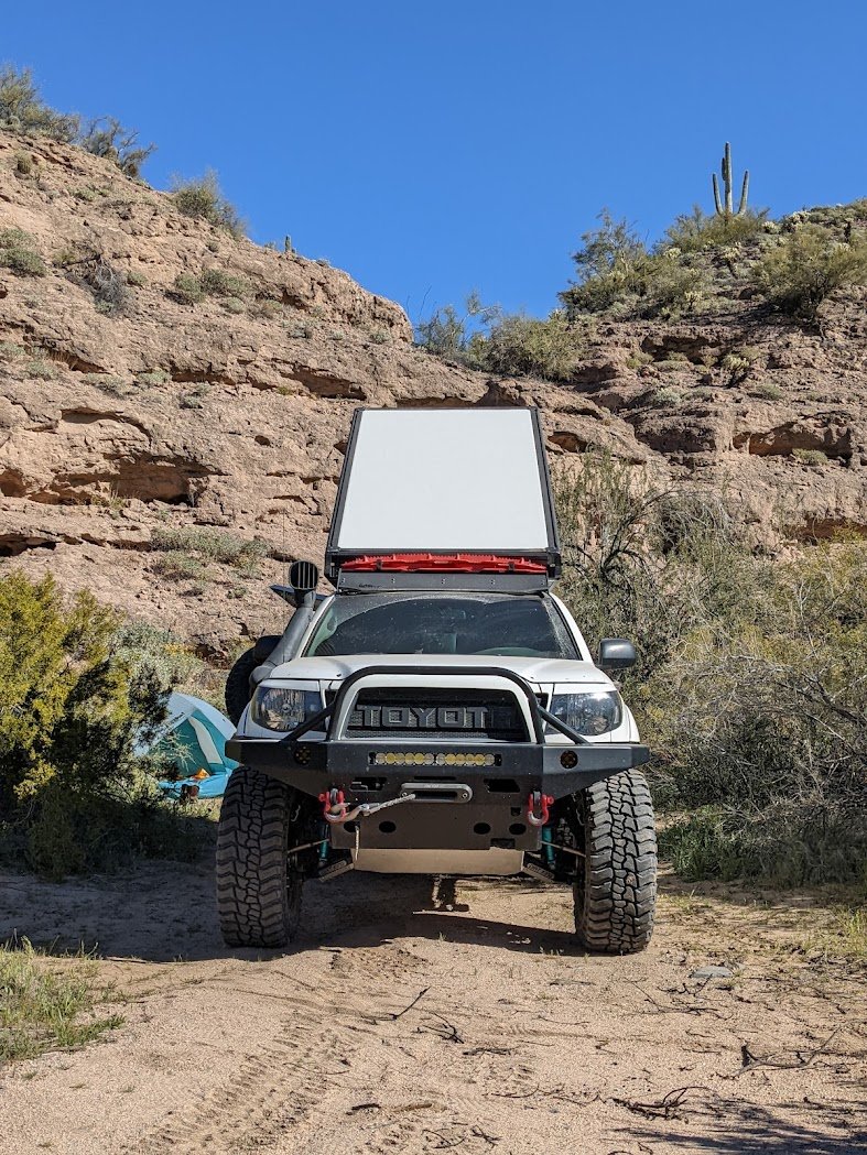

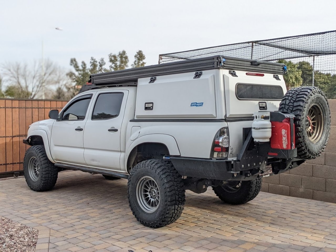

    Was finally able to get out for a quick overnighter this weekend. First time actually using it for camping since picking it up and camping on our way back down from Portland. Lots of wheeling adventures in-between.. but no camping. Which.. the aggressive wheeling we do might have been a culprit to the issue I experienced when closing up the X1. The top mounts for the struts have bent outwards, causing them to make contact with the lower extrusion, enough where its actually removing material. I was unable to close the tent as both top mounts were hung up on the tops of the bottom extrusions. It wasn't like the frame was just twisted (even though that was an obvious issue as well as I can see the twist/shift to one side and difference in the latches and the gaps it creates). But.. both mounts were hung up evenly, and even though very subtle, were slightly bent outwards to the eye. I was able to manipulate the top mounts enough with a Crescent Wrench (bend them back IN to clear the bottom extrusion) and finally get it latched. I didn't get any pics, as I was too busy working on the damn thing in the middle of desert and at this point was pretty irritated. I plan to reach out to SP and see if I can get some new replacement mounts, and see if it repeats.
    Other than that.. it was great! lol

    And this is the tank and mount I run. FlameKing 5lb with BAMF mount. The mount will only work with the 5lb flameking tanks, but you can attach them ount anywhere.

    So, the mounts are easily removable to replace?
    Small things like this make me happy i had to put off my pick up date.
    Definitely be sure y5o pass this info along to SP.

    Yep. Allen head screws secure them to the extrusions. I'm definitely reaching out. They have been good about taking care of their customers. I'm not too worried about it.

    Well, I'm not entirely sure that was the cause yet. I reached out so we'll see. But.. spare mounts might not be a bad idea. Honestly, a little repair kit or replacement/wearable parts kit would be nice to include with the purchase of one of these. I already lost some of the hardware for one of the door locks, and had to have them send me extra parts. Now these mounts. Basic stuff like that and hardware, etc would be a nice little addition I think.

    Having a hard time visualizing the issue, or how it could be caused by hard wheeling, unless you had the camper deployed while you were driving lol? I sometimes have trouble with the latches being misaligned with the catch mechanism when I try to close the tent, but that is usually caused by too much bedding, or a bit of tent material pinched between upper and lower extrusion that I didn't notice at first.

    I'm thinking maybe a combination of stuff. Possibly tent material stuck in that area around the bracket/struts that I didn't catch (because it does happen and I have to tuck it back in) plus the movement of wheeling.. maybe it pushed out the brackets. Idk. All I know is what I was dealing with.. and it wasn't as simple as the latches just not being aligned. I've had that happen while closing up and it's easily remedied so that wasn't it. This time the brackets were pushed out.. sitting on top of the bottom extrusions.. making it physically impossible to close. I'll get pics when I open it up this week to continue talking to SP.
