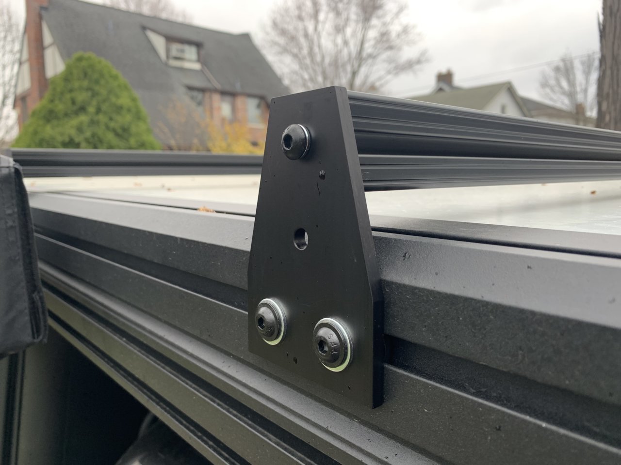

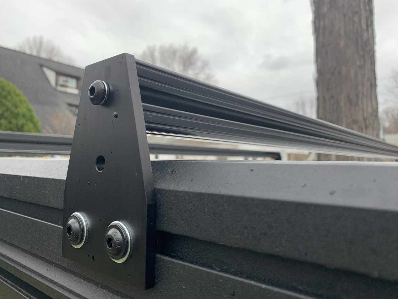

    80/20 roof rack installed. I think it came out pretty clean.

    Very nice! I think I will copy you except maybe in silver.

    It would look good in silver also. It’s a ridiculously solid set up. Probably overkill

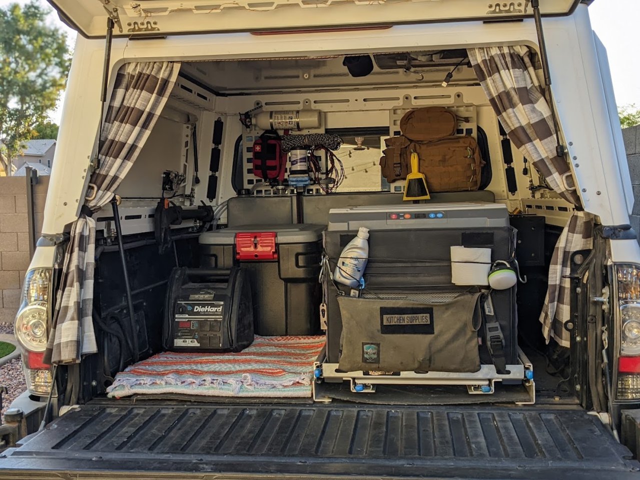

    packed up and ready to hit the road after work today. Got my 12v water set up a little more permanent last night. Shutoffs, valves, and fittings in place, pump mounted, hoses ran for the most part. Going to test this, and if all is well, I'll run the water lines really cleaned and tucked into the X1 wire chases. I have one main shutoff just after the outlet on the tank on the bottom then up to the pump, then hose ran to the tailgate/bed stiffener and used the existing hole in it to run the hose through and mount another shutoff valve/hose bib there. Then I have a short section of flexible garden hose with another valve at the end with a magnet hook to stick it anywhere for our "faucet/sink". Just need to finish the dual battery still so I can ditch my power pack and that will be the last thing to eliminate from my old setup.
