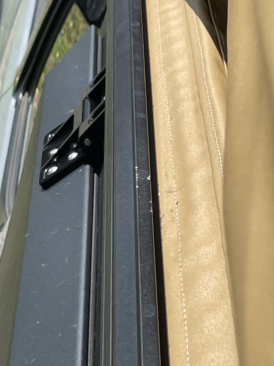

    Anyone else having issues with the strut pin hitting the bottom when trying to close the top?
    I have measured the top and bottoms of struts so they are true on both sides. Didn’t fix the problem.
    I could file the ends of the pins down on both sides to make it close easier.

    when I do get the top to close it looks like I have a bow in the middle
    Something has moved after 3 camping trips and I can’t figure what’s out of alignment

    Same happened to me. After talking with Randy at SP.. To fix the mounts, you need to grab a 2x4 or anything flat and solid that you can place on the face of the pin, and then tap it back straight. a few whacks with a mallet will do the trick. The camper will fall back into place once you have it clearance'd enough.. if not, repeat. To stop it from happening again in the future, you need to really make sure you are fully deflating the Exped and perhaps, remove some of your bedding to allow it to close easier with less materials (bedding) inside pushing out into those mounts and forcing them outwards. I literally just went through all of this the last couple weeks. did my measurements, etc. Everything is there just like yours. It's just from the stress/pressure of whatever materials you're using being squeezed out flat, outward, and putting pressure on those mounts.
    I re-did all our bedding.. ditched our 2 person sleeping bag, and did a combo of bed sheets and blankets. now it falls into place and latches easily, this is also after I squeeze out as much air as possible. I fold it in half long ways and lay on it, and then roll up a 1/3 of one end to really get the last nit out. then place everything back flat. The sheets stay in place since they are fitted/tucked in.
