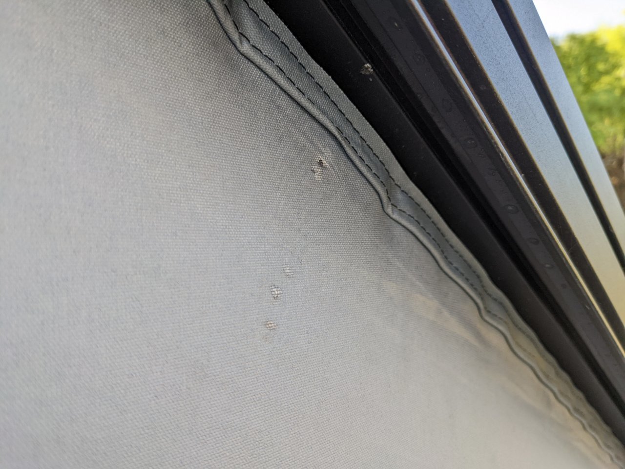

    Also, the shock brackets when closing/closed are wearing the fabric at the bottom.
    I can see them eventually wearing through the fabric causing some hole(s) for water/dust/etc to get in.
    This could also affect the keder system (drainage, structural) in the future.
    Could see having to patch the fabric at some point.
    Is this a design issue, adjustment issue? Is there a way to fix/ mitigate this?

    The fabric pinch point.. I'm getting that as well. Again, I believe this is just from the mattress/bedding pushing out on the tent and mounts if there's too much of it in there when closed. I'm hoping with the new bedding setup and being really diligent in deflating and prepping bedding, I can stop it from getting worse, otherwise.. yeah.. I think I'm going to patch it.
    Notice the slight wear mark from the mount rubbing on the extrusion too. It's all part of it.. bedding and possibly a combo of that plus heavier off-road use.

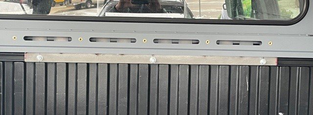

    @econwatch T-9 for sure and no problems so far.... for the X1 moving, I installed 4 aluminum flat iron pieces from the bed rail to a riv nut in each corner. I have pictures posted in this thread somewhere... I'll try to find them. I have a 2nd Gen so I also installed a support up front under the X1 lip; see below.

    would for sure like to see more pictures of this

    definitely looks like it'll work from keeping the camper from shifting forward. simple and works! and looks like you may be able to do it after an install. Is there still the composite between camper and bed?

    I had an issue getting the blue latches to close within a week of picking up my X1. Some lube helped immediately and when I got home I ordered the recommended T9, and no issues since. The tent sides do show some black marks from touching the struts. I wipe those down every so often and it hasn't gotten worse. When I put the tent down I pull the material to the inside and toward the back to get the material away from the struts and the extrusion. I've found when I don't do that it can get trapped between either and it makes the top a lot harder to push down. No issues when I'm careful about tucking fabric in and deflating the mattress more.
