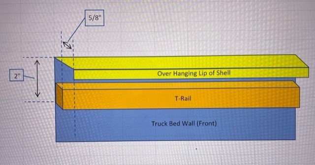

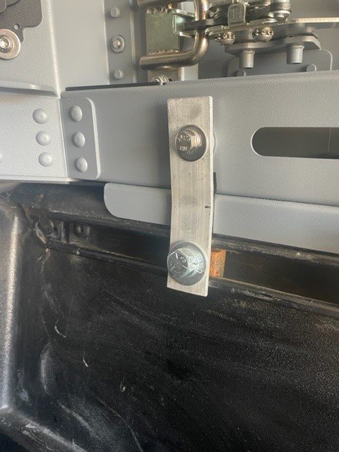

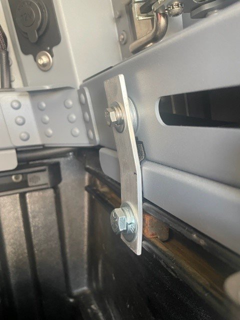

    @Coop68 and @XPOTRPR I installed the front support after the X1 was installed. Here are some schematics I created, and these along with photos are somewhere in this thread back around pages 80 or 100 or so. Also, for those who are interested, here are photos of the brackets I made to keep the X1 from moving.

    Yeah now I remember going over all that with you.. I'm glad its working out! I would have done something similar if I had already had the X1, but I also wanted to remedy the filler used for 2nd gens and stock rail caps, hence the solid 6061 bar I made. locates the camper and provides a solid flat surface for the bulb seal to sit on.

    It has worked out great. BUT, if I didn't already have the X1 on I would have done what you did. Your method is very solid!! I'm getting small water leaks up front probably from the bulb seal and I need to figure out exactly where....
    However, I backed into a large pole and will need to get a new rear quarter panel, and this necessitate me having to take the X1 off, so I may be doing what you did. Josh, do you remember what page #s you posted what you did?

    @econwatch go to pages 260, 261, and 266 to see what I did upfront to keep the X1 from sliding forward. I have drawings and pictures, and there are some discussions on this. I installed these after the X1 was installed and I have a 2nd Gen. @XPOTRPR Josh, has a great idea on pages 262, 263 and a bit further on using a bar he installed, prior to installation of the X1. I like this idea and since I have to pull my X1 off for body repair, I will go this route.

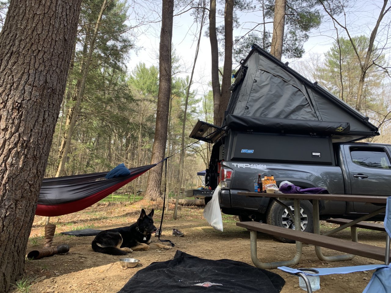

    Maiden voyage. Allegheny National forest. Everything worked awesome. Great design. I had at least a dozen people ask me/admire it over 3 days.

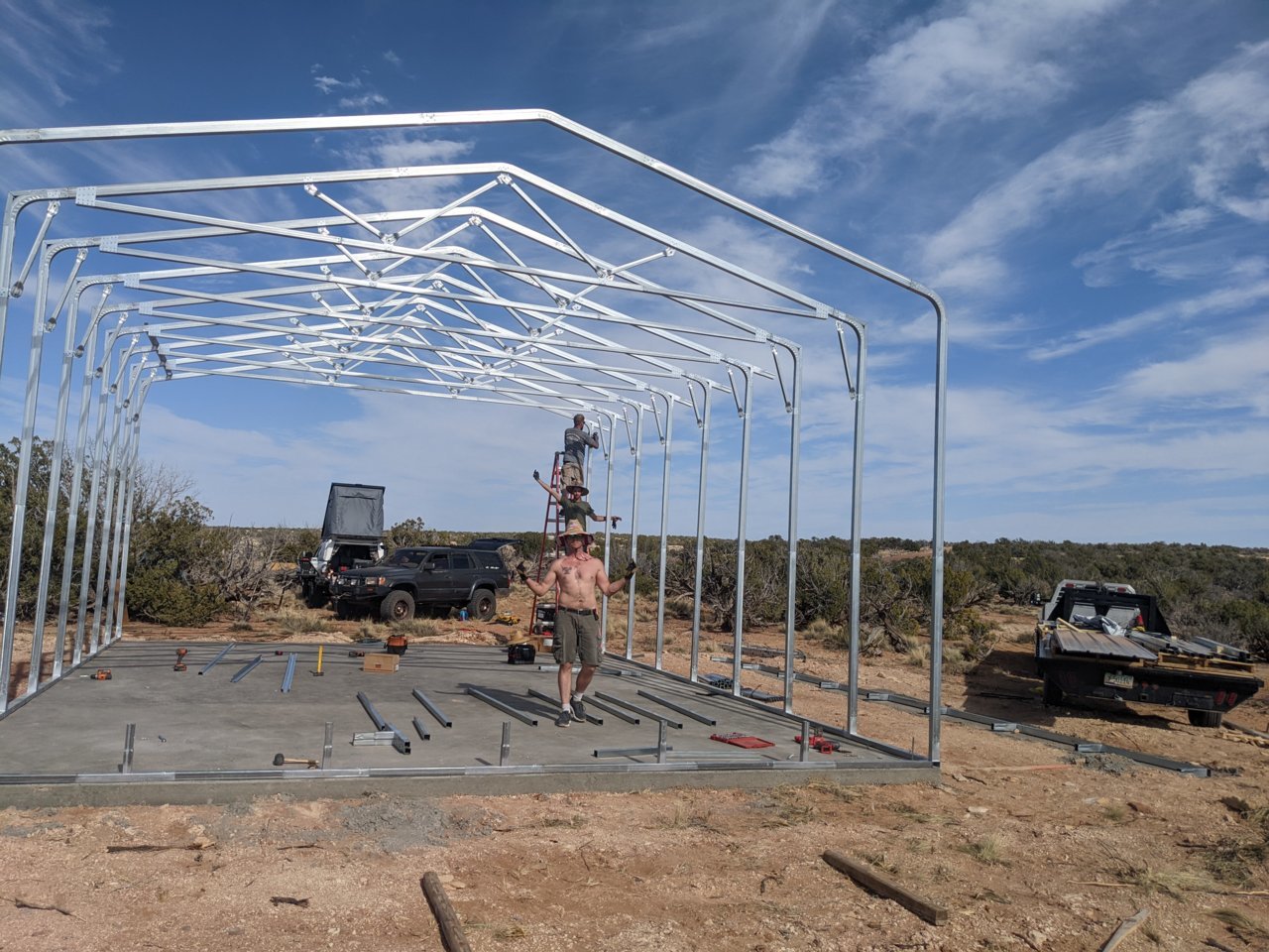

    Got out again this weekend as well. Drove 6 hours into northern Arizona almost into New Mexico with the crew to camp and build a VersaTube garage/shophouse for our buddies customer who bought 36 acres in the middle of nowhere to start a off-grid homestead. Used the truck for home base while we worked all weekend. My revised 12v water setup worked beautifully. I need to get some detailed pics/vids of it.
