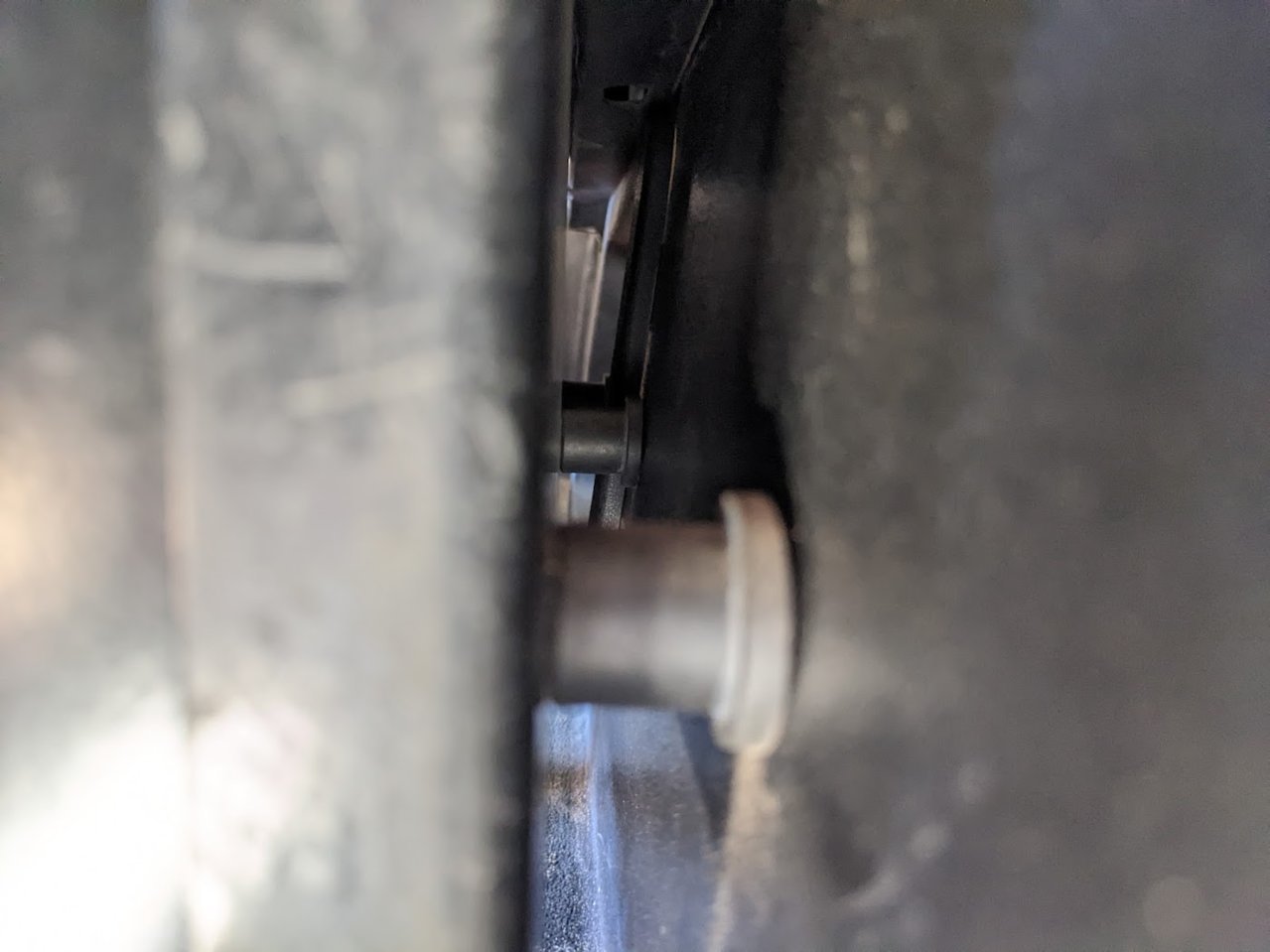

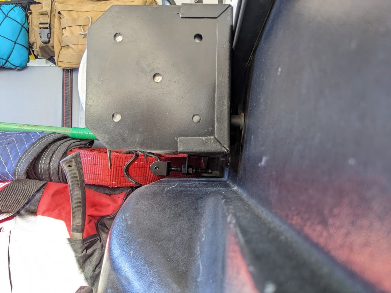

    Wasn’t expecting this right away…yesterday after letting the exped sit for 24hrs I messed around with opening and closing and had issues with getting the exped compressed enough so I pulled it out and it easily closed.
    went for an overnight trip to test things out. In the morning, tried squeezing more air out of the exped but wasn’t closing. So I pulled it out, thinking no big deal I’ll eventually figure it out. Still no closing. Panels were seated properly, tent tucked in. Then I noticed the bolt on the gas strut brackets was resting on part of the edge. You can see where it’s causing damage and it’s happening on both sides. Tried to see if I could shift things but was t going to force it to close. I’ve emailed SP….
    I zip tied with 3 on each side and slowly drove down the mountain.

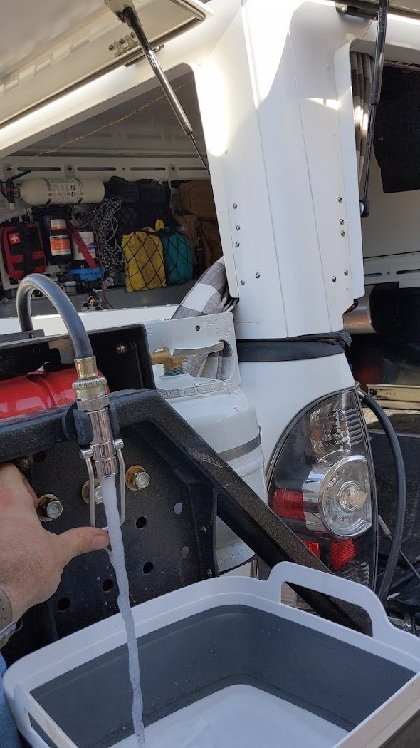

    snagged some pictures of the tank/mount setup.
    s5Zo9K8s4gHSlwJGmibs7ZiuC9_kBDeOTvmBAuUH_bba047e117692d96448830f55eadb69a415ab201.jpg
    Z5HZx6q1xeAzINKx3Vw_meq6DG6RDyhF0QO7SpF8_a99605e49ede07fc3506a888aaaeb776e972fa65.jpg
    szVVnHHkp_YtGkH5QojhWseUkhlkuSBRBX_HQOgq_1eed22154ce0399c5a95e98365c33b5b3c07a2fb.jpg
    These are the little rubber threaded nuts I used from Ace.
    and some final pictures and quick video of the 12v water setup.
    oAnYn7p-syKFBw9aA2d-eE8jZl9ly5HObMQO59f6_142bed4600334c853a1bf90ad0a2d4f17336d564.jpg
    tGhFasrbzEeS7pX3IdrkaGc0ZXsNHL88PpRqPyKX_8df8dbfcf1446d33a587f68da16f543c99bee1b0.jpg
    https://www.youtube.com/shorts/OwUVNnvGXGk
    cant hear because of the wind.. but the pump doesnt kick on instantly anymore. It drains from the accumulator tank first, then kicks on the back fill. Saves water with the aerator and helps prolong the life of the pump as well as not hearing it kick on constantly with the accumulator. I can also get it down to a trickle without the pump kicking off/on in short bursts.. or also called pulsing. Super satisfied with the setup.

    Excellent! What faucet is that?

    SP replied quickly. Rubber Mallet added to the tool bag. Tippety tapped the extrusion in the pictured area and it’s now closed with the deflated exped in.

    Yeah I had the same problem with mine last year, and I wouldn't be surprised if all SP's have a little bit of the bottom extrusion gouged out by the top gas strut mount. I'm a bit curious why SP hasn't changed the strut mount design by now to avoid this issue with new X1's. Seems like an easy fix, and its very frustrating for us when we try to close it the first few weeks.
