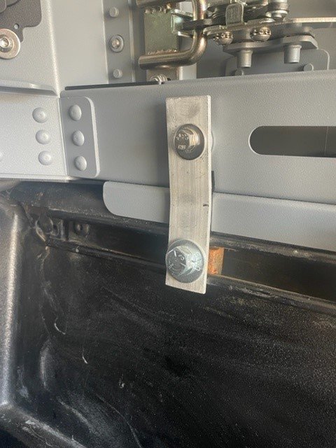

    @DCGirl Just get some aluminum flat bar, bolts and washers, and attach them in each corner of the X1 to the riv-nut and T-rail. Super simple and does not move at all.
