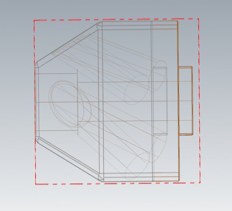

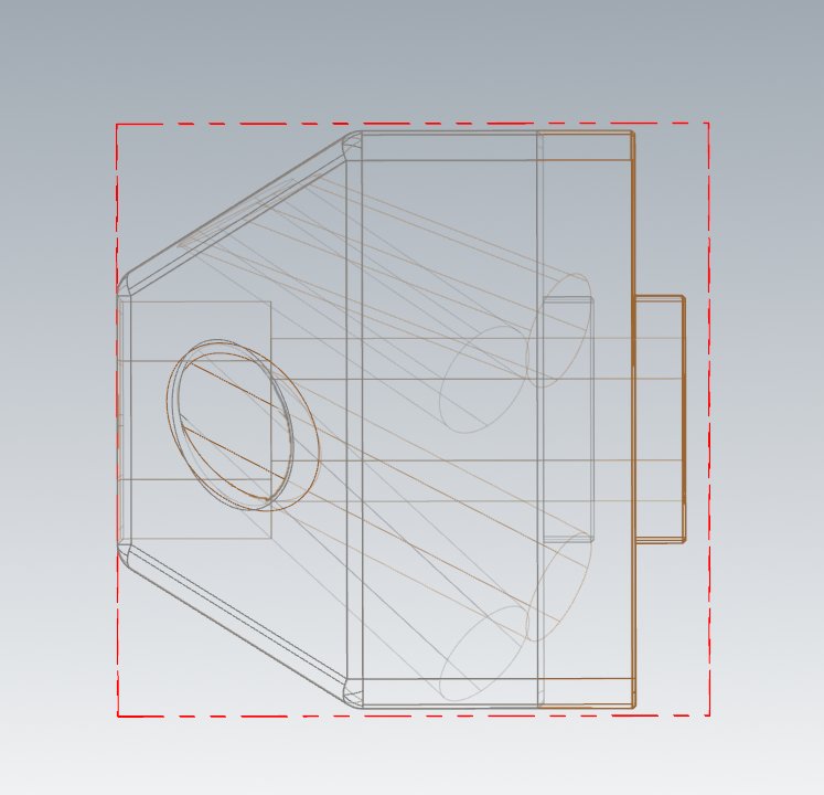

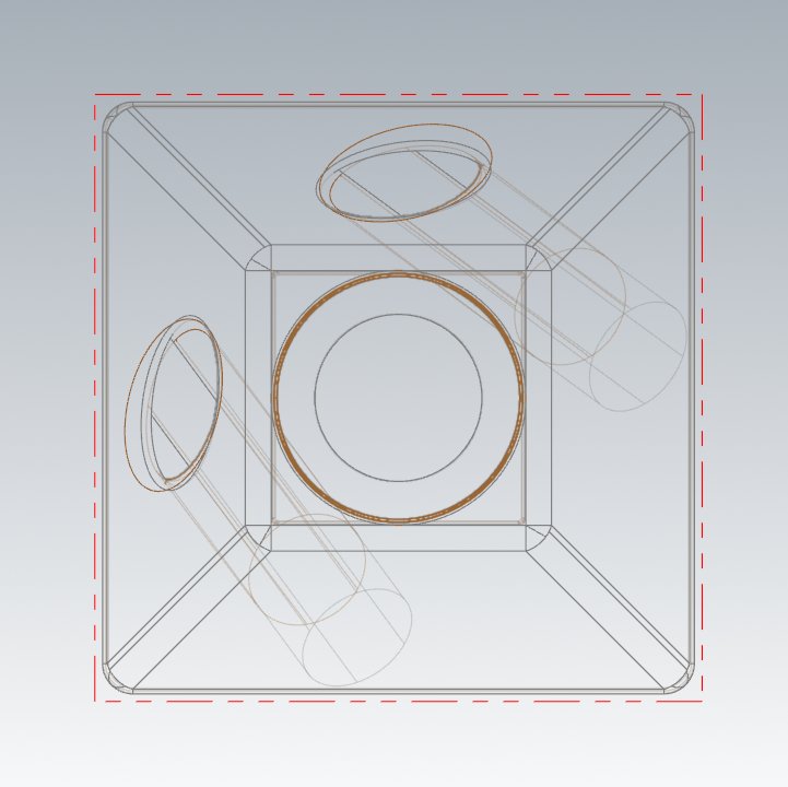

    Ok, little hard to see and follow, but Grey lines are old (v1) and Brown lines are new (v2). I changed the v2 angled holes in 2 directions to give the poles more of an outward Axis to put more tension on the flap.
    This is looking at the front face of the mount.
    this is from the side/top.
    Hard to see I know.. I'll make another set and take comparison photos of both the mounts and them holding the flap. I also adjusted the overall height to accommodate the change in angle. Since its a steeper angle, and the hole needed to remain the same depth, I added material to the height to drive them deeper to be able to keep the hole depth the same as the previous version. This also beefs of the walls of the part as I did see some deflection on the outside surface from the tension of the poles inside the holes. Same starting stock size, just an extra .155" taller, making the height protruding from the SP rail surface .875" vs the .720" of the previous version.... compromises..

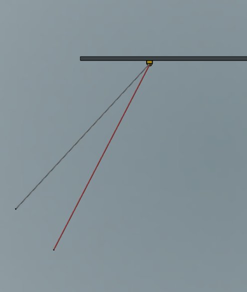

    grey old, red new.
    top view, adjustment should make direction of pull/tension more outward.
    side view, should do the same thing.. put more pull/tension outward.
    in theory anyways... :rolleyes: lol
