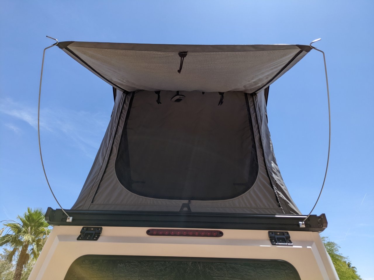

    New on the left.. old on the right.

    Pleased with your changes? New looks more taut.

    Workin on it boys! :cheers: appreciate the support
    yes! very much so. Pleased that it was a one revision fix. lol I could tweak it more.. but I'd just be splitting hairs at that point. Its definitely more taut, in both directions too. I plaid with every combo and position and both holes (whether you use the top hole or side hole) provide enough tension. So no matter what setup or combo you choose to do or need to do, they will work. Got the spud on the backside sized better too.. and this set I sized to mimic having Anodize as well. They fit nice and snug in the slots with no rotation.

    With both revised mounts installed.

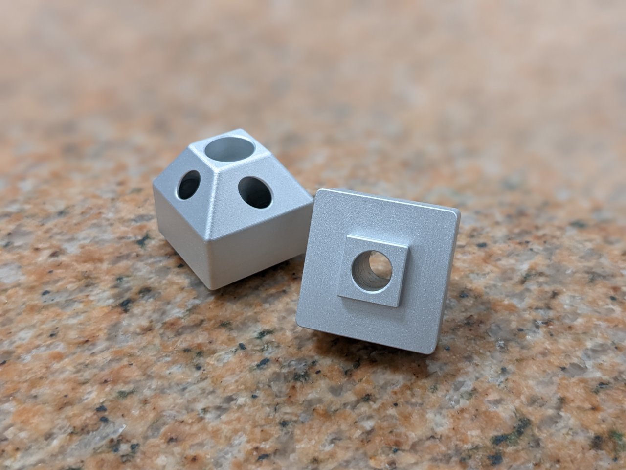

    Alright.. here's my final revised prototype. Used some fine Media we had here at the shop to blast them. Going to run these for a while and then make a batch sized correctly and send off to Anodize.. make sure the build up on Ano is all good and fitment into the t slot doesn't change and we are ready!

    Damn looking awesome!!
    Now Copyright Patent and Trademark em.

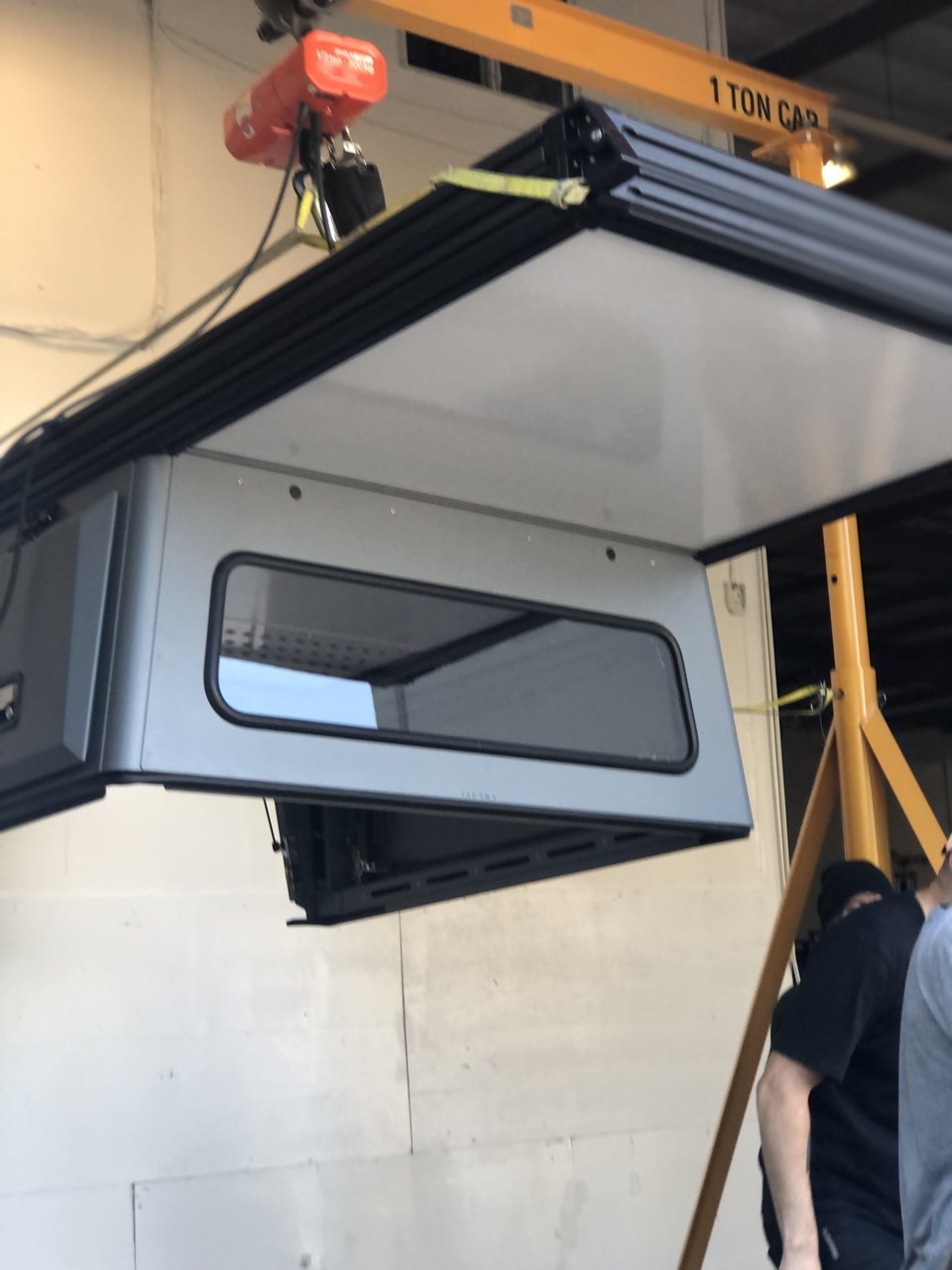

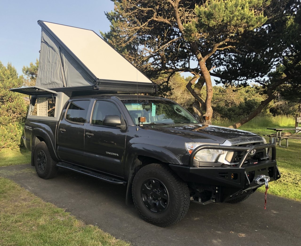

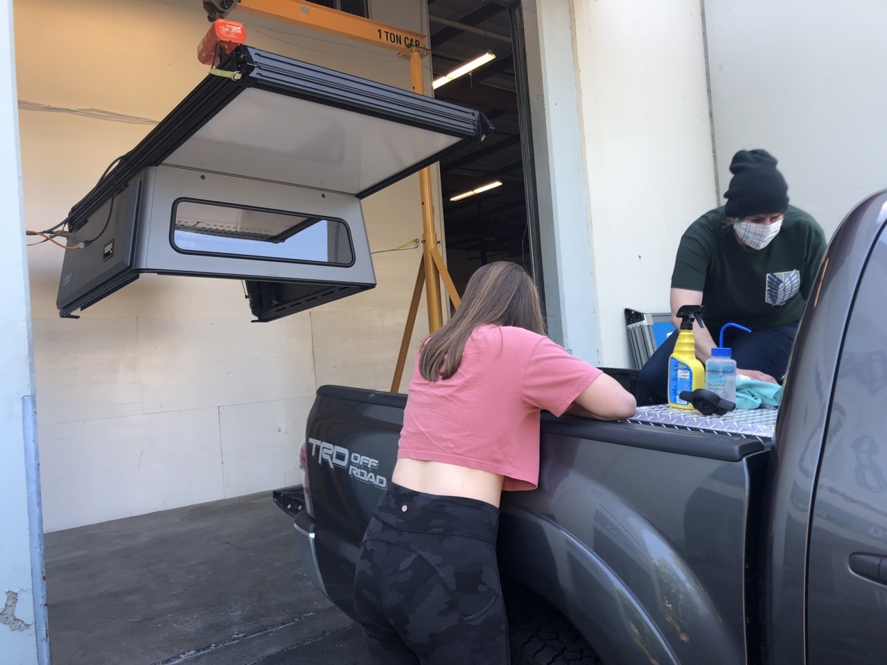

    Just returned home from my install. A few Pics:
    5C7B598F-BDC0-4350-869A-F2E1DEC67C50.jpg F3EE0641-1525-45F7-95AD-056417E93A4F.jpg E20A6D60-66E1-4E8C-B079-3D5596A22133.jpg
    0AB2F8B0-BD33-4391-B419-81ED2DA3C686.jpg 5D7668D3-280E-4320-B613-F5376B76E7A0.jpg 6AB43DAD-C8CF-401C-8B74-F798251F952A.jpg 39C330D9-2958-4603-9C2E-52CA132D43E4.jpg

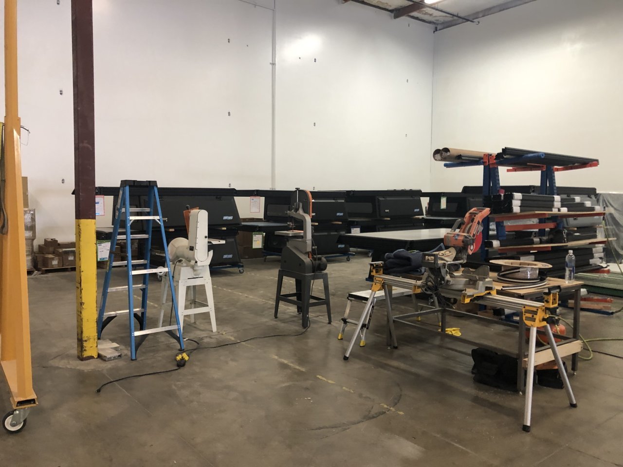

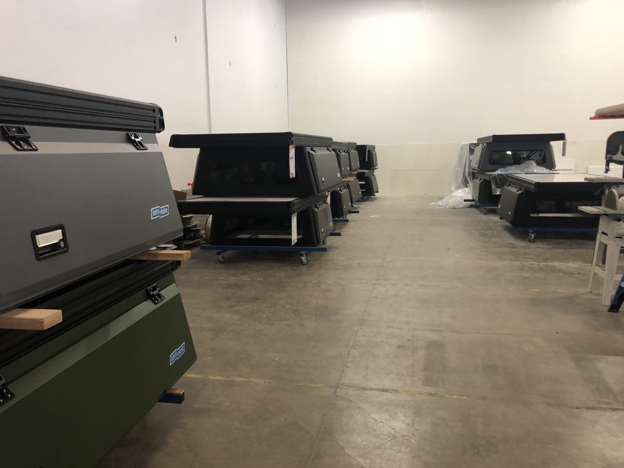

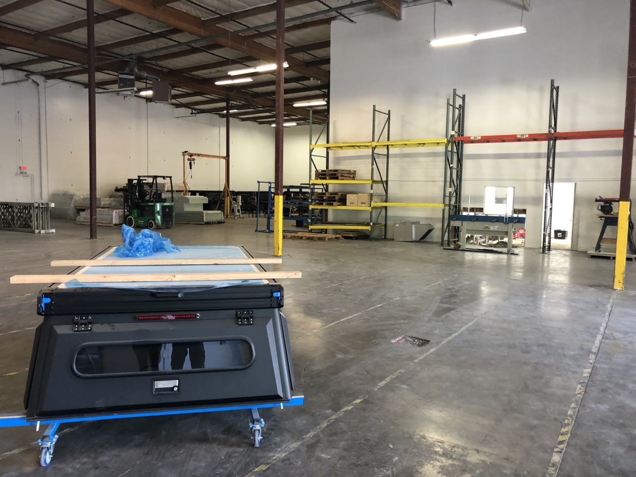

    Some pics of their new facility they are slowly moving into. Sacha says they plan to be able to produce 40 units per week!
    2E1CEB31-59EC-47DF-8359-F8D8C58EBDD9.jpg 88901C51-E96C-4129-8693-8AADCDCF8734.jpg 441782F7-2E7B-44C6-AC42-0B64594C099D.jpg 716B8F5B-95A7-4EDE-BEF6-335141C5B5A3.jpg F73F9483-D8A0-428E-9430-C5BC99B8B1A7.jpg

    Steel?

    6061 Aluminum
