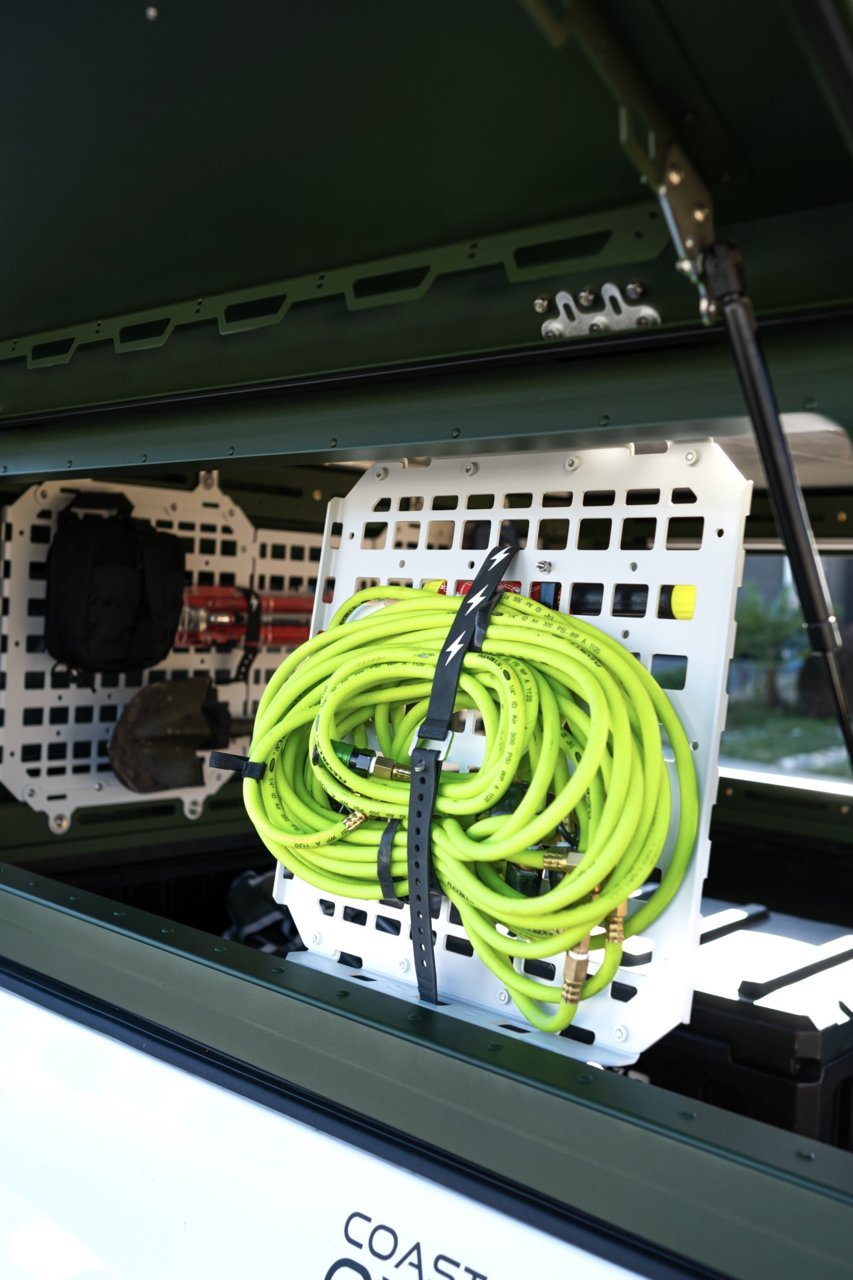

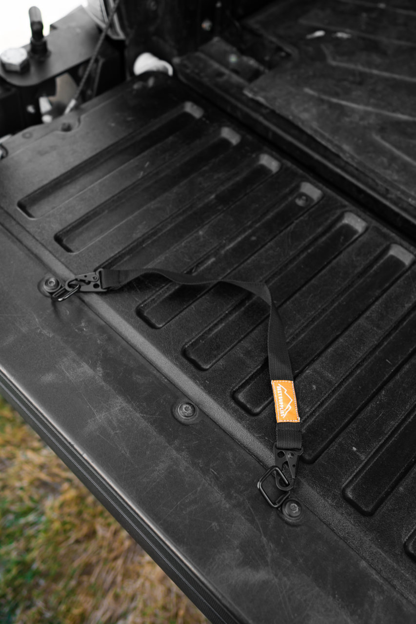

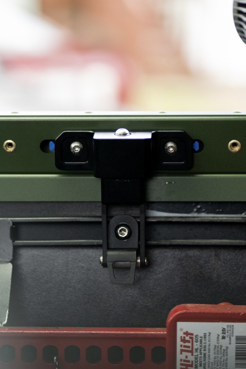

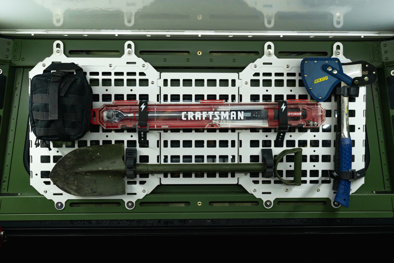

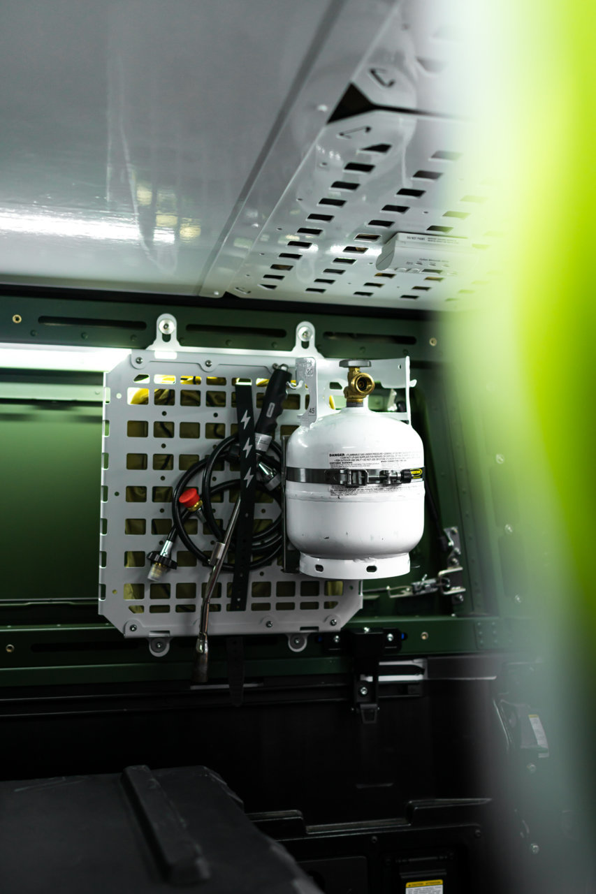

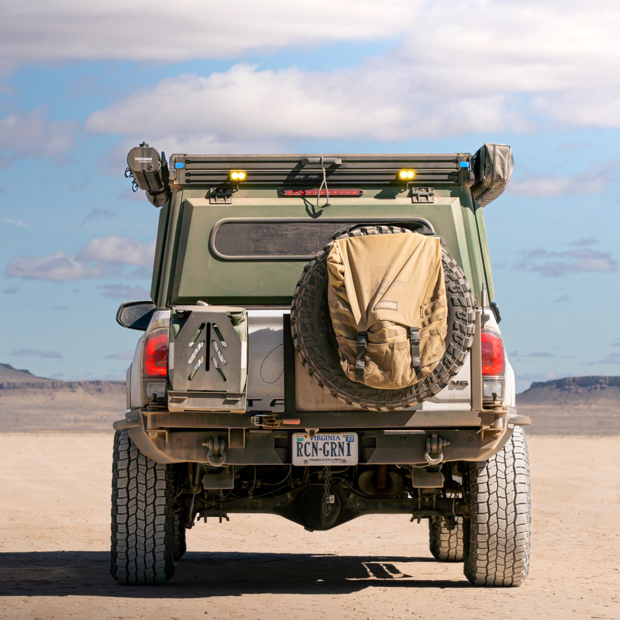

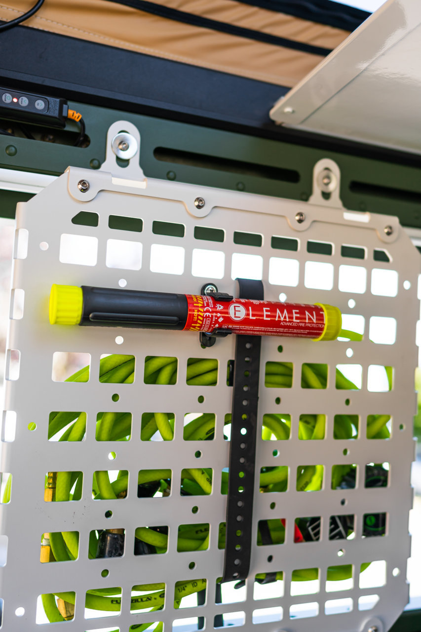

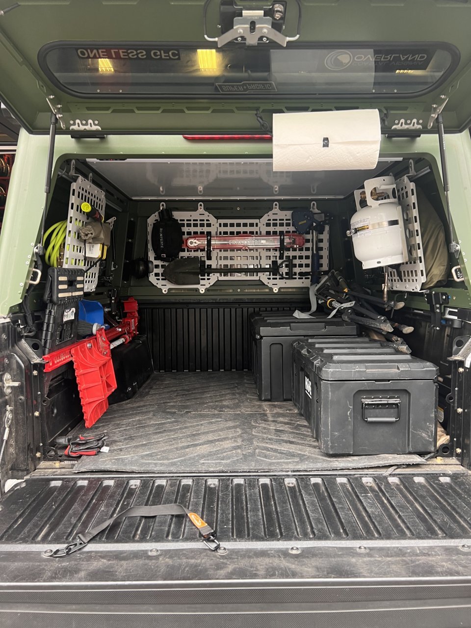

    Upgraded clamps a d Finally organizing the camper.
    8D9B919D-9DD9-4514-851E-13FC9E634082.jpg 639EE171-D4AD-4CD9-97F8-B31057F2C7D9.jpg 6B30185A-5A0B-4243-A084-FA1FC9A89C22.jpg 12E4E33D-17F6-444D-9740-55BEF3EB6331.jpg 26F7E238-D18D-486F-B8A1-789DCE91E5D4.jpg 54DC07BA-EF4C-415F-93FA-0EF1FBB91D49.jpg 1C7B1D57-3E6F-47FA-B5FE-A65F6E2457BA.jpg 0C26A57A-6812-4BDA-98AD-5680A36D515D.jpg AADBA597-9719-47A1-B503-33CCD0597E13.jpg 78B2A253-53D0-466A-8808-31B0A9CAC8E8.jpg

    That strap to close the tailgate is an awesome idea.

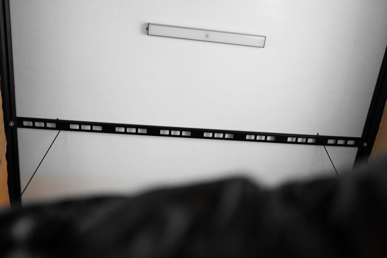

    Installed my new inside crossbar this morning (while still cool!)
    Suggestions:
    1) put a piece of painter’s tape on the extrusion between the 2 screws holding the existing bungie cords holders on.
    2) take the existing holders off. You don’t need to completely unscrew them to get them off.
    3) use a cork screw to help untie the bungies.
    4) reinstall the bungies into each end of the new cross bar.
    5) loosely install a screw and nut into each end of the cross bar.
    6) insert nuts aligning with your tape and snug each one enough to hold in place. A helper to hold one end in place would have been nice, but one person can do it.
    7) check alignment and tighten each screw securely.
    We shall see if it helps noticeably.

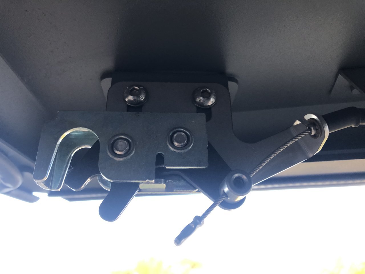

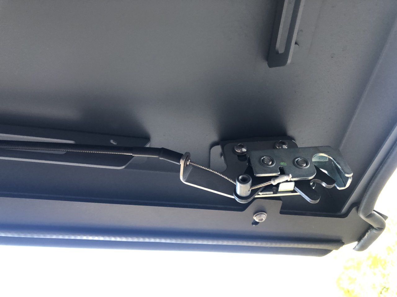

    Does anyone have a picture of the lock mechanism? On the inside.
    I had an idea to maybe get some actuators and wire them to the truck lock/unlock circuit so it all can be locked/unlocked at once. I installed a pop-n-lock for the tailgate, so I'm thinking something similar to that. Anyone else tried this?
