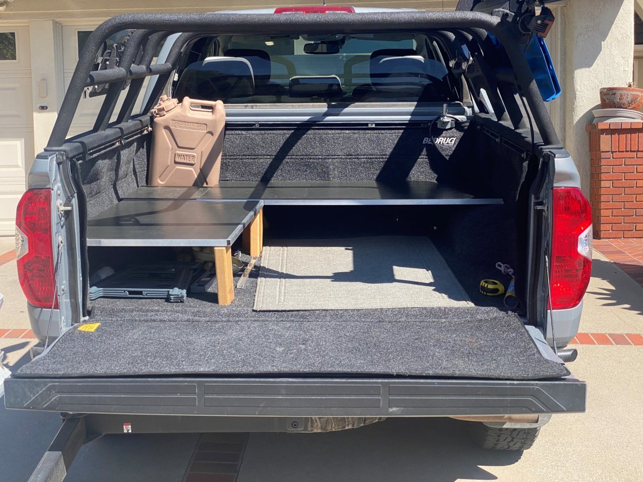

    Wanted to share a little update on my build etc.
    First of all, got some great news over the weekend. My install is scheduled for late October!!!
    Been working hard to get things ready... First step was to install a bed-rug to make my interior feel more like a "room" than a truck bed (plus easier in the knees/feet to get in and out). From there, I started building out my interior. I'm making a platform over the wheel-well on the drivers side for a fridge (Nat-Luna 60L dual zone with tilting slide) and also a bench in the back with storage underneath for chilling out and as a "bed" for my son and/or dogs. One of my key design considerations was to have the truck bed as a chill-out area for cold nights and when camping in areas w/ a campfire ban (watch some netflix on the ipad)
    , but also have a spot where I had full standing room when the top is open and/or room to move around if I want to chill back there with the top in the down position as well (why a Decked type system wouldn't work).
    As you can see, there is a cut-out in the back left for a 5g water jug and I plan on getting one of those USB powered "faucets" posted about 5-10 pages back in the thread. Camp chairs will go under the fridge platform on the left and I've found some plastic totes that will go under the rear bench platform. The supports are rough 2x4 and 2x3 in this image, but I've given them a coat of black stain/poly since I took this pic last week.
    In the back right (behind the wheel-well) I'll have a 180 amp-hour Lithium battery along with a redarc BCDC charger and at least 200 (maybe up to 400) watts of solar up top to give me enough juice if I decide to bring along my e-MTB (want to be able to charge the batteries completely off-grid).
    All of the interior pieces will be secured to the bed using an existing set of L-Track rails I've had since day-one and a handy fitting I found:
    (btw, these L-Tacks are SUPER convenient and incredibly strong... Highly recommend. I've used them in the past to secure coolers and stacks of firewood on some ROUGH off-road routes)
    [​IMG] [​IMG]
    Lighting will be achieved using the MattGecko dual red/white LED strips (probably with dimmers)
    Well, that's about all I can think of to post right now, but I'm sure there will be a ton of complete build-out images in the next month or two!!
    BTW... Don't be jelly of all the space I have in the bed of my Tundy bc I'll be jealous of your Taco's at the gas pump!!

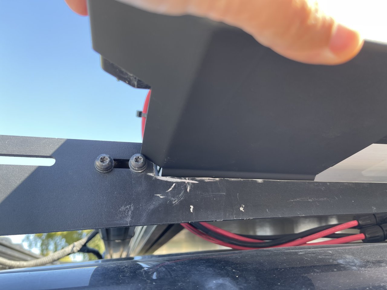

    Anyone who was excited to waiting for the drain pieces.m and is also still running a prinsu rack (2nd gens). The drain pieces will not fit out of the box. You will need to trim more if running a modified prinsu rack. it sticks out a lot more and eats up the space between the rack and X1. Bummed to say the least.
