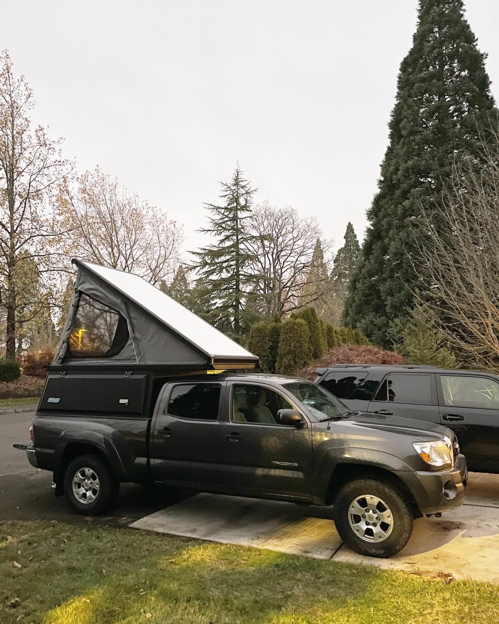

    Just picked up my camper last Tuesday! Really excited! Although, seeing some of the complaints with the 2nd gens I’m now kind of worried I might have bought into a bunch of problems. I guess I’ll just have to hope the version 3 mounts solve the issue.

    @BobWithOneO Hey Bob, I have had my X1 for over a year with many miles and trips on it, on FS roads, 4x4 roads, 4/40 roads, etc.. I haven't had any big issues that I didn't cause myself. There's a little dust and water intrusion, like after yesterdays rainfall and I need to seal up some spots in the front R & L of where the X1 sits on the bed rail. There was some leakage through the door locks and I took those off and sealed them with silicon and they are dry now. The shell clamps for the 2nd Gen are not the greatest and SP has a fix for this. I have 3 of the old ones on each side, but I also installed these up front on each side to just hold it in place better. I also installed up front a stop that slips up under the lip of the X1 and it stops the forward movement.

    @Taco-Surfer Did you install that front piece after the camper was installed? Were you able to get it in there without lifting the shell? I don’t aggressively wheel my truck but I do go down some pretty rough roads and would like it to be as secure as possible.

    I wouldnt worry or put too much thought into it. Its not across the board for 2nd gens.. just depends on usage. If you can get a support underneath the front lip, it will definitely help. I made my front support bar prior to install (I knew I would need it based on my driving habits and use of the truck) and have yet to have any shifting issues. I see some movement at the clamps (where they have scratched the PC off the X1 lip), but we're talking maybe 1/8" of most total.. and that's with beating it down washes, dunes, rough trails, etc. I get more issues with my gear inside the camper than anything. My thin, upright, 13g water tank slaps the X1 molle panels/front lip when really getting after it in washes and stuff. The camper itself is solid and hasnt moved or made contact with my Prinsu rack etc. I thought the slapping sound was the overhang hitting my Prinsu rack when I was bombing washes.. but its the tank. Just has a little play/leverage and gets to moving/slapping when the bucking really kicks in. lol

    Ok, that makes me feel better. I was really starting to worry. I think I’ll mark where it’s sitting right now and keep checking it periodically. Hopefully the V3 mounts will help. They certainly look better than the pictures of the original clamps.
