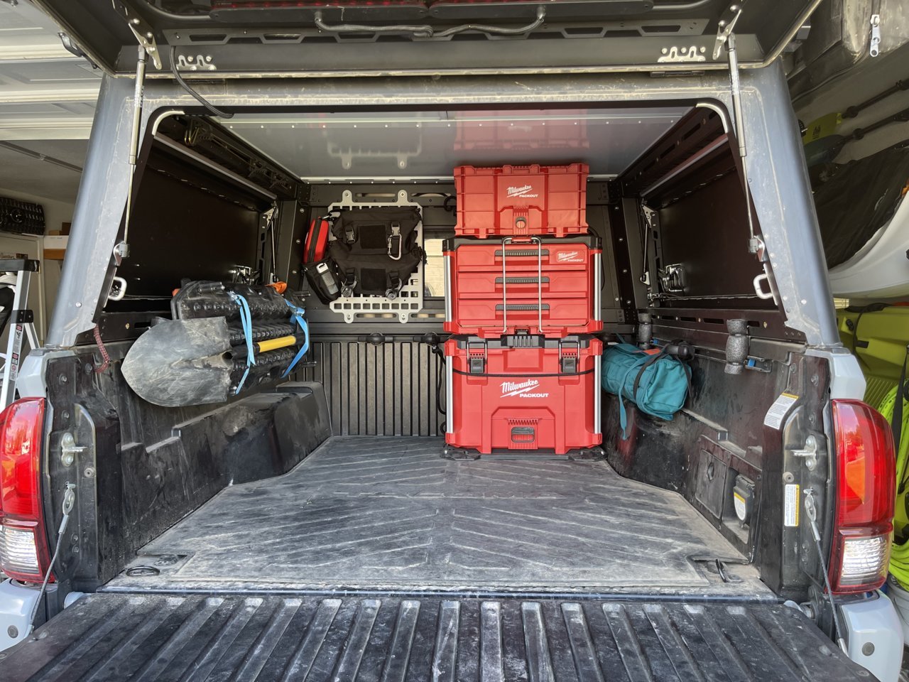

    I’ve been using portables but have come across a few issues.
    - A major one currently is that with how cold it is I can’t charge them safely without risking damage to the battery cells when it’s below freezing. Most portable power stations don’t have a low temp cut off.

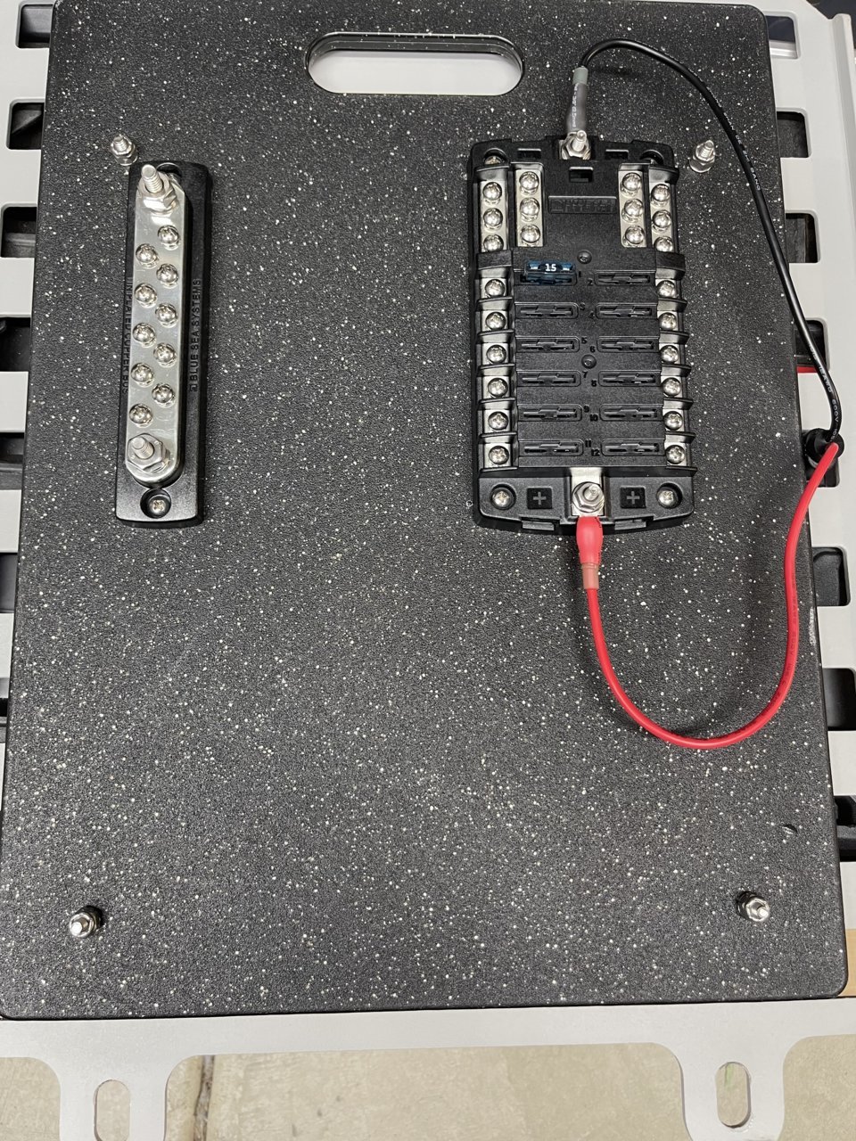

    - I power Multiple things in the camper that require a 12v socket. Most portable power stations only have one socket. I now use a bluesea 12v fuse panel to distribute power to multiple items powered by the one 12v socket.
    - The 12v socket on my portable don’t really hold a great connection. It’s very easy for it to be disconnected.
    I’m now working on set up with a dedicated 100ah lifepo4 battery with Redarc bcdc charger that will live in my truck and hopefully I won’t have to think about charging it, the temperature (low temp cut off by Redarc) etc.

    currently my portable battery lives in the top Milwaukee crate and plugs into the fuse panel hidden behind the molle panel

    Really clean and great-looking solution!
