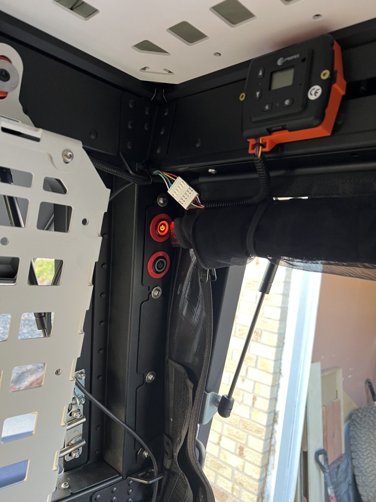

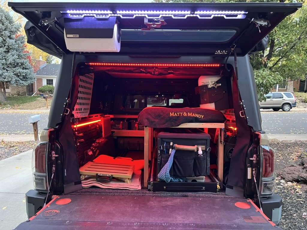

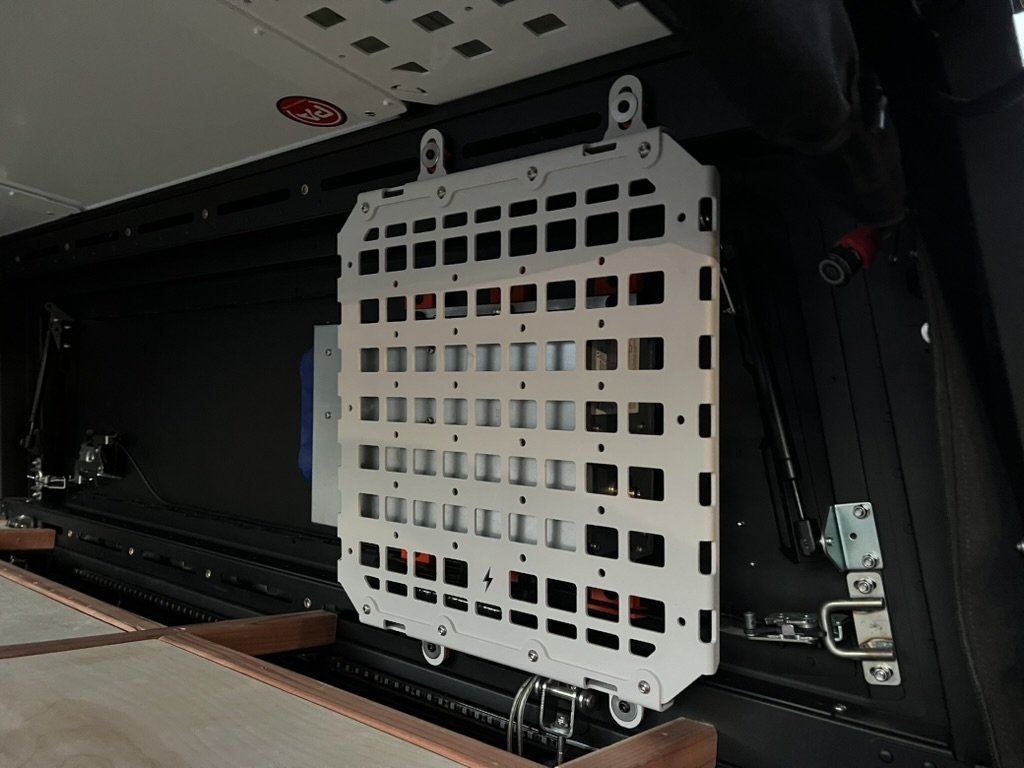

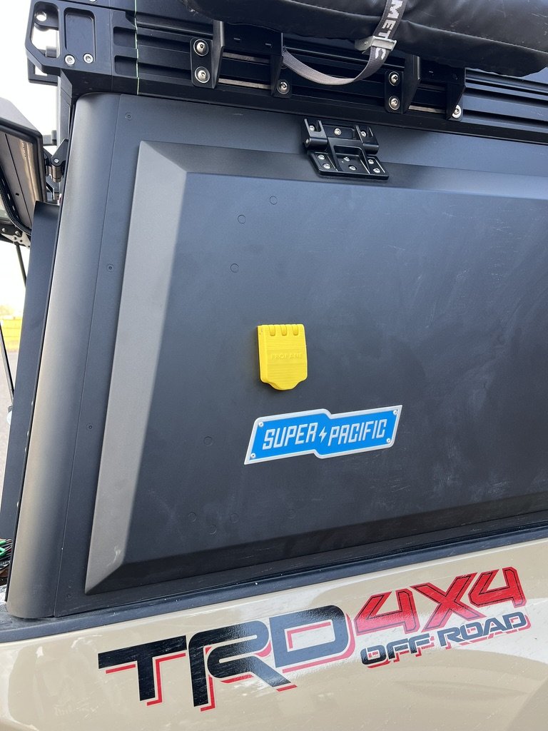

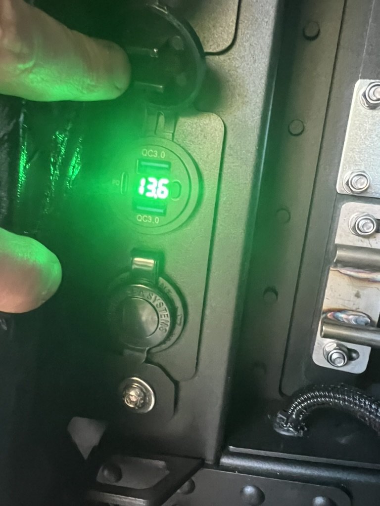

    I made some pole mounts for the awning poles. Greyman panel for the X1 door. USB in the rear pillar for powering the USB lights on the FSR awning.

    Is it USB-A on the V2 FSR awning? I got one of the V1’s about 3 months before the V2 came out and I’m thinking of upgrading.

    Yeah, USB-A Y cable to 2 barrel connectors that go into the awning bars. I wish they had put a 3rd LED strip on the 3rd arm in the middle.

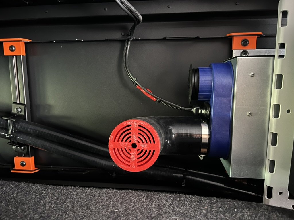

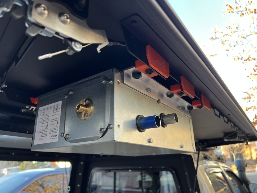

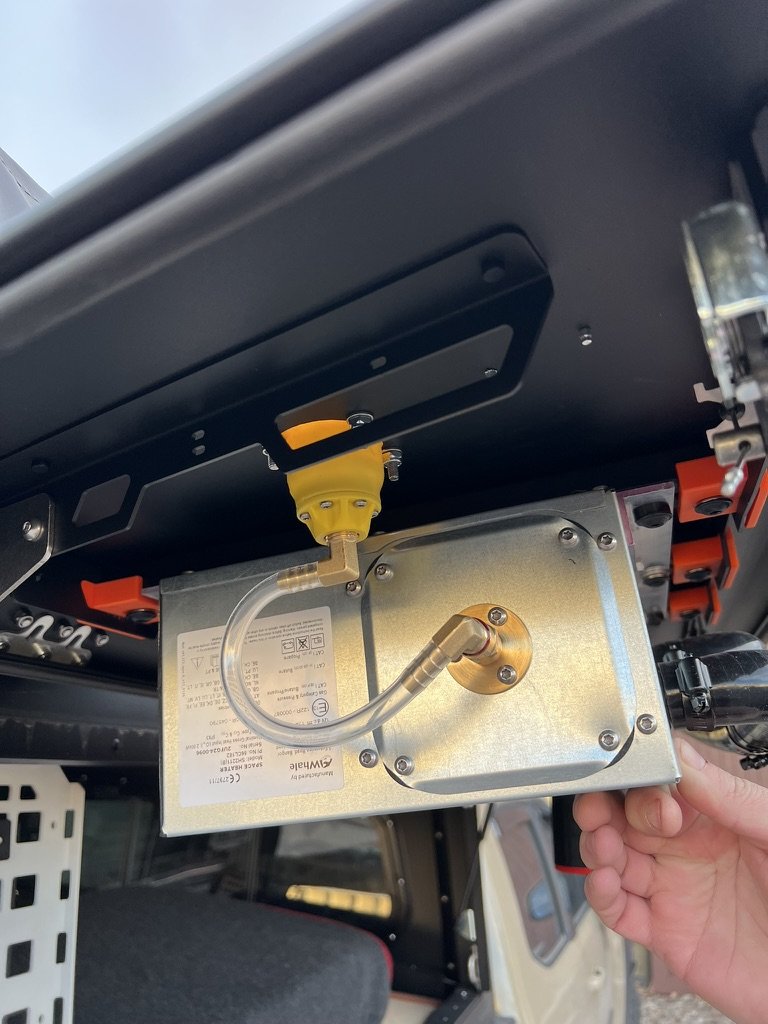

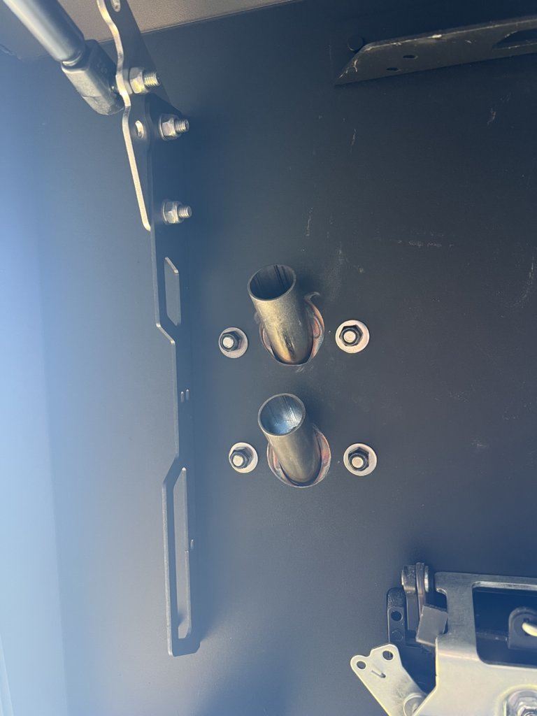

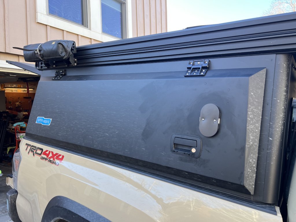

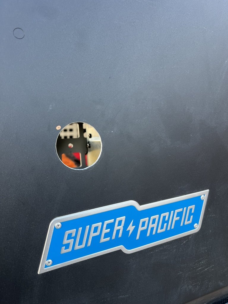

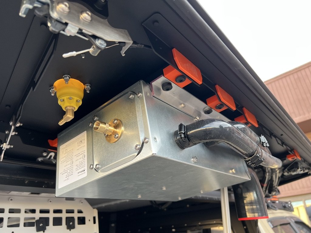

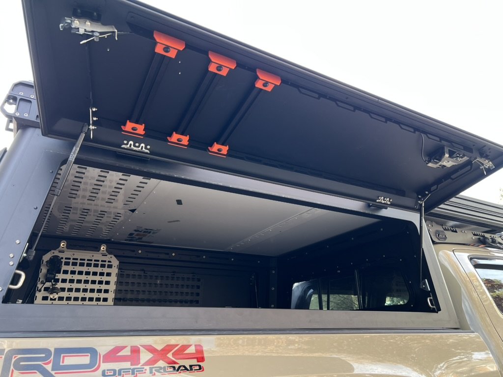

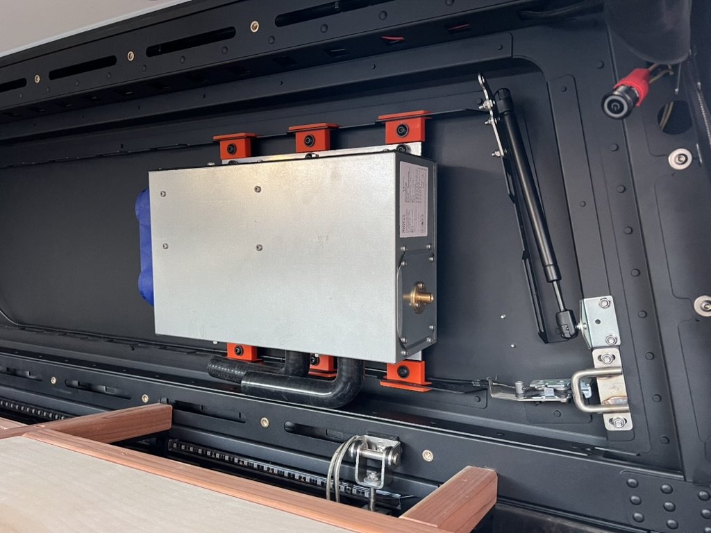

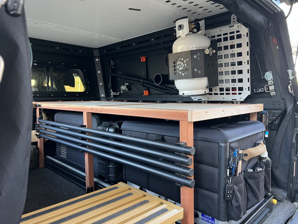

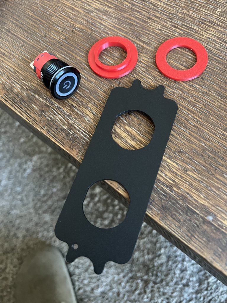

    I made a custom mount for a ProPex HS2211 propane heater to mount to my rear right door. Similar to the Truma install, but man Truma is a pain to work with. They won't sell you a unit and they won't let anyone else install the VarioHeat unit. So I did the same thing but with a better heater (tuned for elevation) for half the price. If you're in the Fort Collins, CO area, go get a heater from Van Cafe. They are gonna help me install their quick connect propane bulkhead inlet they're making for their propex suitcase: https://vancafe.com/propex-ps2000-portable-heater-system/. I'm planning on venting with the marine hull-through propex vent: https://vancafe.com/propex-26mm-marine-thru-hull-fitting-for-hs2800/
    I just installed the Safe-T-Alert Co2/LP detector https://youtube.com/shorts/-wg-qcdDBGQ?feature=share
    The 11lb propane tank goes on the molle panel. Its there for cooking as well. When we use the heater we'll put the tank outside. The molle acts as a nice screen to keep the heater space more guarded.

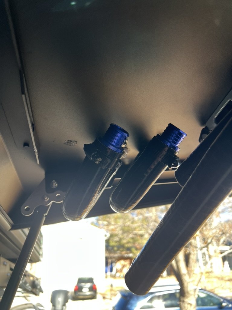

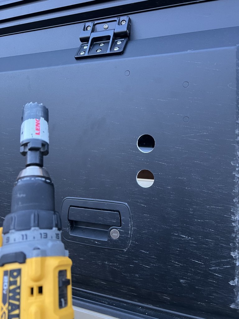

    Made some more progress. All that is missing are some silicone gooseneck hose elbows and couplers to finish installing the air intake and exhaust lines to the vent. And the propane inlet and hardline to the unit. I have an appointment with Van Cafe this Friday to finish those last two items. I'll post when its all done and will show a video of it running. Van Cafe said they'd want to film and post the install, too.

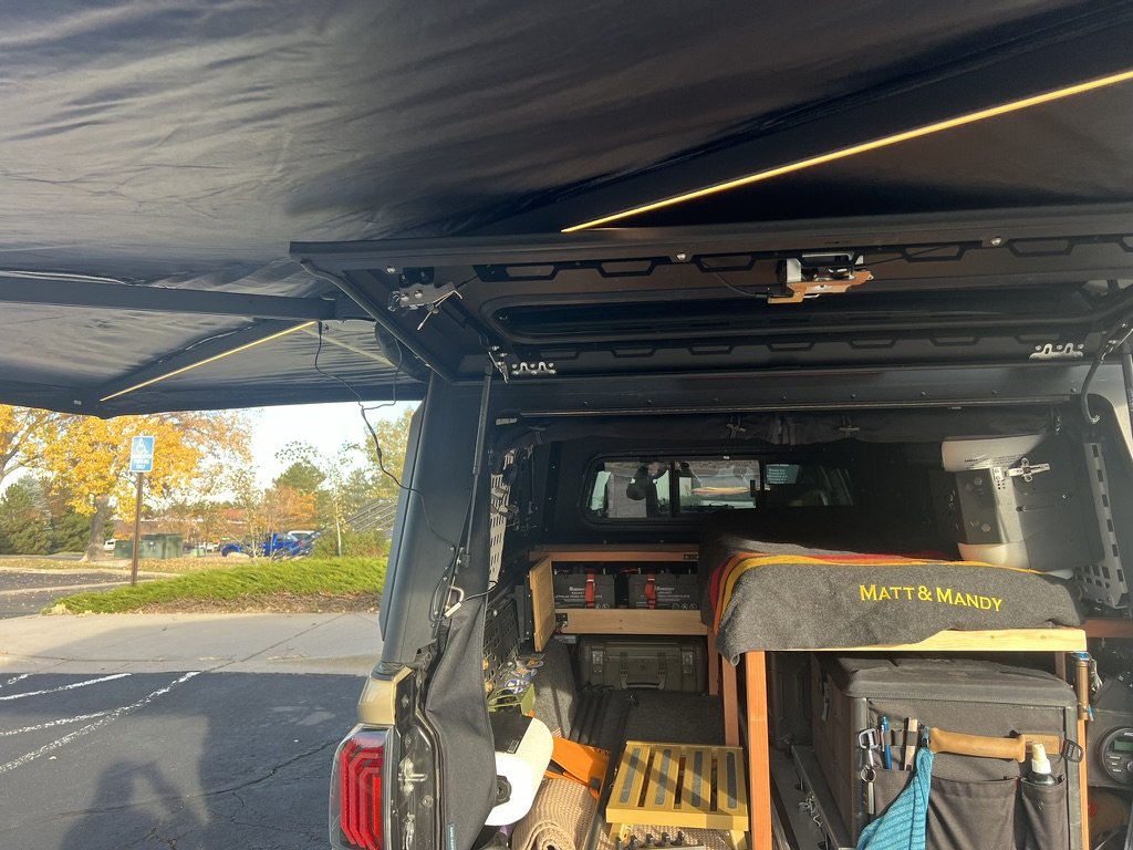

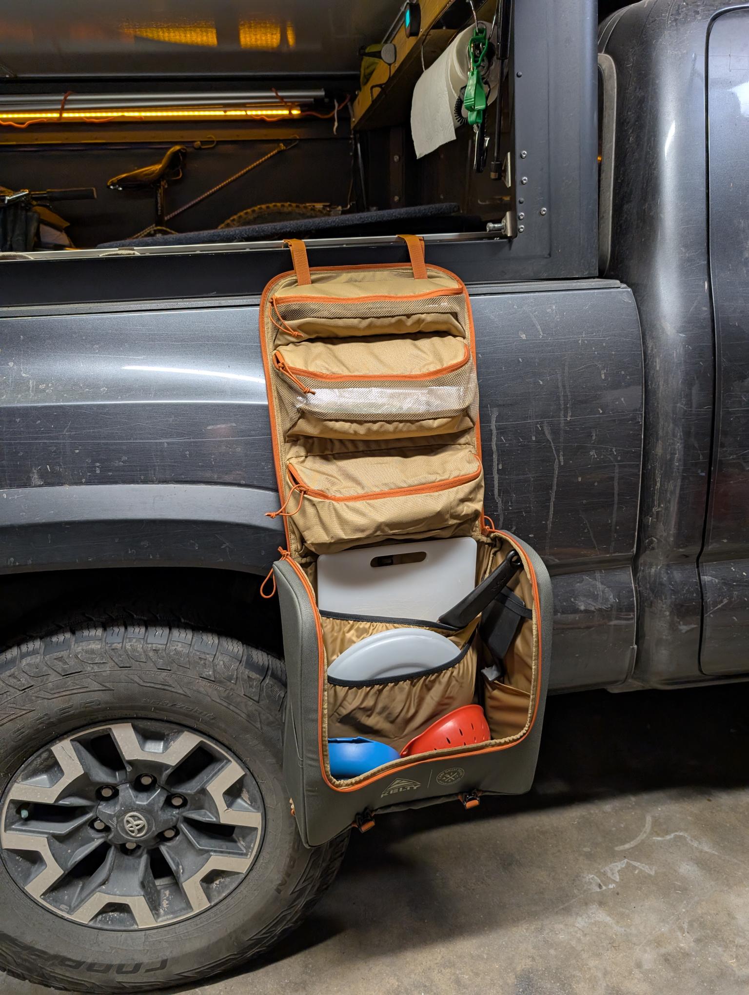

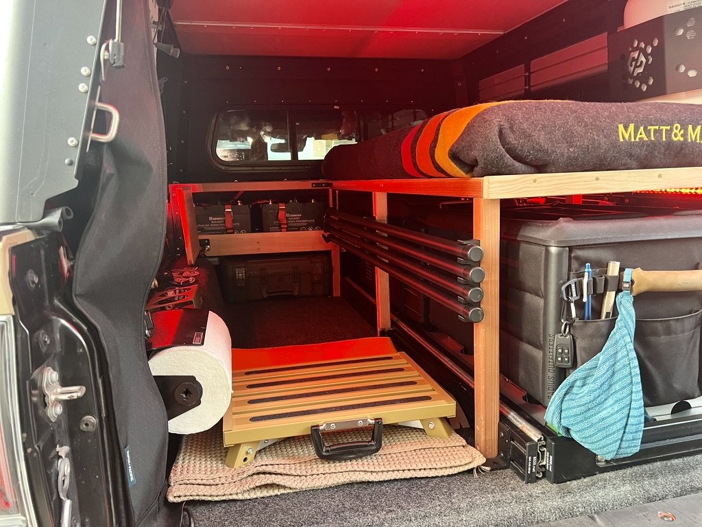

    Upgraded my kitchen setup recently with the Kelty camp kitchen deluxe bag. Previously all this stuff was in the cabinet in the bed. Now I just pull the bag out and hang it off the side of the truck. Definitely easier than trying to reach over the side all the time.

    I was thinking of getting one of those, but ended up ordering some .08" thick corrugated plastic last night so I can DIY some dividers for the small Husky box I keep all my kitchen gear in.

    I had been using a USPS fixed-rate box that fit the cutting board, plates and frying pan perfectly and tucked in between another box and the edge of my cabinet. Bowl and strainer plus some other items went in the other cardboard box that also held food. Utensils went in an organizer that hangs off the rail of my cabinet. That setup worked well for a few years but I was getting sick of having to reach in and grab stuff, especially when the back passenger wheel is up on a rock to level the truck.

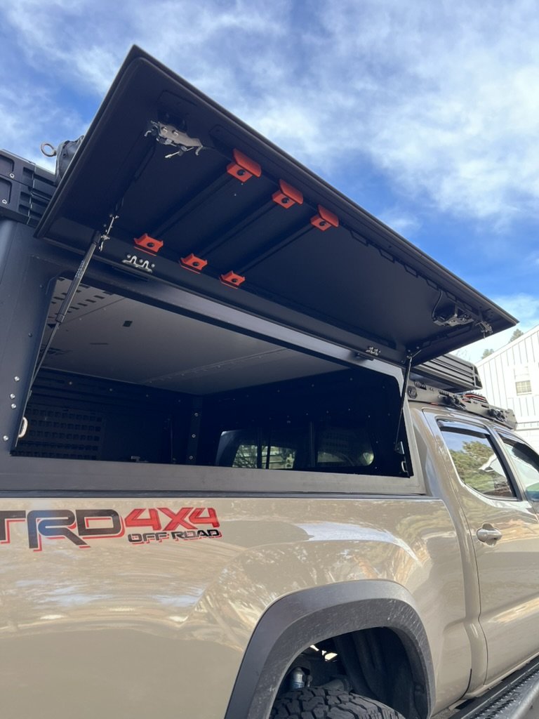

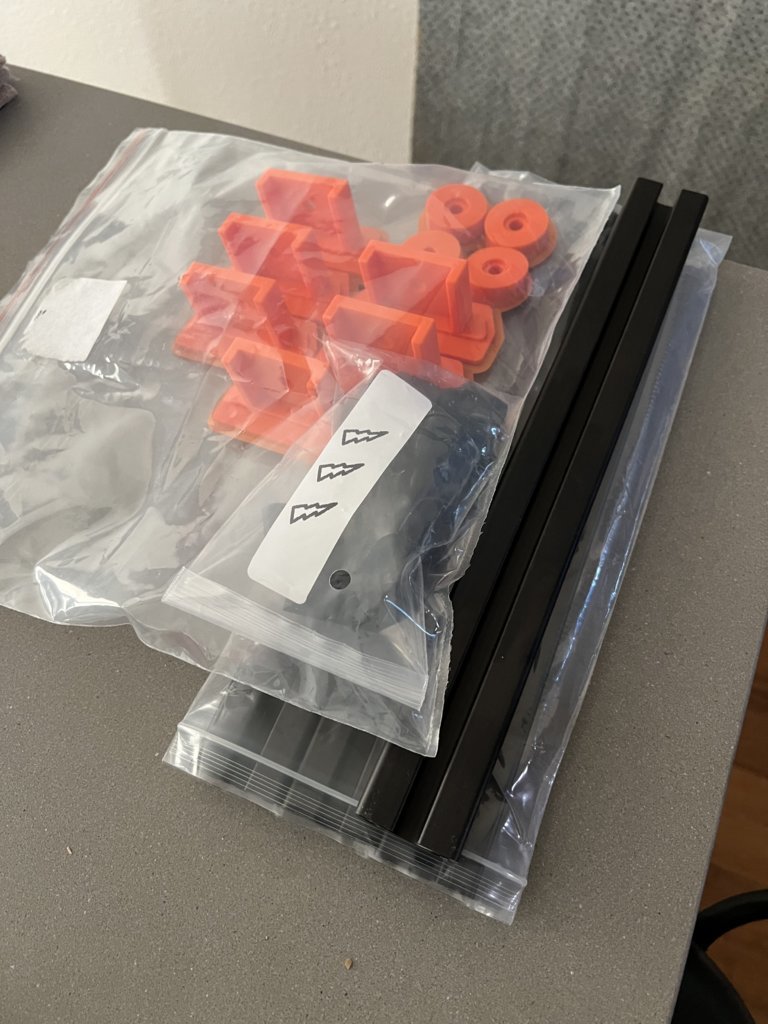

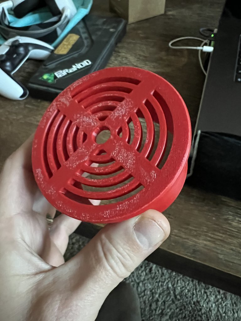

    I finished the heater install today with some help from Van Cafe in Fort Collins, CO - they sold me their first prototype 3D print of a quick connect propane bulkhead. She toasty.
    https://youtube.com/shorts/uJGh6rJwVxM?feature=share

    I’d like to see SP use this on their Truma solution.

    Looks awesome. Just curious end goal of this. Just to catalog progress and build or eventually sell kits

    I have most everything for a second full kit, just need to make a set of replacement flange brackets from the leftover L channel aluminum. DM me if you're interested. I got the hoses, hose elbows, hose connectors, and hose clamps all on Amazon. What I don't have is another of the quick disconnect propane bulkheads that Van Cafe made. They said they're planning to sell them however. I bet you could get one if you call or email them.
