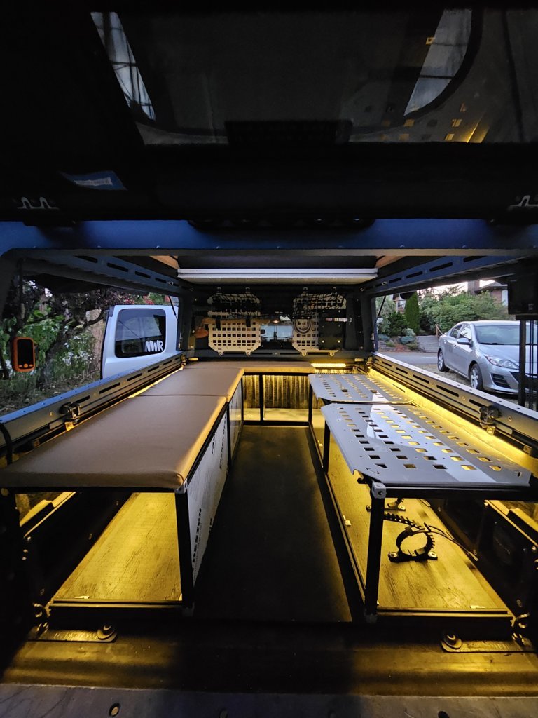

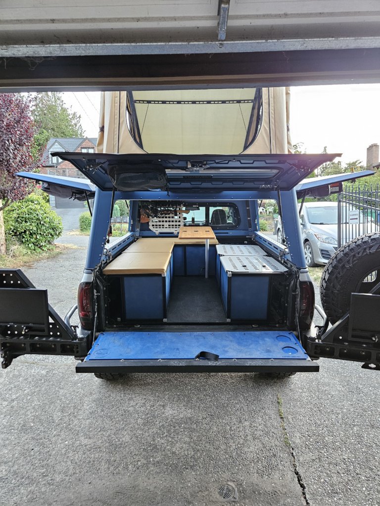

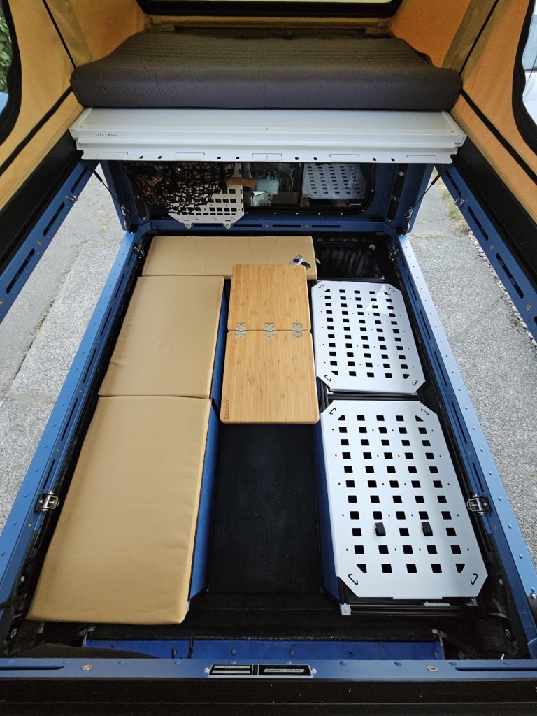

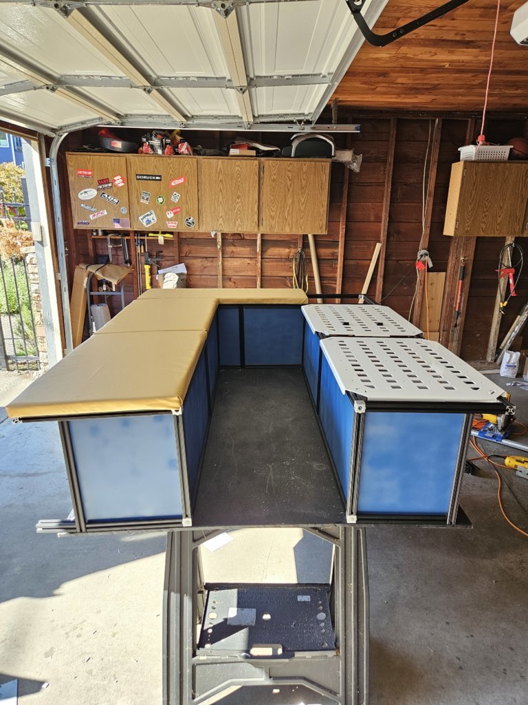

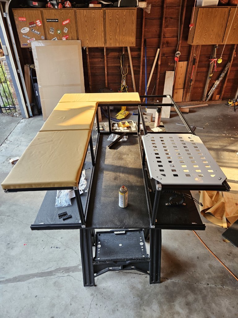

    Been a while since I posted a build update here. I ended up going with a 1" 8020 build with ACM panels and flip tops instead of drawers.
    I also want to say that this is my first time every building anything like this. I took my inspiration from Johnny Taco's build video, but bought all of the extrusion locally and cut it all myself, figured out how to put it all together along the way.
    Before flip tops went in on the driver side. I did a shit job at recording the process of blueprinting, measuring, cutting and putting all this stuff together, but i'll share what I got.
    I used a 1/2" sheet of treated plywood for the base coated in a later of spray on Raptor bed liner and just bolted everything to it.
    I installed these @mattgecko LEDs back in 2020 as bed lighting. The strips held up well exposed to the elements for 4 years. Now they serve as awesome cargo lighting. Also, as you can see, I left the passenger side with open tops so that I can utilize the passthrough panels as benchtops when not in use. Its been great!
    When I picked up my SP, I asked for a can of touch up paint to paint all of these ACM panels and a scrap of the tent material to upholster the fliptops in. I just bought some high density 1" foam from Amazon and stapled/glued the tent material on over it. The fliptops are 3/8" plywood bases with simple cabinet hinges.
    I incorporated a Lagun table, bolting the leg to the front center ACM panel. I found this foldable tabletop on my local FB Marketplace. Paid $100 for it and the base that connects to the leg. CA Vans charges $300 for it which is just stupid. But at $100 and it stowing away small, i'm happy with it.
    A view from the top looking down.
    Fast forward a few weeks and this is the final product. I bought @A_Baum92881's lighting kit and mounted a few things on the molle panels and gone on a few trips.
    My layout for storage is:
    kitchen stuff, stove, dishes, etc.. rear driver fliptop.
    Extra camp chair, devos 2000 light, popup pit, folding table, lagun table top and shittco tent poles.. mid/front driver side
    Cabside driver's corner is my battery system. I originally had an Inergy Flex 1500 with 2000wh, but just recently upgraded to the Bluetti AC200L with 2000wh and their Charger 1 alternator charger.
    Cabside middle has a panel with a 12 fuse BlueSea block and an AuxBeam fusebox installed onto it along with extra warm stuff storage.
    Cabside passenger is water storage, 2 Dometic GO 3Gal containers
    Big bag of tools/ropes/straps/general revovery gear.. front middle passenger
    And a 1.5 ton Pro Eagle strapped to the 1/2" plywood using big ass quickfist straps, alao throw a step stool, jumper cables and a krazy beaver shovel in there.. rear passenger storage.
    The plywood base is floating, not attached to the bed. I've got at least 300lbs of gear weighing it down and it's a snug fit as is. I have gotten about 25 nights in the build so far and I definitely feel dialed in with it.

    Looks awesome! If I can recommend, since I had a large solar generator take a shit on a trip I'm using 2 750watt hour for the heater & fridge & a 250 for lights & charging phones etc. If your big one fails there is no backup

    I appreciate the tip. I might make a spot for my Jackery 500 for longer trips to use as a back up if need be!

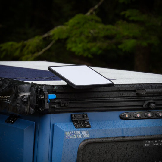

    A couple of notes on Starlink Mini.
    If you want internet anywhere with a dish that fits in a Super Pacific sidekick door bag perfectly, buy one.
    If you need a slick mount for when you get there, hit up KeeganBuilds on Etsy for one of these 3D printed mounts made specifically for our SPs.
    If you don't want to run your dish on your dash in your cab while driving, or hard mount in on top of the tent, exposed to the elements, toss is up in the Super Pacific bed area and close the tent down.
    With the pole mount installed on the Starlink and mattress, sheet and blanket underneath it, the tent closes with no issue. The Starlink beam shoots straight through the roof of our shell and I am getting 100+mpbs in the cab of the truck.
