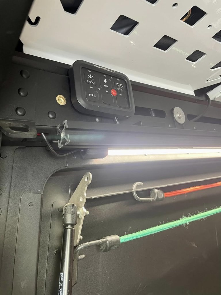

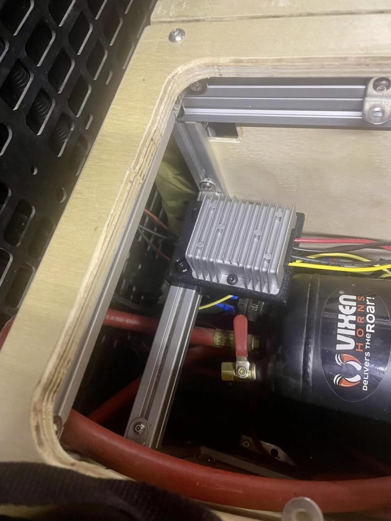

    Finally got around to hard wiring my Starlink Mini to my AuxBeam controller (the “GPS” position on the controller) so I can leave the Jackery at home. I put a voltage booster in line to accommodate for the voltage loss due to the length of the power cable.
    Works like a charm to keep the Netflix going for my better half and the YouTube going for my boy!

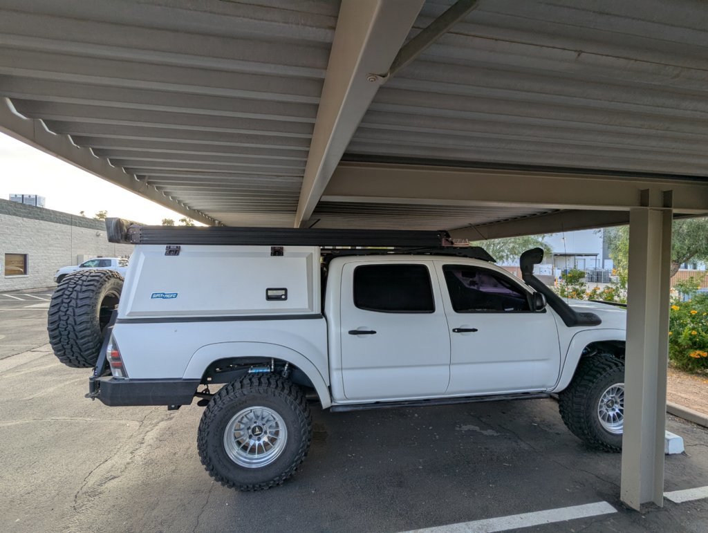

    I was pleasantly surprised to find out mine fits under the covered parking at the new shop.

    Stupid build as small as possible garages here, smh, ha. Ground to top of tent is 83 and some odd inches. Which technically should have fit. Dumb stucco and trim and weather stripping, haha. It was worth a shot.
