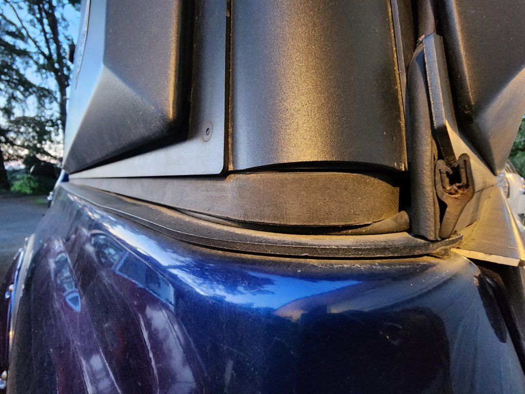

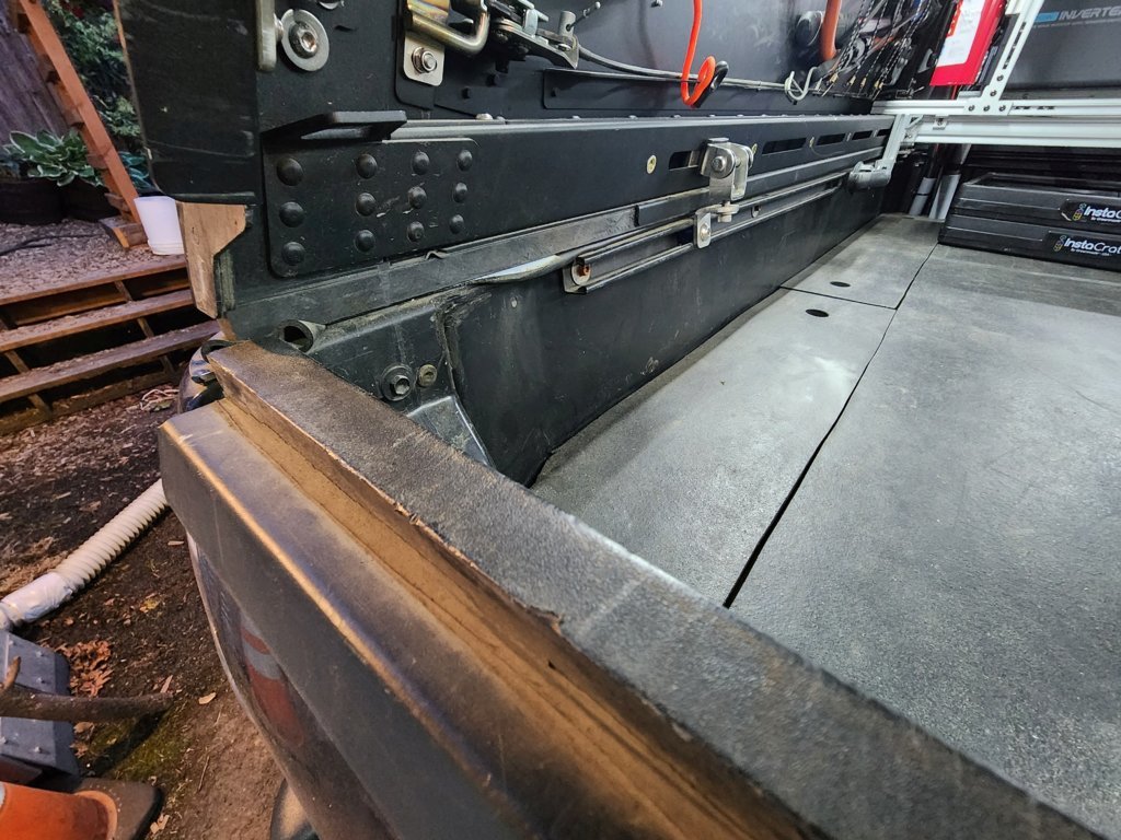

    yea i am, they have a spacer to mount in between the camper and the rails, then another spacer between the tailgate and the door. It works pretty ok, the tricky part is finagling some of the gaps on the rear door
    i ended up taking my tailgate cover off and glueing and screwing the tailgate spacer from the inside, the black sikaflex 221 along the mated surfaces
    its held up really well. Its heavy duty stuff. My last load from home depot i had x4 6x6 8' pressure treated landscape timbers on it. Thats not a one-off thing either
    but with that said, you'll need to do some fine-tuning on it, unless they've come up with a different solution since

    How thick is that spacer, @tacomavan? It looks pretty substantial.

    about 18 mm

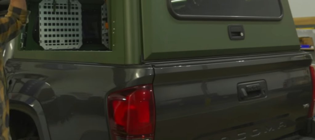

    Modifications are required to allow the GFC's rear door to close with the KBVoodoo caps, so I figure it would be best to check if that was the same case here. I think it's because the tailgate cap sticks out further than the OEM plastic cap?
    Interesting. I guess I can understand the spacer on the tailgate (although you'd think a different bulb seal would do the trick), but why's the spacer on the bedsides necessary? Was the overhang too close to the cab, or maybe not enough room to torque down the bedrail clamps? The camper on a 3rd gen with OEM bedside/tailgate caps (which are roughly similar to what a 2nd gen looks like with the KBV caps) doesn't appear to have any need for spacers.

    After looking more at the pics, maybe its due to the bed rails? Are they higher up inside the bed on the 2nd gens? I have seen some 2G's cut their roof racks to make room but I thought the 3G's were supposed to be fine?

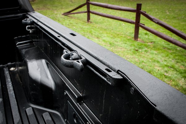

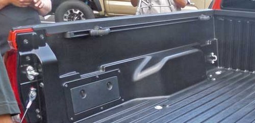

    Yep. That looks like that's the issue. Definitely will be asking them more questions, because I don't want any spacers in there.
    2nd Gen w/KBV Caps
    3rd Gen w/OEM Caps
    edit: Based on this, though, it doesn't look like there's any spacer required for a second gen with OEM caps?

    They emailed me back: "You will need to put the OEM caps back on. The lower profile of the KBVoodoo caps will cause the camper to rest on the flange that is designed to sit inside of the bed, instead of on the caps."
    Figure I was going to have to pull the caps regardless for waterproofing, so no biggie. Somebody will buy the caps, I'm sure.

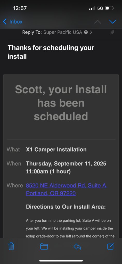

    Anyone have a time machine so I don’t have to wait? Also does anyone want to make the 35 hour drive there for me? Lol

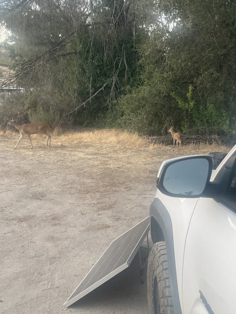

    really like the quick release solar
